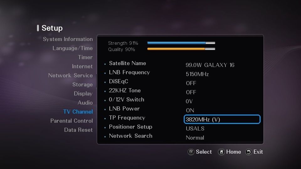

thanks. just trying to figure out why I've lost this transponder figured I'd confirm before I try swapping out the lnb.
I've blindscanned it previously with a SR at ~26k although I do realize lyngsat has it at 30k. I've tried manually entering the trandonder and still but somehow I've lost that transponder which is somewhat vexing. As I'm getting good signal from all of the other transponders, I'm about out of ideas so I'll try a swapping out lnb.
Since you can't blind scan it, gotta be either the lnb or the dish needs a bit of peaking. My Openbox will not lock more than +-250 from SR 30000. maybe the Az is more lenient.
I'm hoping its the lnb, not sure I can peak anymore than this:
same issues here in MN ;)
the "normal" TP's
3820, 3847, 4000, 4080 all lock real good (75 to 82) but this 3740 just dropped off the earth a week or so ago
