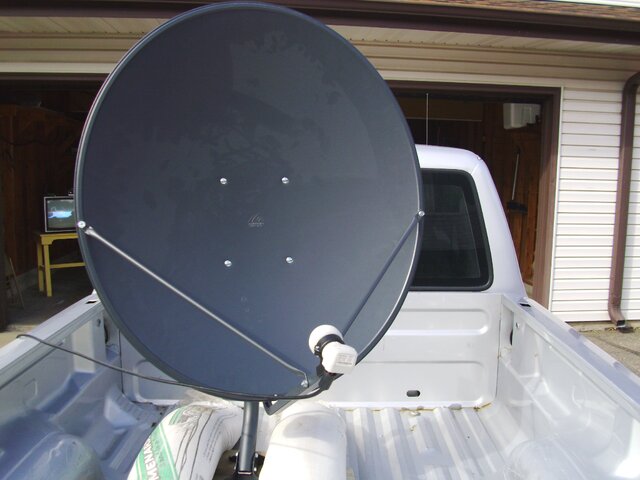

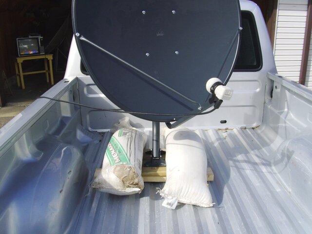

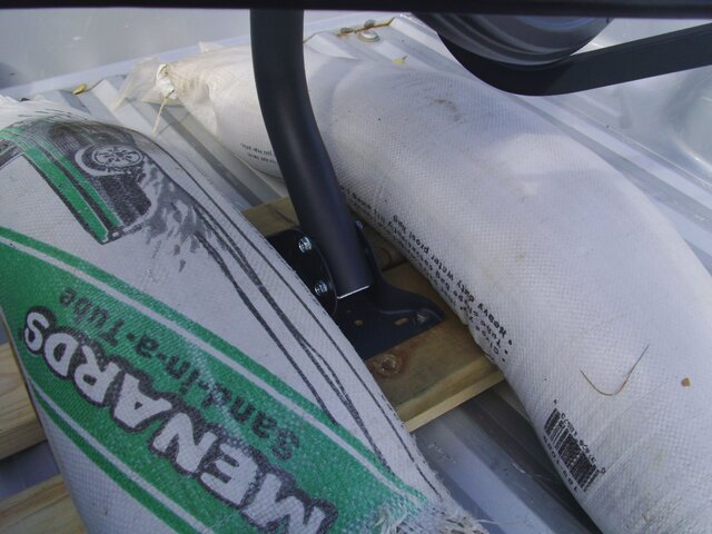

I think I lost track on what size dish we are talking about but, here is an older post of mine.

Mine has been pointed to the same sat for about four months now without any loss of aim or signal.
So if I decide I like the programming on the sat, I will plant a permanent dish, then re-aim to another candidate.
