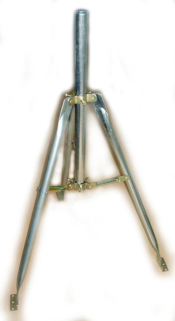

I have a 90 cm on a stab hh90 mount on a tripod that no matter how hard I try I can't plumb the mast that is in the tripod so I am considering a roof mount on an old direct tv dish j pole that already in place

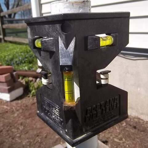

Get 3 cheap magnetic levels and stick them to the tripod 120 degrees apart. Level the tripod! (Definitely keep it on the ground.)
Tip: Grab the best large 'professional' level the store has. Compare the cheap levels to the 'professional' level and buy the 3 most accurate cheap levels.

The motor elevation is adjusted to compensate for the pole being out of plumb. Warning: this only applies if the pole is out of plumb EXACTLY in the North/South axis. It will not correct for any East/West leaning.
As in any motorized dish install, a perfectly plumb mast is the key to successfully tracking the arc. Attempting a motorized install on anything but a plumb mast is a sure recipe for frustration and aggravation! :)

Tri-pods, at least the ones made to hold up TV antennas, are not really stable enough for larger FTA equipment.
