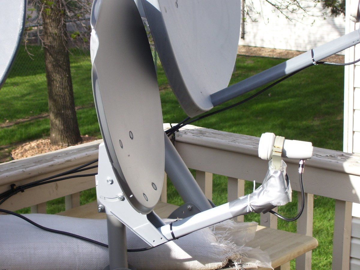

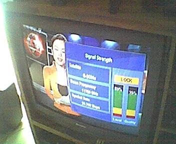

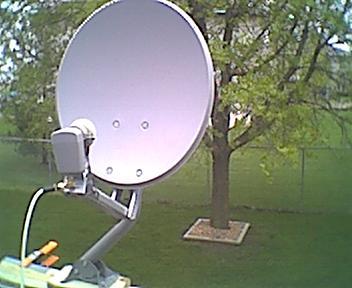

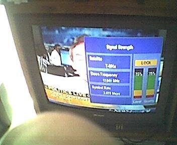

some have modified a KU LNB on a 18" dish and could get the uber strong things out there. Examples were AMC6, Ohio News on H2, Doc Scott when he was on G26, CCTV on G3

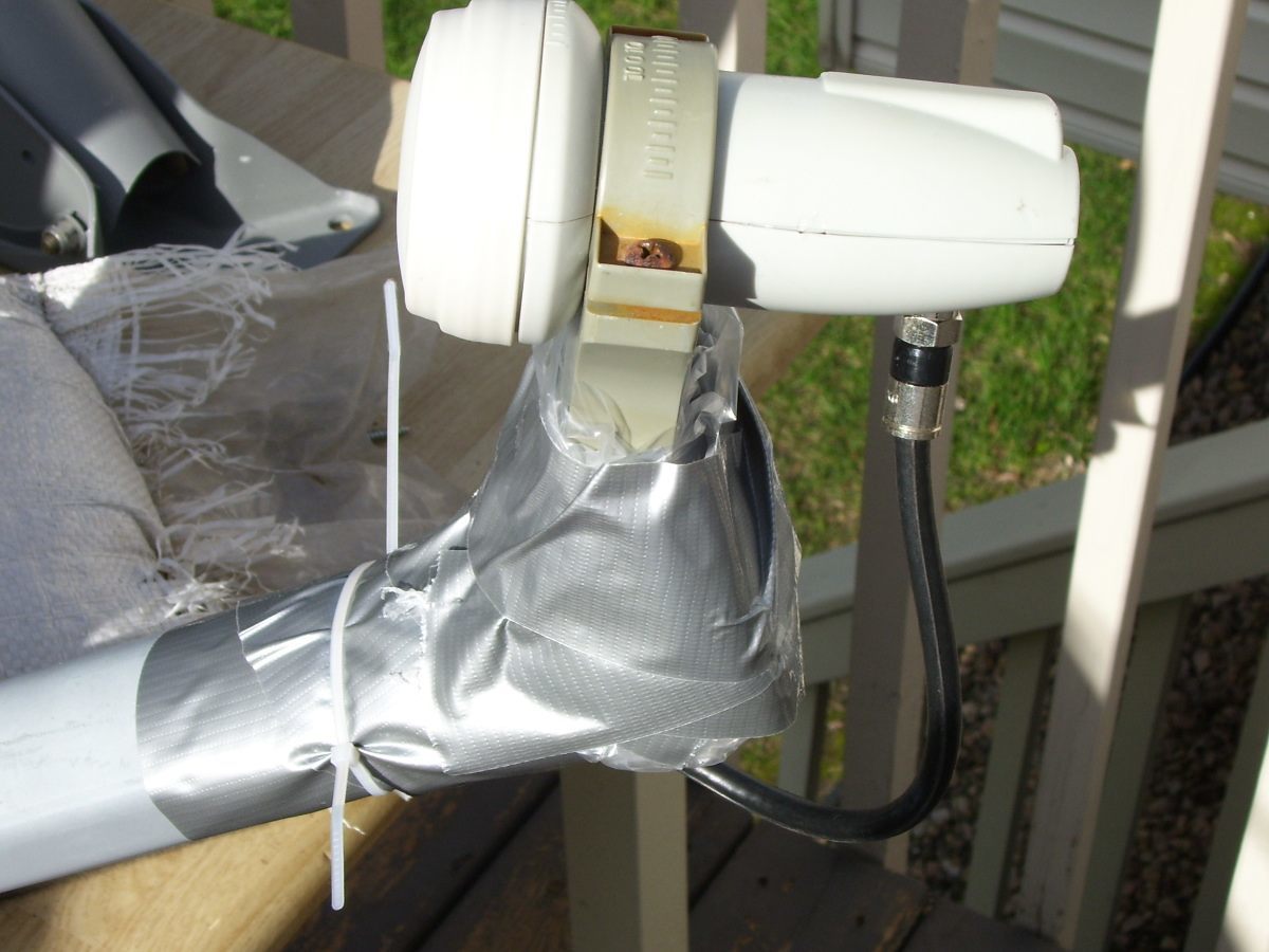

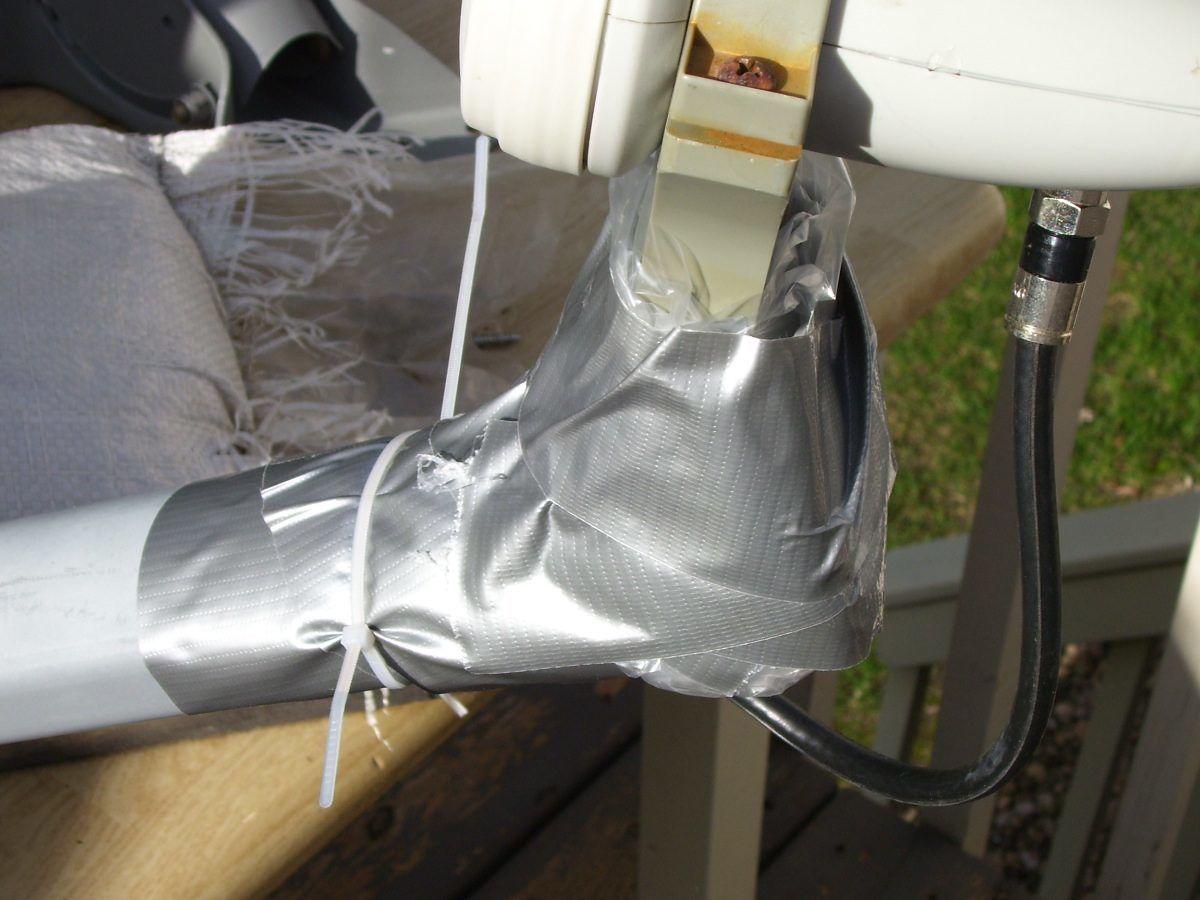

Here are some pics of what I did for AMC6 & G3

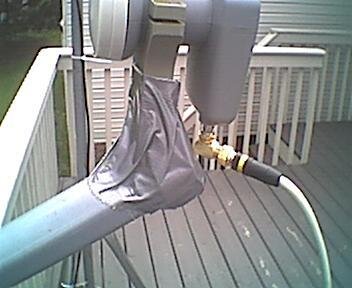

the LNB holder broke. Its an old KU LNB holder when Bell ExpressVu was KU back in the day so thats why the duct tape comes into play

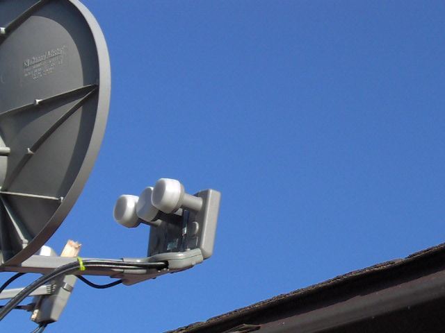

if its under it may be a hassle unless you want a specific (high powered) channel. I know folks who used an old DirecTv Phase II (key word is Phase II...these had the 3 removable LNB's and not the 3 LNB all in one setup) on 101 for 3 ABN (3 Angels) or at the time KUIL Fox Beaumont (hey, I was one of those folks) ;)

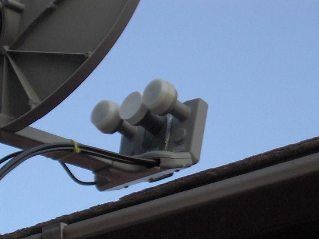

Its the one in the middle...the outside ones were for 110 (when I subbed to Dish) and 91 (when they had the audio channels free)
