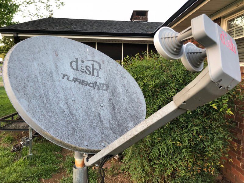

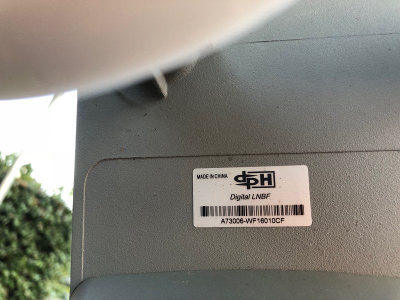

You should have a 1000.2 dish equipped with a hybrid LNB set or, if you havre a 42 switch, a DDP+ LNB....
IMG 1093
Don’t judge I know it’s nasty. But I have no idea what I have. Can you tell by these photos?
WOW! How does that 'tech' sleep at night?!? It's even missing a screw in the LNBF.
