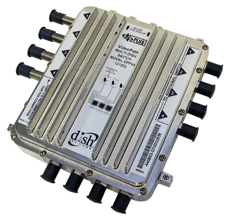

Will I also receive a Dish Network DPP-44 4X4 switch? I am only getting the VIP722 HD DVR receiver installed for now.
I will try to convince the installer to install this switch inside like I saw within another thread. This will also protect it from the weather.
the DPP 44 is an all weather device. If you prefer, it can be installed inside your home provided you have a minimum of four runs of coax into the house that terminate in a panel or central location.Of course these runs must then break out to feed the outlets in your home.
