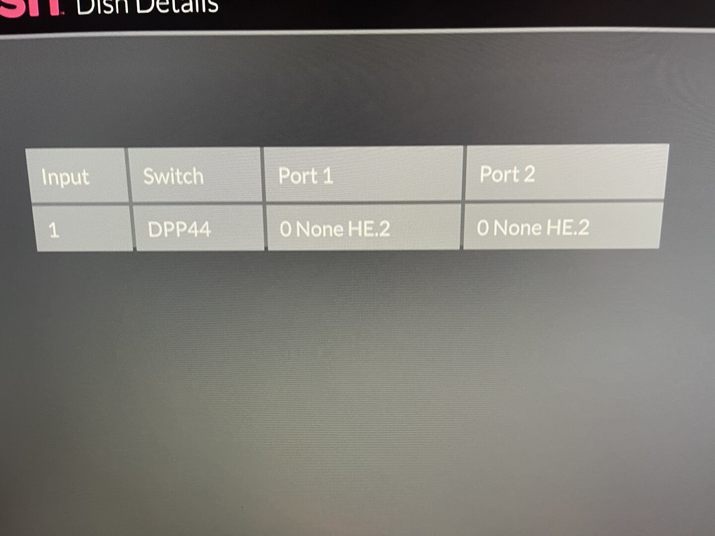

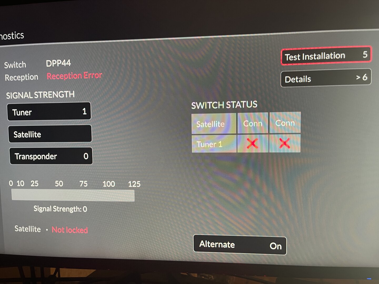

If I have the time (which I honestly may not, and my father is probably going to watch TV all day so don't want to piss the old man off because of my experiments), I can do this tomorrow afternoon. Reason being is that my DPH42 is currently installed with a DPP LNB, which is necessary for WA, but not for EA.
For now, ill hook up a DPP44 to a EA Hybrid LNB, just as a proof of concept because the DPP44 has the same "restrictions". Wont get reception either, just going to make sure the switch identifies the LNB. Brb in a few.
Here ya go, a EA Hybrid showing both of its LNB's (denoted as HE.2, if you check diagnostics>dish[3]>details[6] on your H3 you should see the same plus the satellite currently received). Now, this makes me 99% confident that it will work, since the LNB is communicating to the DPP44 just fine (via DP retro-compatibility). I would still wait until someone that actually has this setup with the DPH42 confirms it works, or that I get around to mounting my tripod. Receiver is a deactivated Wally if that matters.

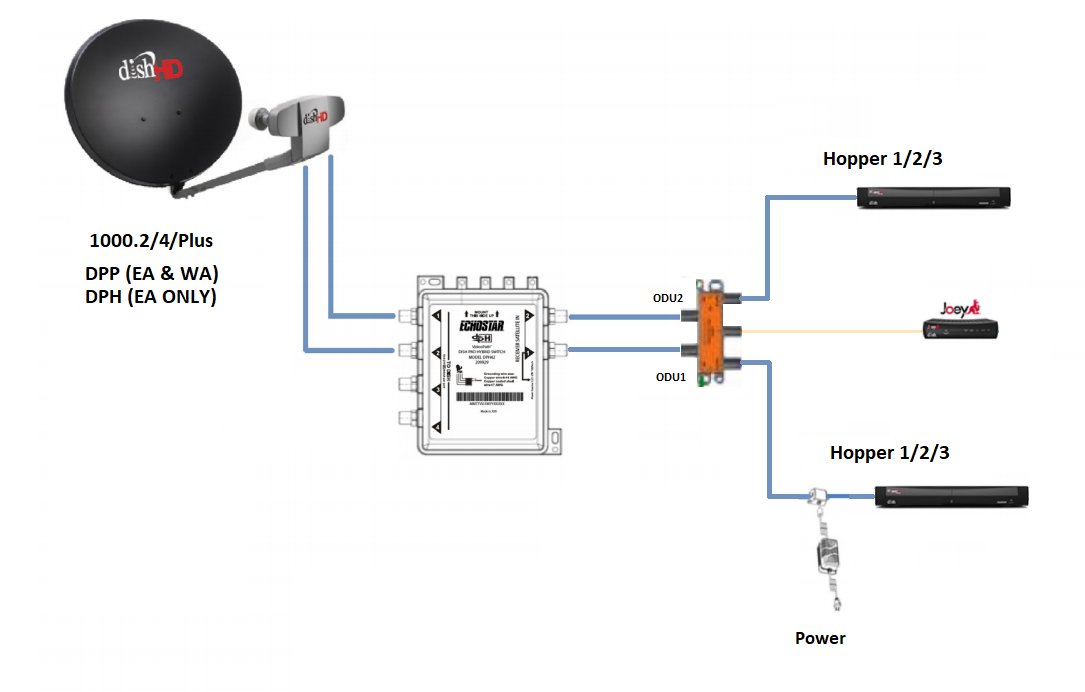

You're going to use a DPP 1000.2 LNB with the 42 Switch.
The two outputs in sequence to the Inputs on the Duo Hub. I know the image shows two Solo Hubs but a Duo Hub is the way to go

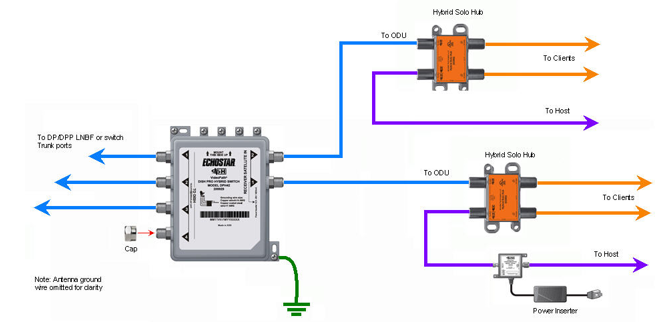

Bonus: Added a modified version of a diagram found in the DPH manual. Just for reference.
