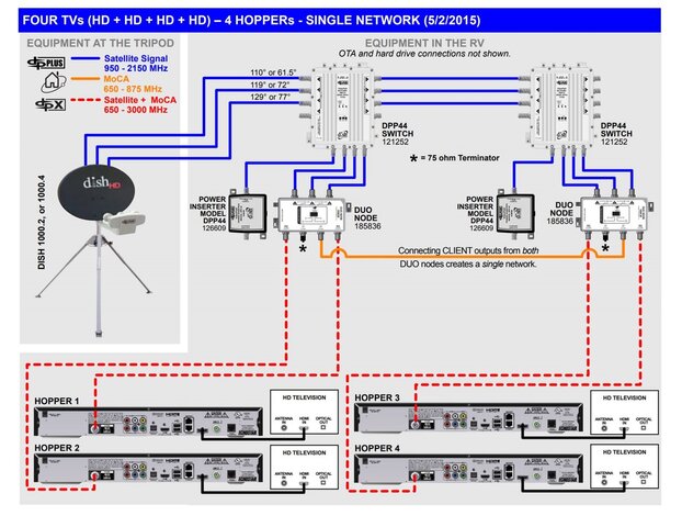

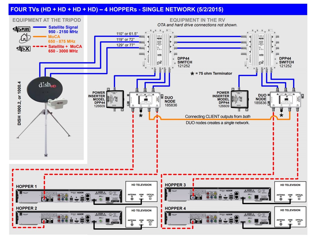

Here is the 4 Hopper setup attached. This should work for 4 H3's?
I don't believe so. That diagram applies to earlier Hoppers and not the H3. I think what you would need is either two dishes, or a single dish with all DishPro duals feeding two DPH42's each of which feed two H3's. So IMHO it's technically feasible, but I have no idea if Dish will do that on one account. They should see dollars before their eyes when they see you coming, and approve it immediately. ;)

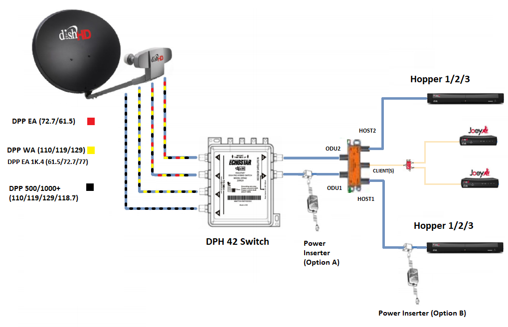

Something like this. You would use a DPH42 switch instead of a DPP44
(Had nothing to do, so I added a few colors to the chart, if anyone has any ideas of what else I could add let me know)
Well that statement is confusing! Your diagram already shows a DPH42. Plus that only gives him 2 H3's, not 4 as he wants.

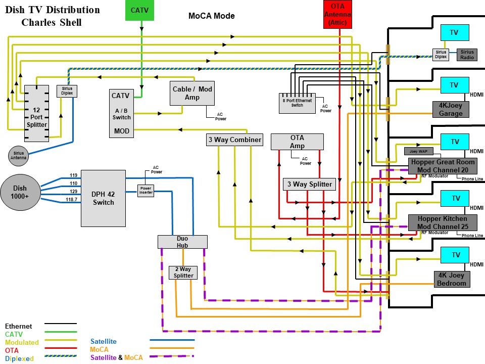

Here is a diagram of my 2 Hopper 3s, 2 4KJs. Also have 2 WJs.
Again, that only gives him 2 H3's. Am I in the wrong thread or something?
