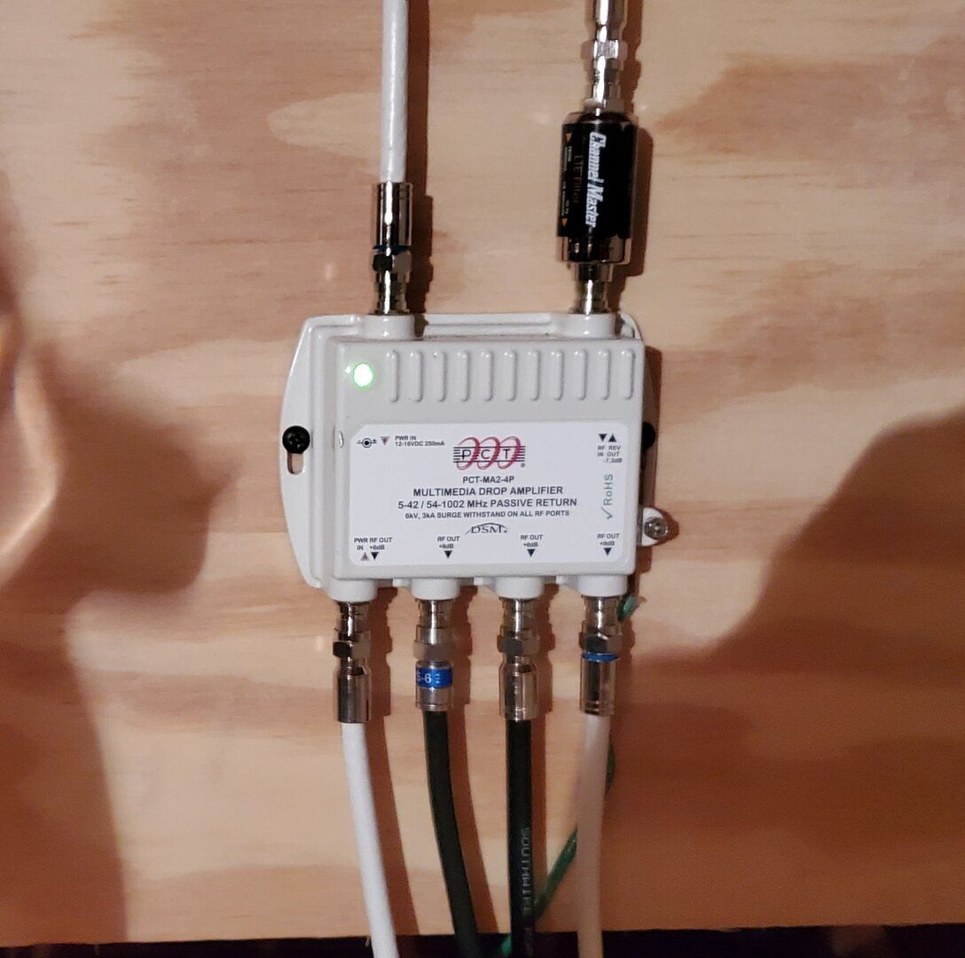

Last year after the repack, I had to add a LTE filter to my setup. Already had a FM filter in use, on input to my drop amp. Both from CM $19/ea shipped fast. Highly recommend both. Cleared up my interference problems.
Reactions: Lee60

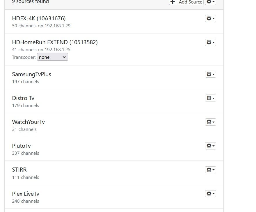

By the way, our ATSC 3.0 lighthouse (WBSF) lit up promptly at 10am on this past Tuesday. Pretty flawless, and I now have 4 ATSC 3.0 channels scanned into Channels. All working fine, using a Raspberry Pi 4b I bought from Comptech as the dedicated server. I have a WD Elements 4Tb USB 3.0 drive that contains the image, and all the shares needed.
I also now have 1,181 .m3u streaming channels running, and they ALL have epg data! They are all also recordable, and it all works flawlessly, even though I'm STILL trying to figure out all the capabilities of Channels Dvr software. It's amazing, that's for sure.
