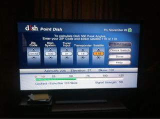

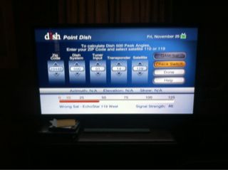

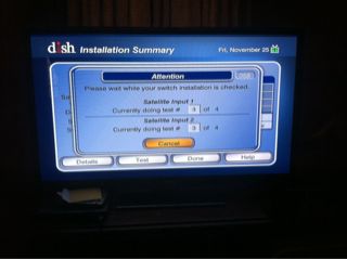

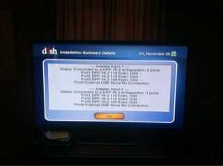

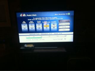

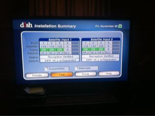

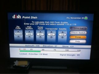

Ok, I ran the diagnostics and the check switch. These are the results
I assume by this that sat 110 and 119 I'm getting good signal from, but 129 not so much?
I think it is transponder 21 you want to check on 129. I could be mistaken. It's been a really long time since I needed to know that.
