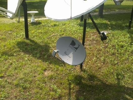

Have a Dtv Slimline on an old SG-2100 with what I believe to be a linear LNBF...anyways I hooked up a trusty old CS 6K and called for the dish to move to 72W and did a blind scan. The dish did move and is aimed in the general direction of 72W. I had this setup aligned to the arc at one time and don't think it has been moved any.
I think I am getting a couple of scrambled cable muxes (Spanish guide info) at 11800 & 11840 28888. I don't think those are on 72W, was wondering if anyone knew where I was aimed at?
Are those signals H or V on 67W?
Sorry but I didn't notice, got the freq & SR but forgot to get polarity, had to shut things down quickly when (another) thunderstorm rolled in.
I will try to note the polarity tonight if I get a chance to play again, and will post here if I get it, or maybe AC will beat me to it.
must be vertical. I loaded them as H (as I thought thats what the original post said) and got nothing

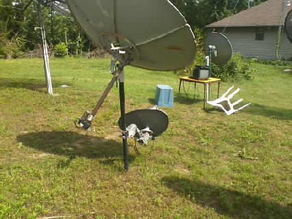

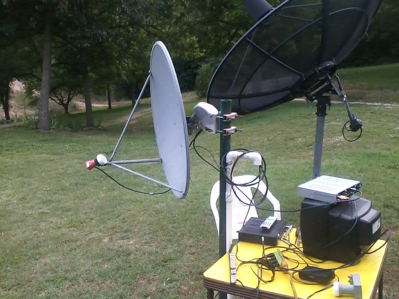

Finally got a chance to get back on this project.
After getting the Slimline/SG2100 combo to track the arc (verifying the motor worked) I took that combo down and pulled the dish off of that motor.
I then pulled my 90cm 3ABN dish off of the lightning-zapped DG-380, and pulled the 380 off of my pole. Installed the SG2100 on the pole and put the 3ABN dish on that motor, it fits perfectly, no mods required. In about 5 minutes I had this new combo tracking the arc from 72W-125W. Then I had the great idea (since I had cut some trees this winter) to try and get 30W from this pole location. I had never tried getting 30W from this pole, in fact I had never tried getting it with a motorized dish before, just temporary fixed dishes spotted around my yard.
Set my CS 6K to look for 11882 V 27500 (Cubavision) and proceeded to motor east from 72W via diseqc 1.2 (I use USALS for everything that is within range, but 30W is too far since I am at 93W).
Had no problem locating 30W but the motor would not go back west no matter what I tried after that. So...took it all down, popped the top off the motor and found some little chunks of rust stuck on the magnet wheel, cleaned them off, put some light oil on all moving parts, slapped it together and it worked.
Reinstalled everything on the pole, realigned and was tracking and peaked from 30W-125W in about 10 minutes. I then transferred it to the cable that runs in the house, configured the Openbox S9 for the 30W position and it is now good to go. :)
Looking forward to catching a movie or two from Cuba this weekend.

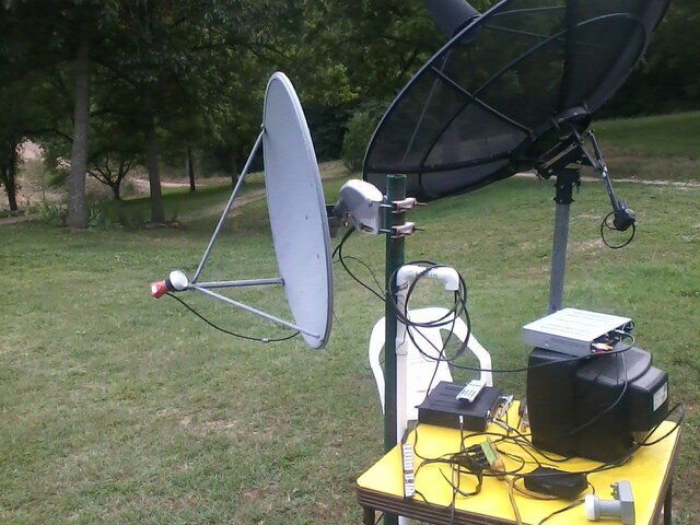

Pics are of the Slimline/S2100 setup and the SG2100 with it's new antenna load, the 90cm 3ABN. The Slimline was pointed at 67W and the 3ABN is pointed at 30W.
