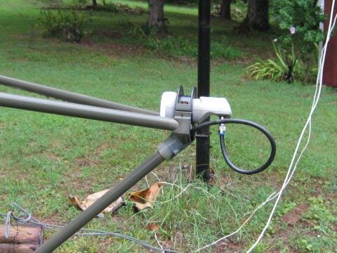

Here's a picture of mine:

If you have the original feedhorn and LNB (probably a single-polarity LNB), you can detach the LNB and waveguide from the feedhorn and mount any C-120 flanged LNB onto that feedhorn. I use the stacked Dish Network linear Ku-Band Superdish LNBs.
