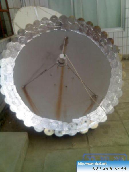

I would like to make mine even bigger
CD Prime Focus
This sure sounds crazy to me but what the heck...
I have a 6ft solid offset and I'm getting fringe reception on Ku sats.
8ft is too big for the wife, so I'm wondering if I can add 'wings' to my 6ft to extend the reception area - is that possible?
TIA
Easy fix. Just add CD's:D
