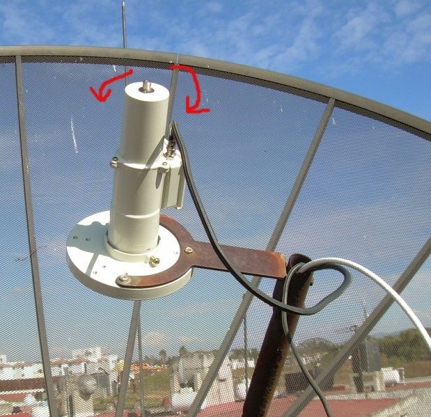

How do you determine how much twist or turn to put on the LNBF in the scalar ring? (see attached picture)

How can you tell what the same angle is, if there's no skew mark? The difference in models is that the switch is built in to the "less complicated" one. Otherwise they are very much the same.
This idea of saying it works with an analog receiver, therefore the LNBF has problems puzzles me. The adjustment can be in error on analog and a picture still come in. With digital, there is much less margin for error. C-band is some what more forgiving. Ku band is even less forgiving.
With digital it is all or nothing. Your old LNB is adjusted. The new LNBF is not adjusted. YET... You can do it... Now that the green reptile is watching and helping, this problem will be solved...
How does the OP adjust the LNBF? Does he take a small TV and the receiver up on the roof? Then peak the signal quality by watching the receiver meter and adjusting the LNBF position from there? .... position... in, out, turn left, turn right
If you can't take the TV up on the roof, you could have some one help. They could look at the TV and tell you the signal quality numbers.
Make small adjustments. Wait a few seconds (5-10) between adjustments for the signal to lock....

I've tried every suggestion you have recommended and I still cannot get this thing to work for the digital channels. For instance, I got the LNBF at 12 oclock and I am now able to get analog channels, I get a picture perfect signal on Transponder 17 on G16R @ 99 but when I disconnect the LNB cable from the analog receiver and connect it to the Coolsat I cannot get a single digital channel, no WAPA, no NBC, no ThisTV (channels that I can tune perfectly with the chaparral feedhorn) Ive tried turning LNB power OFF/ON/by Voltage, Single/Universal, every combination possible and nothing. I also get a picture perfect analog signal on the ESPN channel @ 125 but the Church Channel, Trinity and the other digital channels on that sat have a very weak signal (again, when I use the Chaparral feedhorn I get them crystal clear). I am absolutely baffled as to what the heck the problem is. Maybe this type of LNBF is not compatible with the Coolsat 6000, I really have no other answer.
