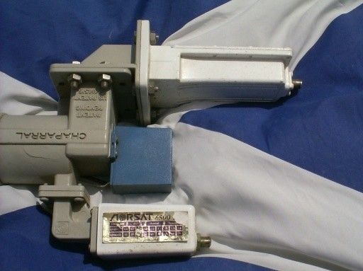

The mash dish is not yore problem the problem is the C/KU LNBF.
Get yore self a real feed horne like the Chaparral C/KU CoRotor II plus and stop messing with those imitation C/KU LNBFs
Have one, prefer the BSC 621-2 one coax cable does it all.
I am getting good results with a 6' mesh dish on Ku signals :up
I did optimise the LNBF for Ku signals (Including modifying the LNB cover) adjusting the skew and F/D while locked on a ku signal. C-band signals did suffer but the end results were worth it.
