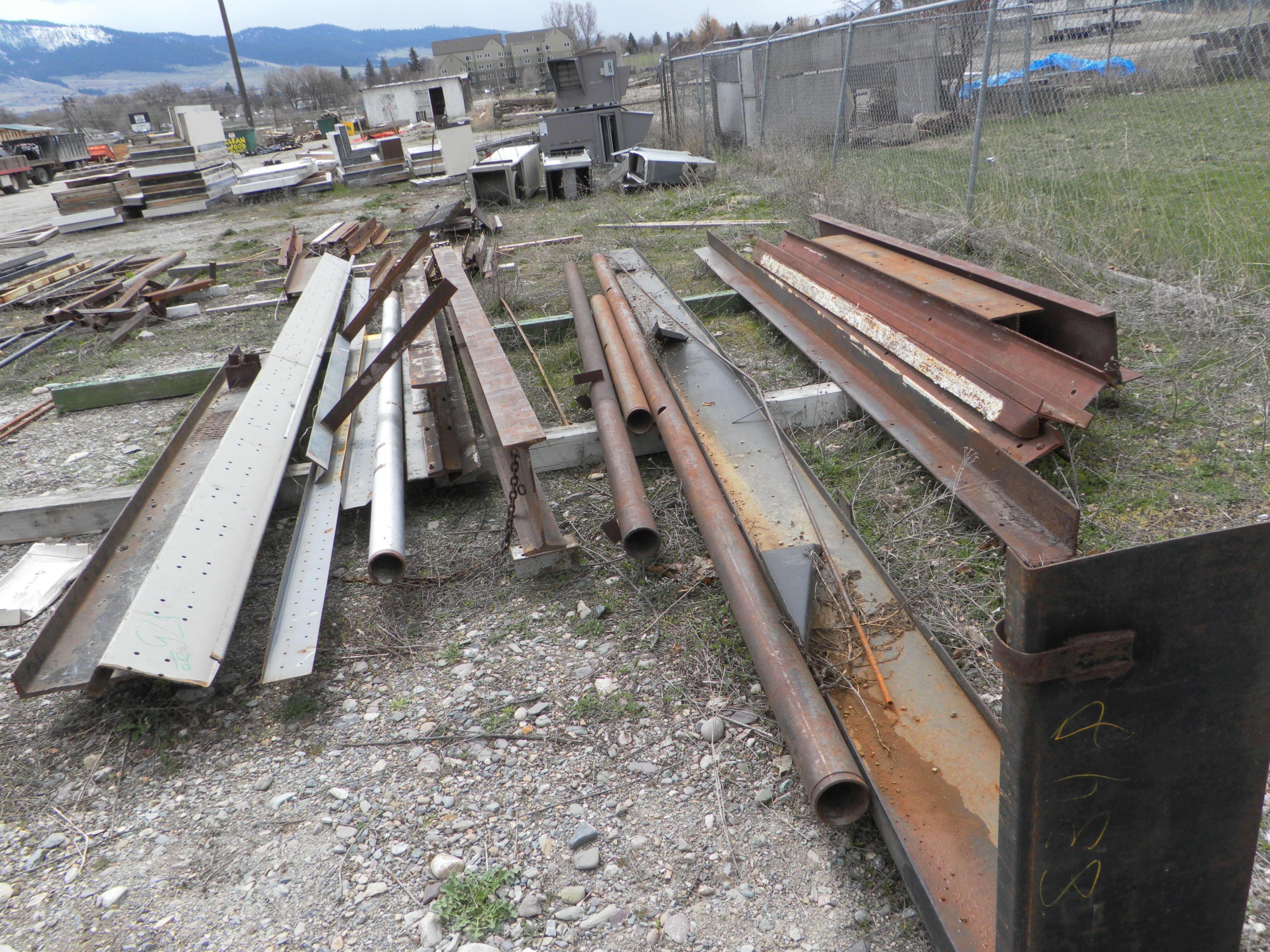

I bought mine from a place that reclaims used pipe for my Sadoun 6 footer. Cost me $58.00 for 10 feet of it. Look for salvage places, well drillers (metal well casing) Places like that using the local Yellow Pages.
We have a place called "Home Resource Center" that sells reuseable building materials. I bought a 21' schedule 40 pipe for $60 :)
