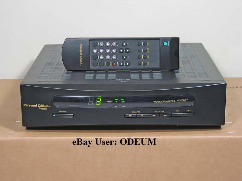

Uniden ULTRA C-Band/Big Dish Satellite Receiver Can you tell me if this is analog or not.

How would i use it to find or set up my dish.No manual with it any ideas
I don't have that receiver, so I'm not familier with it. But, I'm sure someone on here is, and hopefully they will read this thread and help you with it. Not sure which type lnb's or lnbf's you are using, but this receiver could be used to power the HH180 motor (I think) you have. It could be used to control the polarity from a polarotor (servo motor) if you are using one with lnb's. If you are using lnbf's (I think you are), you can slave this receiver from your DVB receiver, to watch analog with. Although there isn't a lot of analog out there anymore. There are plenty out there to use and find signal with. You can look at lyngsat for analog channels on C-band to use to find satellites. You may not find any ku-band analog listed on lyngsat, they are mostly backhauls/wildfeeds.
Hopefully, someone can help you with the receiver itself? Good Luck!

can anybody tell me were i can dnload a manual for a uniden personal receiver?Hopefully this analog will help in my setupping the dish.
