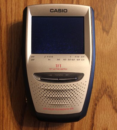

I have used a satellite receiver and a Casio portable tv at the dish.

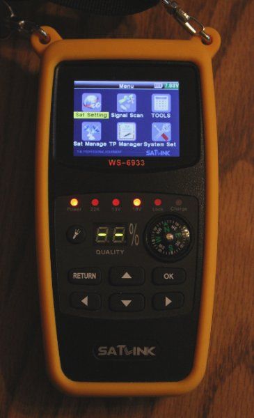

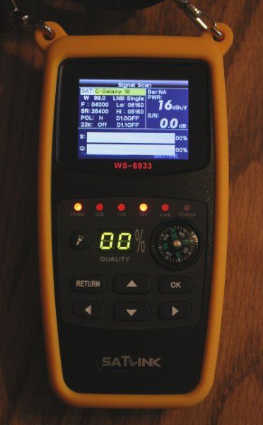

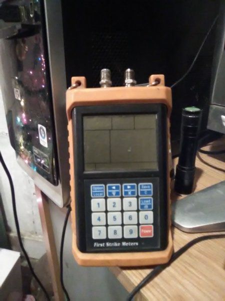

Lately I have been using my Satlink WS6933 meter. It has a built-in flashlight that is very bright, which comes in handy for after dark adjustments. ;)

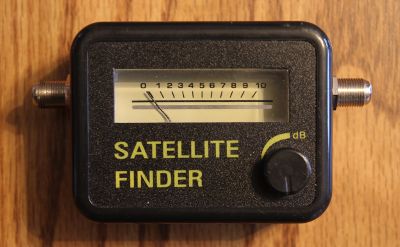

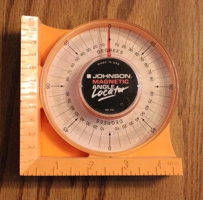

When initially setting up a BUD I use dishpointer.com, a compass, a Johnson magnetic angle locater and my cheap (about $10) analog meter. I get it in the ballpark then swing the dish by hand. As you move past each satellite the meter needle will raise and lower and the sound pitch changes. When I hear and see that rise and fall across the arc I know I'm there and it's time for some fine tuning. :)

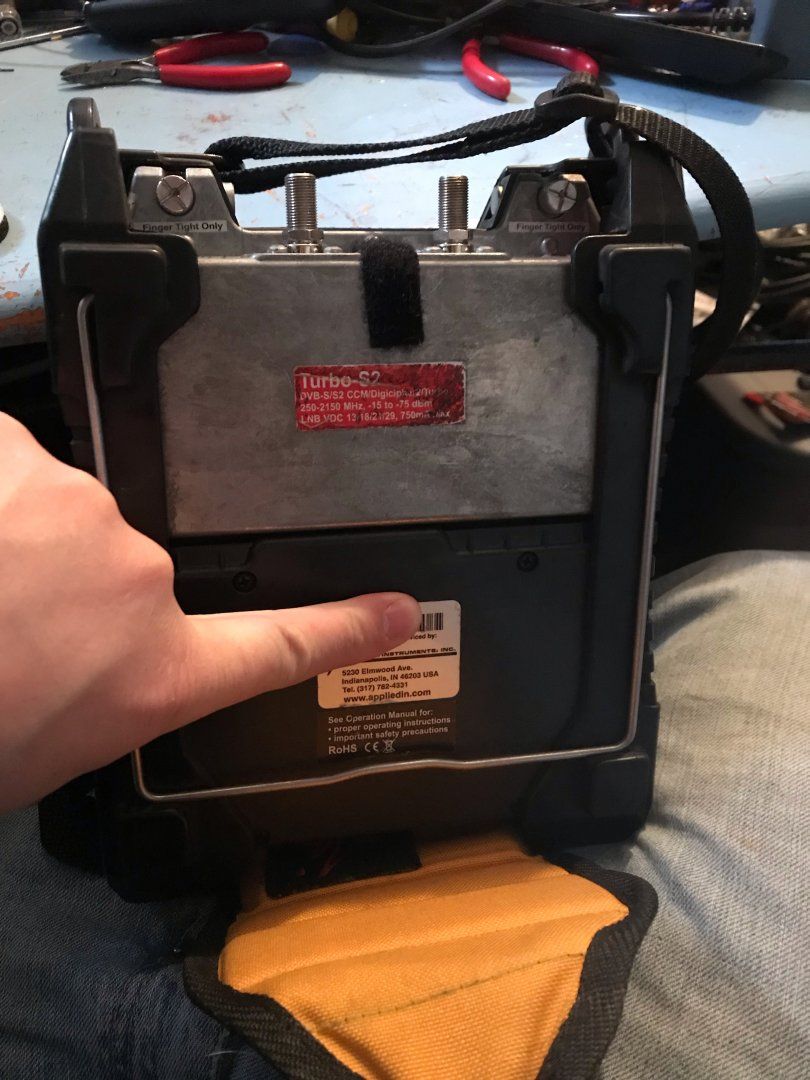

Sathero meter. Works for c and ku. Raydio, it saves a lot of time. I keep,mine plugged in 24/7 in kitchen for easy access to backyard when needed.

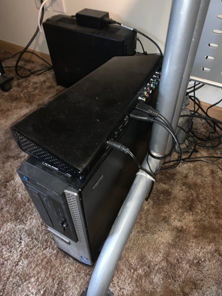

I used to take a small TV outside to point my dishes. Then I started using a Slingbox connected to my Amiko receiver. I take an iPad outside and set it behind the dish.

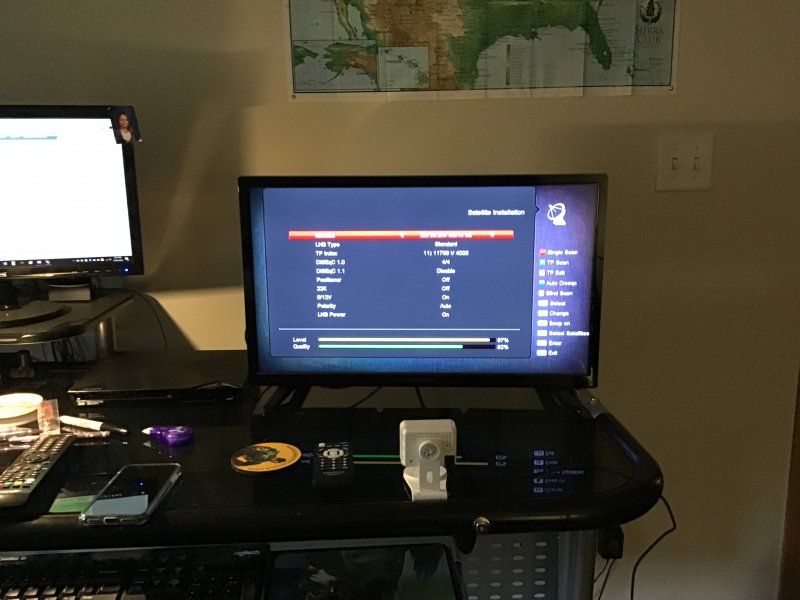

Another way I'm using is a Zmodo $30 wifi camera. Point the camera at the TV (inside the house), then load the app on the iPad.
The Slingbox method has about a 5-7 second lag, which isn't horrible when I remember there is a lag!
The Zmodo cam has a near-instant response time, so it's much easier to make fine adjustments with it.

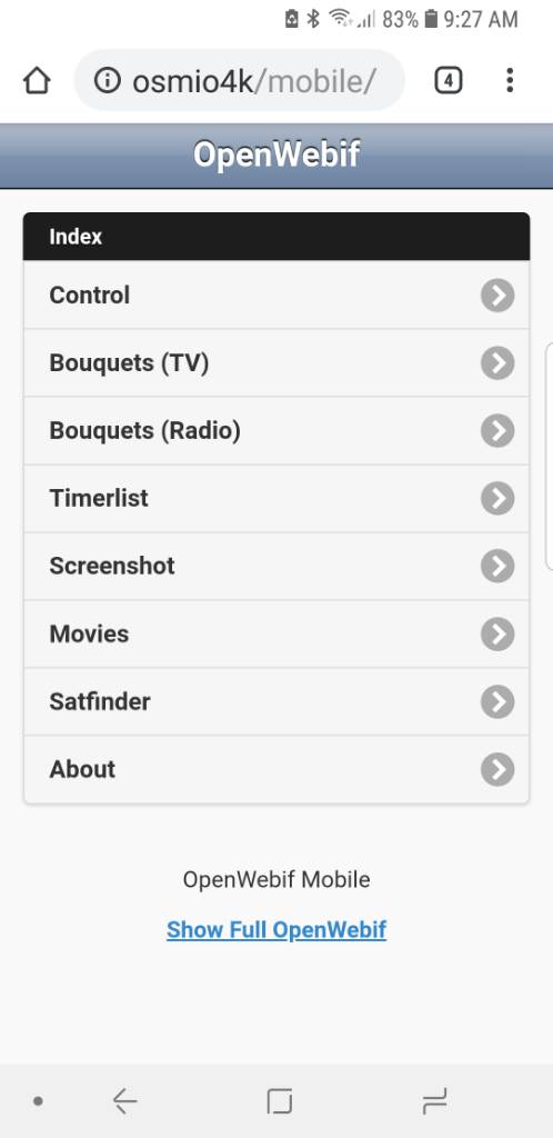

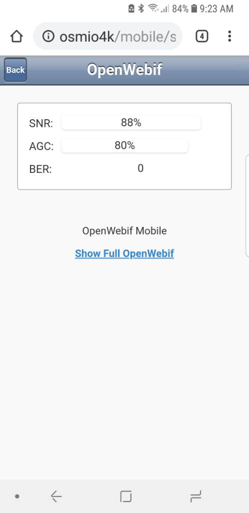

The E2 receivers have an OpenWebif application for computer or phone interface. It will give you something better than yelling or listening through the open windows for feedback.

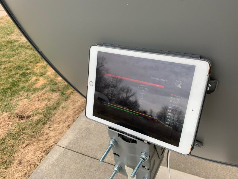

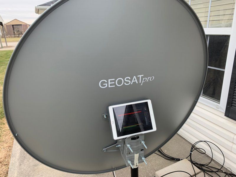

View attachment 137505View attachment 137506
Sent from my SM-G950U1 using the SatelliteGuys app!
I tried it on my OS Mio 4K... It works, but seems to refresh only every few seconds... Do you know if there's a way to make it refresh more often? Or any app that would do the same but closer to real time?
