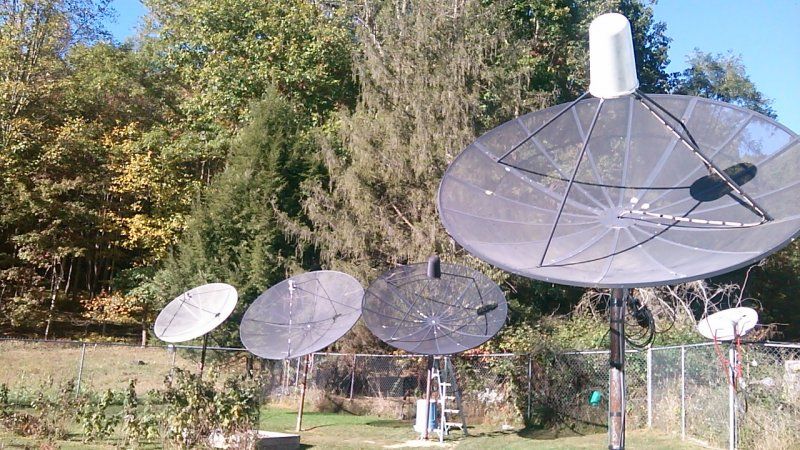

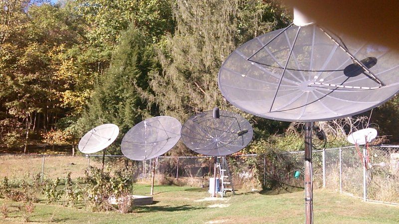

Sleeping in the car isn't too bad. Tell her the additional radiated RF is beneficial and will improve your sex life. :biggrin They fall for that every time. If you were here, I could probably get you a 10 footer free. Here's my yard. Just installed the 3rd one from the left today. I'm shooting for 8 dishes in all. I have a 7 1/2 footer laying on the ground. (not in picture) There's a Paraclipse fiberglass behind these, but it's out of sight behind the trees. I have less than $600 in this setup, and most of that was for LNB's and receivers.
From Left to right, 101W, 99W, 97W & 87W. The Paraclipse is on 103W. Not sure where you are?. Depends on how far you're willing to travel. I'm in central West Virginia. I'm going to look at another 10 footer tomorrow.
