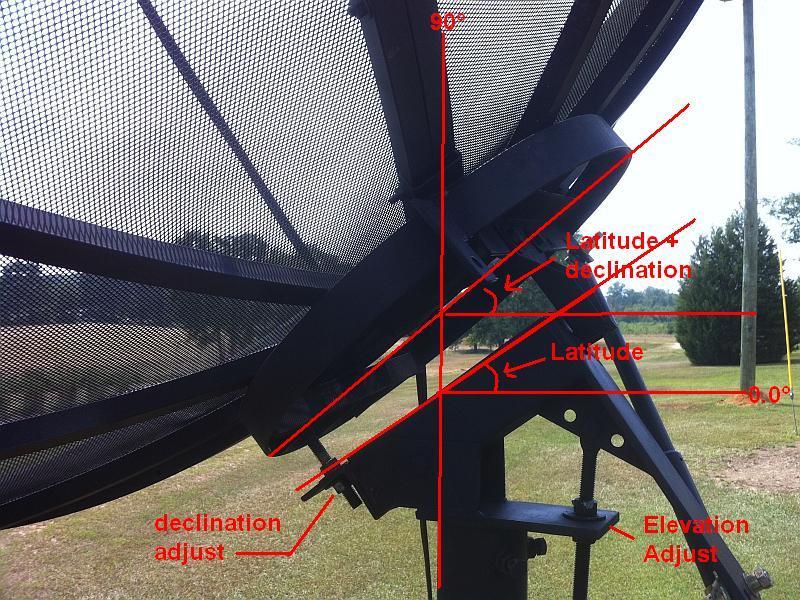

Heads up on the dish, when aimed at the highest it will go with the actuator, in the attached picture.

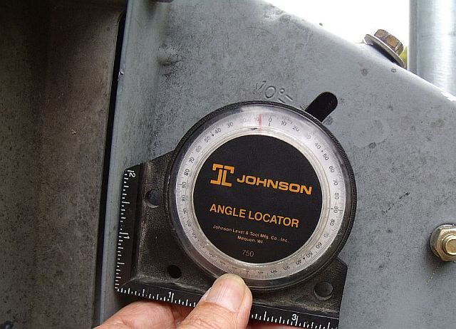

Usually only requires a large crescent wrench and an angle finder (third attached pic)
Here's the angles on the dish:

You start by getting zenith. That is when the dish is at its highest point and not leaning at all either left or right.
