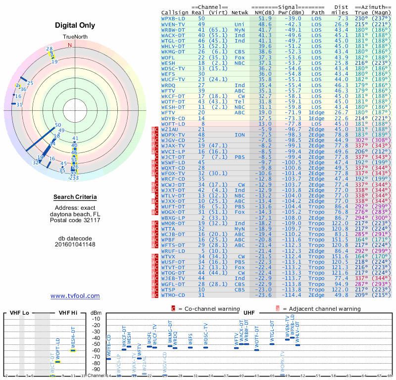

I am having the same issue I can p/u wrdq perfectly all the time but the main ABC wftv is intermittent. I only have a 50 mile indoor antenna so I guess I should be happy what i receive. Could it be an issue of bandwidth having 2 main channels and 4 sub channels?
Don't see that as an issue. The issue is the one you don't get reliably is 1 edge and weaker that the other. ( which is also LOS )
What make / model? Are you getting all the stations within 50 miles?
If WFTV is desired I think I'd put a 30-2425 - HDTV 60 Mile Fringe Bowtie Television Antenna In that attic, or on the roof, aimed to the SSW.
With that antenna, I am getting a channel, 4.1 thru 4.10 (Real ch 38) @ 64 miles with the signal indicator showing 100% 24/7, Also 1 edge, over the horizon. Yeah, it's ~30 ft above ground.
This i s my antenna Amazon product ASIN B00RFLGH5E Is channel 20 a mini tower? Wiki lists it as a transponder. How do I know which one I am picking up? I can't use the amplifier because the antenna runs through a hdhomerun network tuner
Don't understand. That should be capable. Antenna>>power inserter>>HDHomerun If you're not powering that antenna it's nothing but LOSS.
mini tower, transponder? It's a translator. Rabbitears coverage MAPS. (Real Channel 20 and 39) Ch 20 is the smaller inner contour,
You MAY figure out which one, REAL Ch20 or Real Ch 39, by selecting channel 20 and see if it comes in and ID's as Ch 9.x Try again by entering channel 39. (just enter two digits) One or the other, maybe both, will come in as channel 9.x. Your TV's display the virtual channel, 9. true??
39 is LOS, 20 is 1 edge. Maybe your tv ignored 39 because it already scanned in 9.x already on 20 ?????
