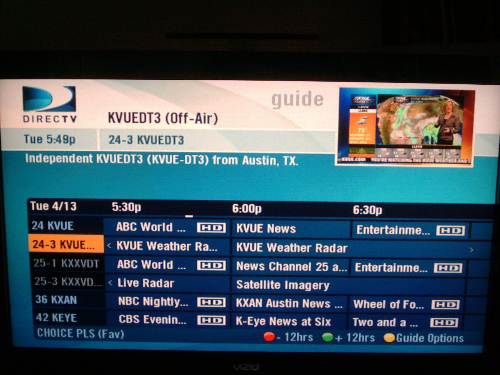

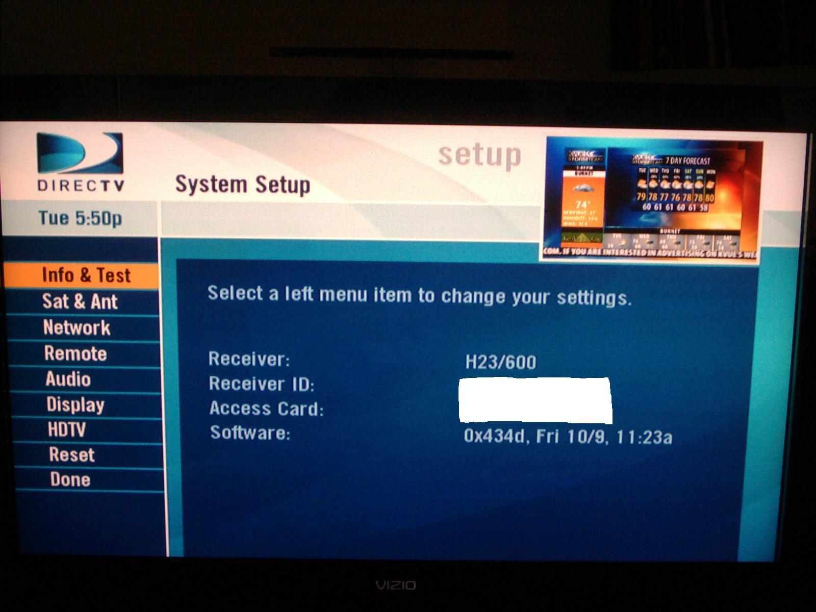

The AM21 works just fine with my H23 running 0x434d.

There is no reason why it would not work. The software for all the H2x series receivers supports the AM21 (except of course for the H20 which has an OTA tuner built-in).
