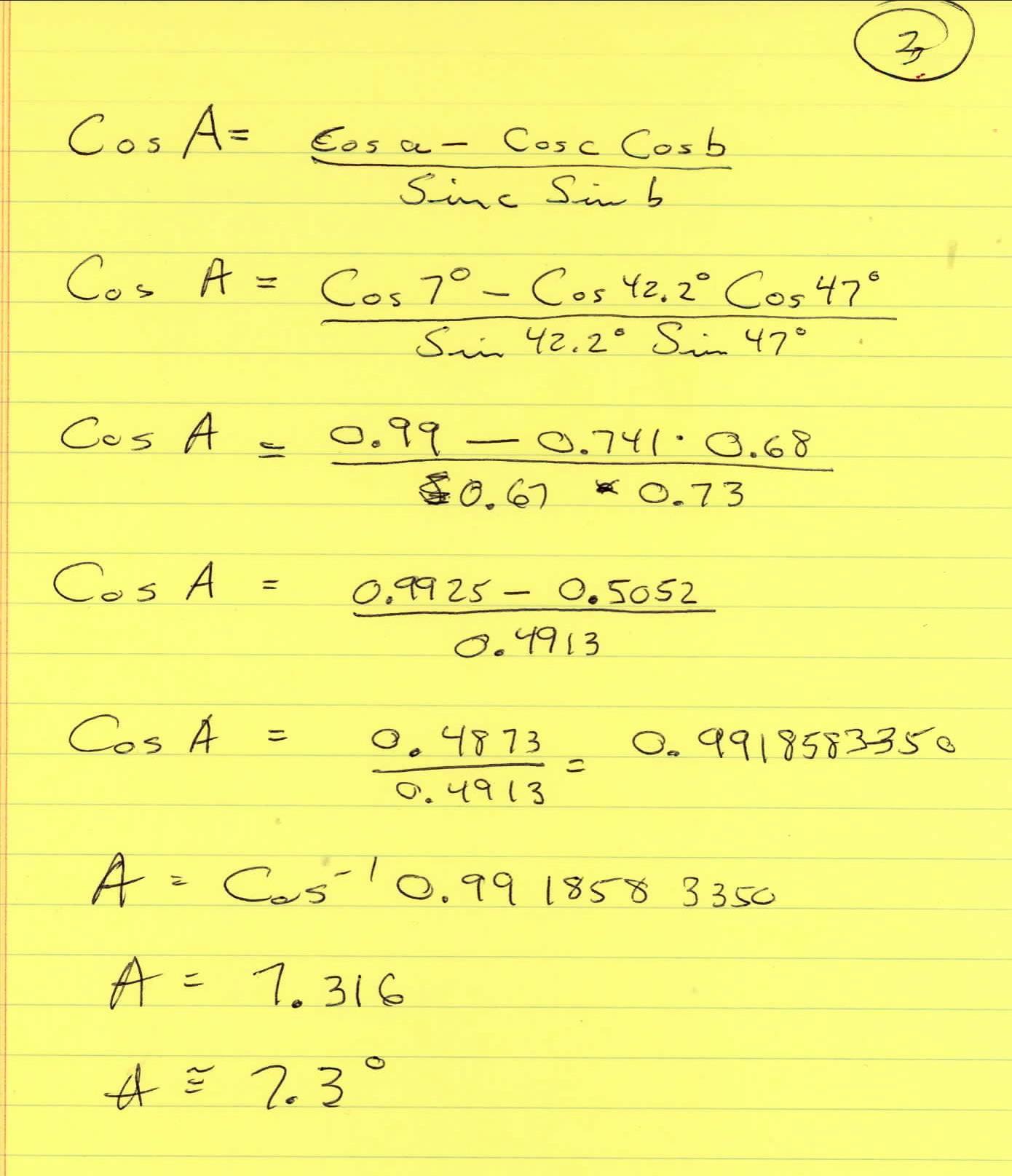

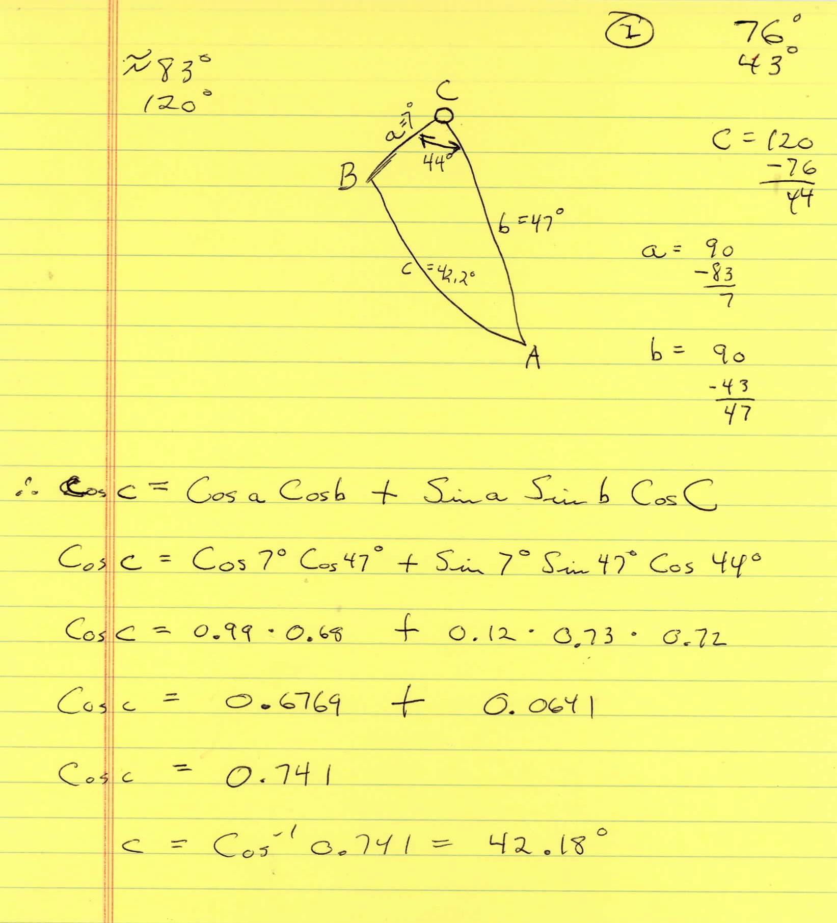

This may be old news to many of you, but may be of interest to some. An article in the recent issue of National Geographic about the wanderings of the north magnetic pole got me to thinking about why I was always off by a few degrees when I wanted to aim my dish using a typical table of magnetic north satellite azimuths from my location. The software I was using had a difference (the magnetic deviation from true north) of about 13 degrees built-in.
If you check the attached PDF & JPEGs, the correct deviation of magnetic north from true north is a calculated value of about 7+ degrees for Central New York State, not the 13 degrees in the software. A re-aim on my dish confirms that! The 13 degrees is representative of where the north magnetic pole was about 25 years ago.
To do the spherical math, 83 and 120 are the latitude and longitude of where the north magnetic pole is now, and 76 and 43 are my longitude and latitude. "C" is the the north pole, "A" is my location, "B" is the north magnetic pole, and "a" and "b" are great circle meridians. Angle "C" is just 120 – 76, arc "a" is 90 – 83 and arc "b" is 90 – 43. I hope I got those right in this paragraph without typos! (if there's any differences the yellow calculation sheets are correct).
[Note - these are rather large files, especially the PDF; so, don't open unless you're REALLY interested in the math!]

Hi Brian -
If you go to this month's (or last month's?) issue of National Geographic you will see that the only anomaly is how far the north magnetic pole has moved recently.
And the clincher is that when I use 7 degrees I find the satellite I intend to, rather than a different one when using 13 degrees.
The calculations are rather straightfoward based on the sketch in NG.
And just eyeballing it on a large globe you can see that the angle is approximately half what it used to be.
A few months ago when I was going nuts always getting the wrong aiming point and the wrong satellite with my compass I also thought there was some iron nearby that was messing me up on magnetic north. But the NG artricle clears it up - although they didn't bother to calculate any typical values for various areas of the US, for some odd reason: spelled "GPS."
Dave

Hi Brian -
I checked out that link you gave. It yields a very small change per year. But NG is showing about 25 miles per year, almost directly north for the wandering of the magnetic pole.
Either I vastly misunderstand what's going on here - which is always possible! - or the 2 "sources" should talk with each other.
Dave
Another possibility
Another possibility here is that we all may be correct!
That is, in addition to where the North Magnetic Pole IS and local magnetic disturbances - what may be critically important in all this are any large magnetic concentrations or depletions in-between the magnetic pole and a locality. After all, the magnetic lines of equality are never shown straight, nor even just as great circles, when drawn on a globe. They are generally rather chaotic.
Maybe NG ducked the question of showing "new" typical values for good reason.
Dave
