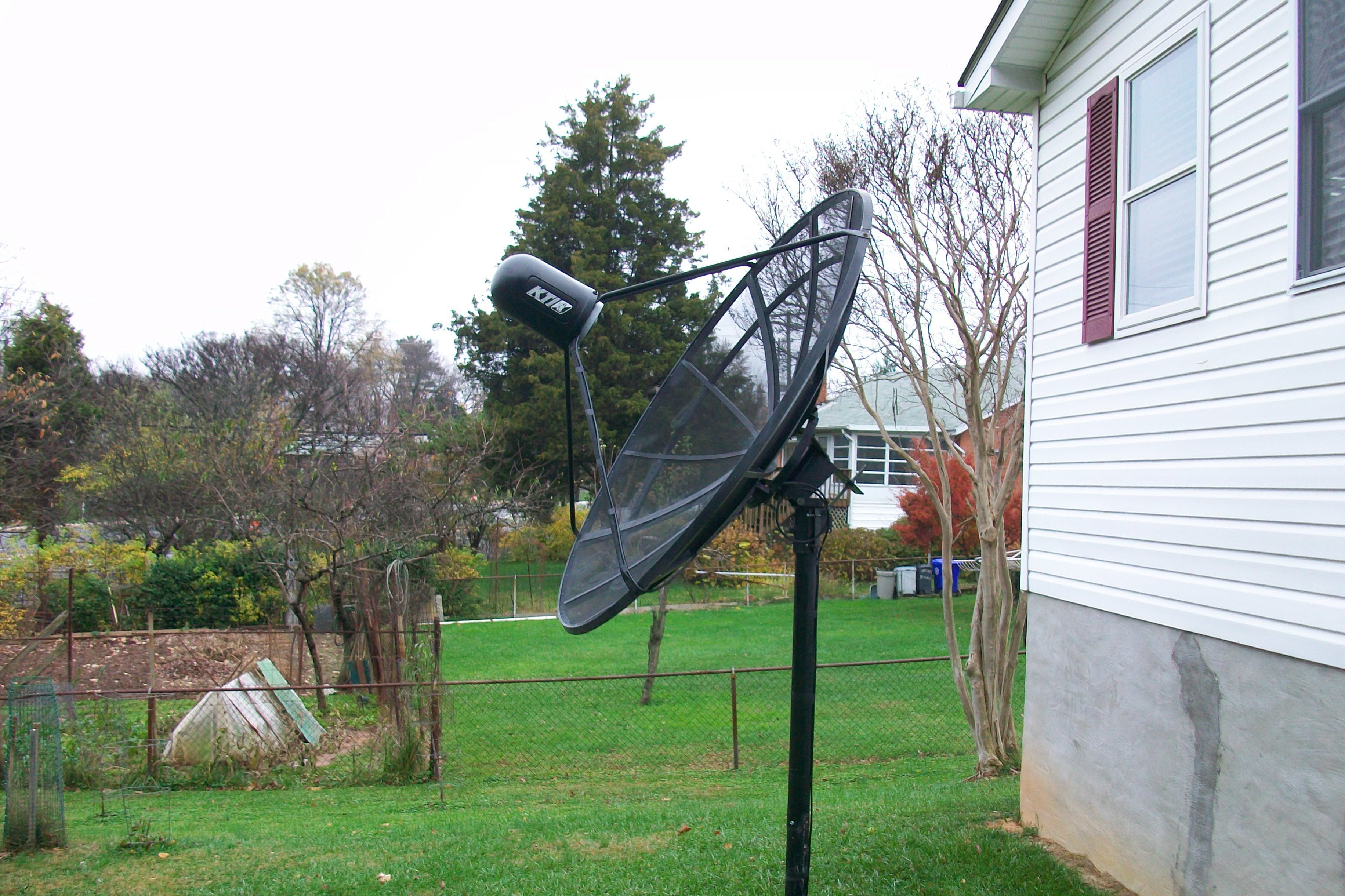

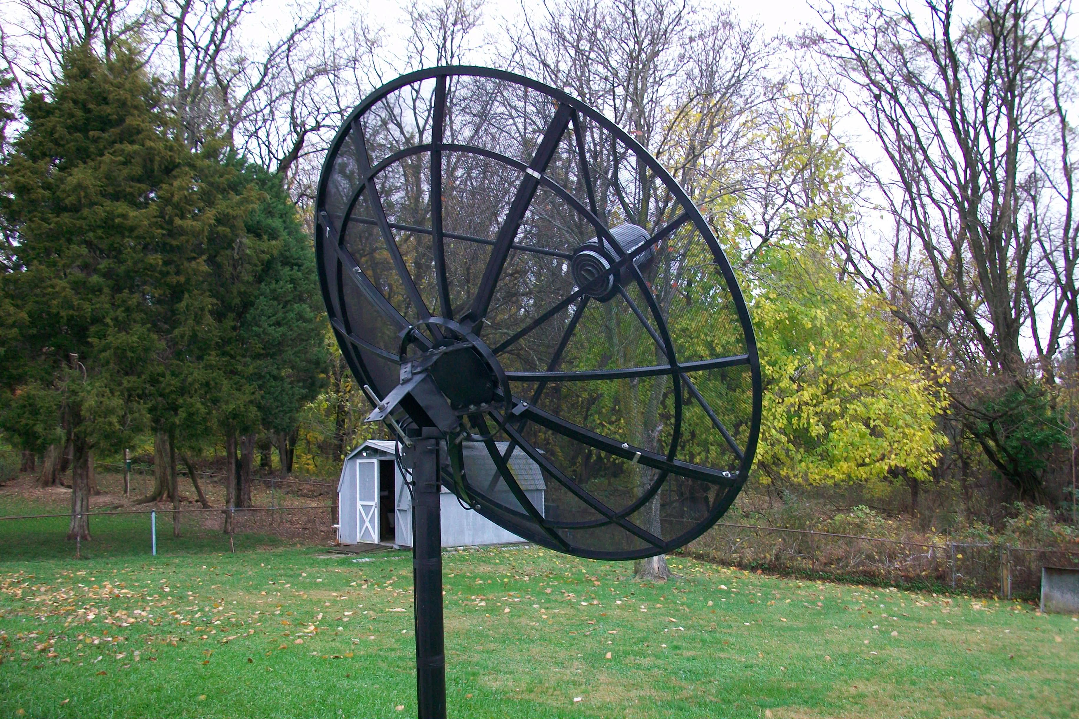

I am using a 5.9 KTI dish to receive ERT World on NSS 806 . DMS C-Band LNBF with a dilectric plate Traxis 3500.
Signal, 69
Quality, 65
Playing fine with no break ups.

That's a prime focus dish, correct? OP was going to try using a 1.2m ku off-set from the sounds of things. Sadoun has some nice 6 footer prime focus polar mount dishes still on sale ($149 + ship) , and they aren't that bad. Hypermegasat has some 6 footer fixed dishes for $119 + ship that are good also. Personally, I'd spend the extra $30 for the polar mount version. So, for a couple $100, he could be in business. Or, if he scouts out a local freebie dish, it could be even cheaper.
KTI 5.9 mash dish for NSS 806, using a 1.2m for 806 ??? try and see if you can get a signal.
