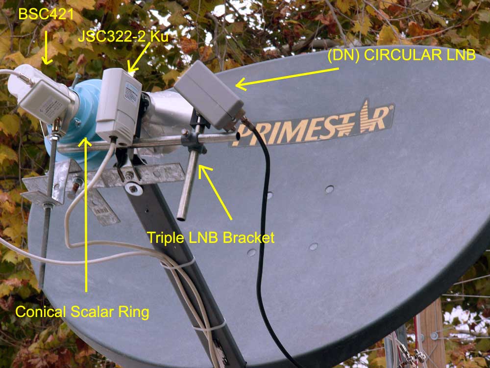

I use a SG6000 on a primestar 84e. Pretty heavy with no problems, but a jack will get you there faster.
Combo LNBFs are next to worthless on a mini bud. Use a dedicated Cband and Ku LNBF. Mount them next to each other.
Search the forum for Mini-Bud to see what other's have done.
