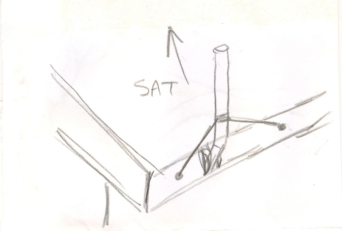

I couldn't get the link to open either. I am glad that I need not be concerned about a warped dish. My concern came from more than a couple of posts addressing warped dishes though. My problem is that my mast plate and the support arms are all bolted to the fascia with the dish looking up over the pitch of the roof. This doesn't give me enough of an angle for a good triangular brace. My digital camera is not home right now so I'll try a sketch.

I added to my post while you were posting. If that is the way you have it mounted and can move it, I would LOOK at moving the mounting so you could brace the pole around or on the corner. Then drill and put two sheet metal screws, one in the wall mount and one for the dish mount. That REALLY stopped my stability problems.

It's actually not as close to that corner as the sketch appears. The corner might move me out of the notch in the trees I am aiming for plus the dish would be too much in view from my deck if moved to the corner. I have some galvanized water pipe that appears to be the right diameter so come spring I may use it to move off the fascia. It would permit me to use it for a ground as well thus getting a better ground closer to the dish (I am now sharing the telephone ground). Meanwhile the sheet metal screw sounds like a very good idea to stop the mast from rotating back in the wall mount. Thanks much!
Thinking.... Can you get one brace down to the eave and then a piece of 1/2" emt to the edge of the roof eave - maybe even the full 10 feet to make it solid?
Grounding drains off the static, so even a longer run (within reason) will not hurt too much. A direct hit will remove the roof! And yes, I have seen the results of a direct hit. A 5 foot length of 750 mcm will not protect from a direct hit. A direct hit on a power tower near our property (30?) years ago brought down the whole tower and started a huge wildfire that people still talk about.
Most of my suggestions have come from trial and success - trial and error does not give me proven ideas to pass on. I do not like to talk about the errors! So I suggest what I have found works. I have tied a pool table, Flipper Game and Jukebox into the back of a pickup truck with kite twine for a 70 mile trip. I do not recommend it, but I had to do it and I used all the twine I had. I found if something can not start moving, it can not fall off the truck. Same principle with the dish. If it can not rock, it will not move out of alignment.
