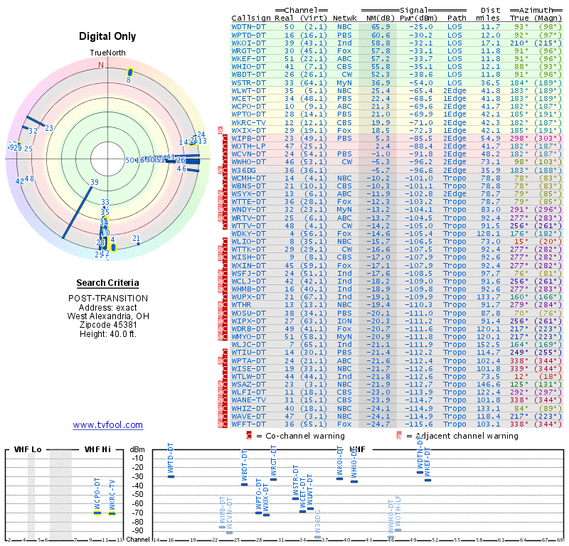

Here is my posted tvfool results.

If you are seeking WWHO-53.1 from Columbus, I personally don't think the 7697 or any combo antenna will pull it in reliably 24/7. The 91-XG(~$75.00) would be your best bet; but with the obstructions between you & the transmitter, it may still not be 100% reliable.(You're right on the digital cliff edge)
If you don't need ABC & CBS out of Cincinnati, you don't really need a VHF antenna at all.
With a rotater(~$70.00 & up), you should be able to get all the stations down to the gray zone of your TV FOOL report; except for those 2 VHF'S out of Cincinnati.
IF you do want those 2 VHF's, I recommend adding the Winegard YA-1713(~$40) pointed towards Cincinnati. The 2 antennas can be combined into the same downlead with a UVSJ (~$3.99)
If you need a pre-amp for distribution to more than 1 TV, I would go with the Winegard HDP-269(~$38.00). Any other pre-amp may overload because of the strong locals from Dayton.;)

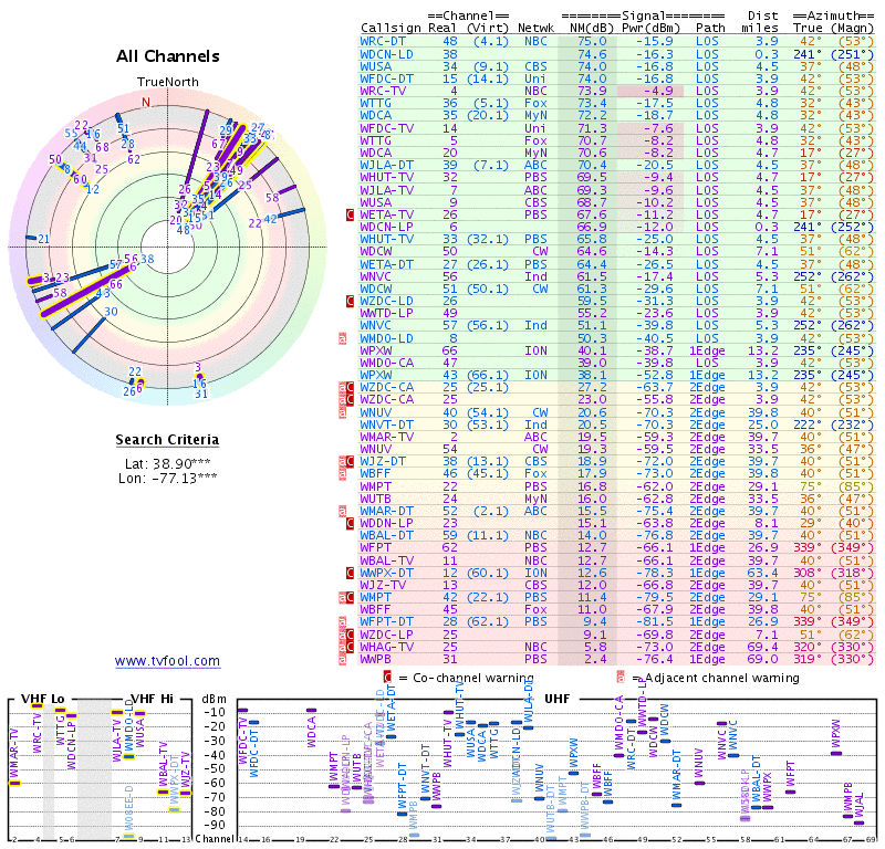

I bought an HDP-269 to use here "after" the transition. My signal levels are much higher than yours.(I"m actually getting a slight amount of overload with the 91-XG with no amp) Just for kicks, I tried the HDP-269, and was very surprised I only lost 1 digital station.(That station is very weak )
I have attached my TV FOOL report (Analog & digital)
