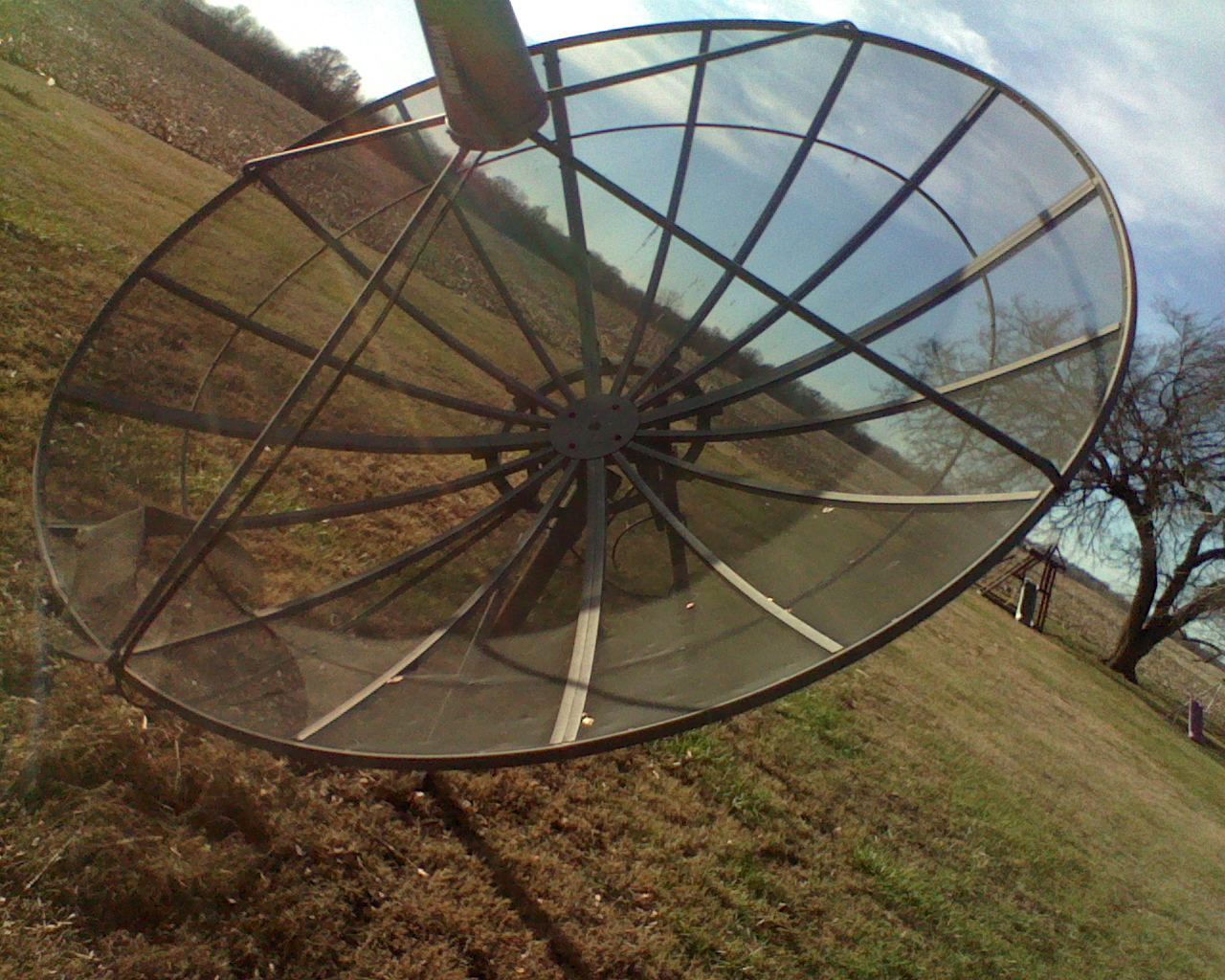

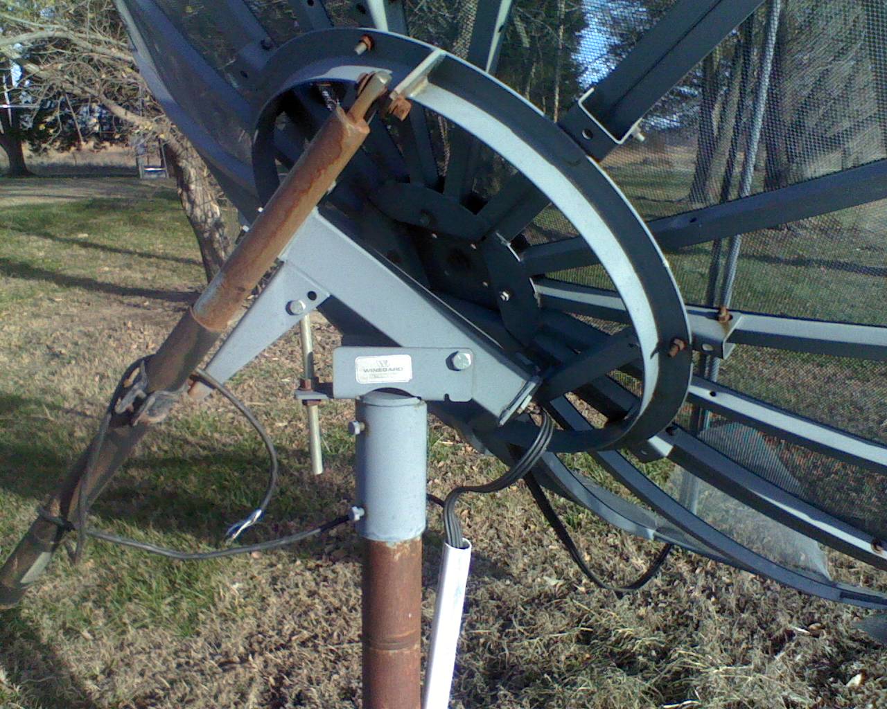

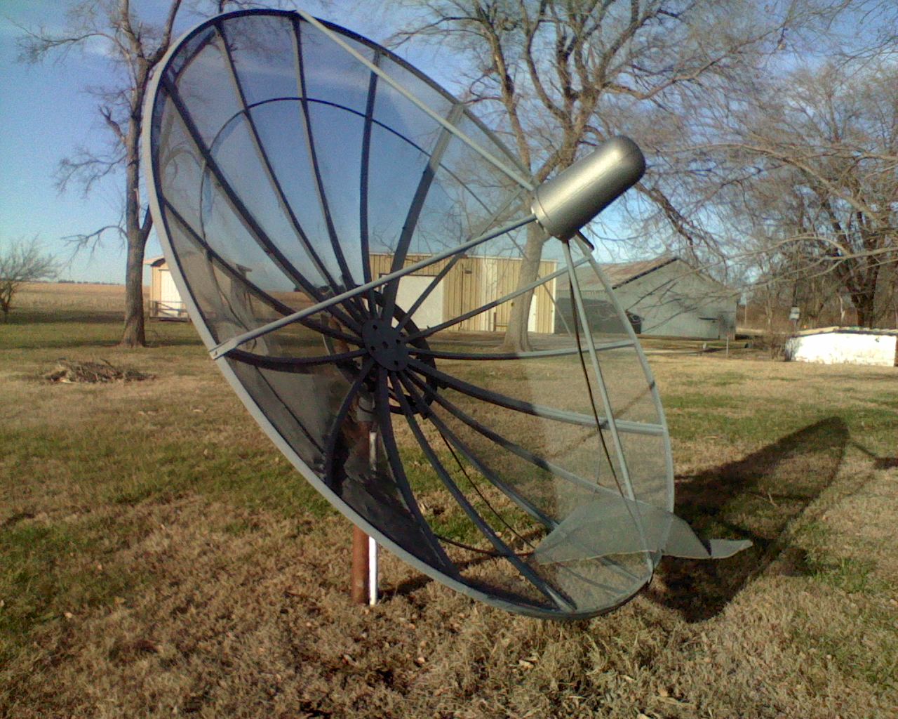

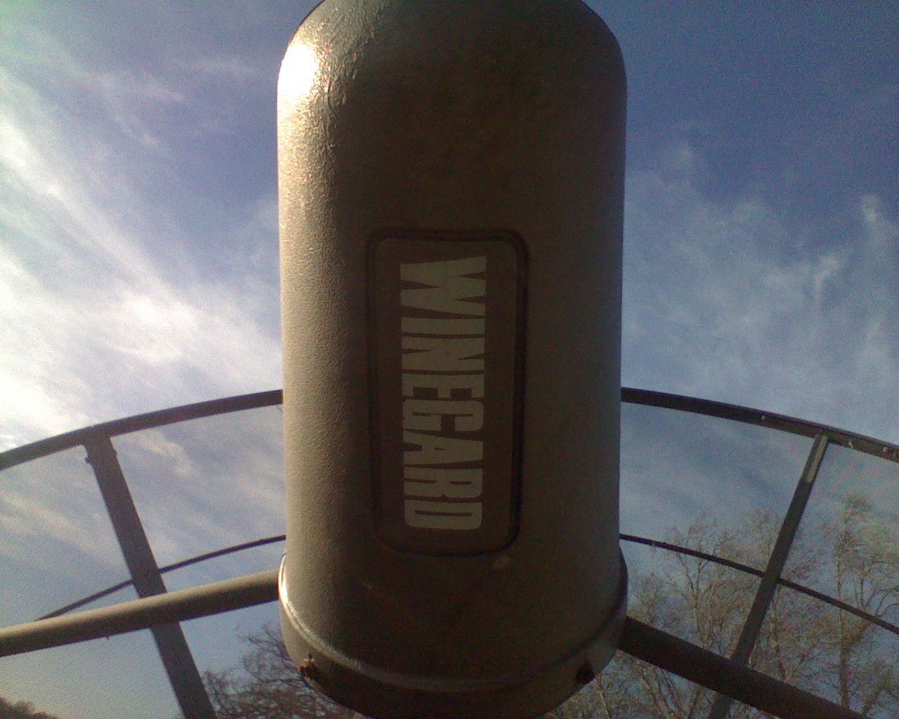

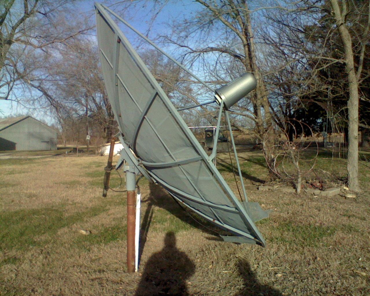

Saw this Winegard today, it appears to be a 10' and in need of some TLC.
I asked the property owner if they would let me know should they ever decide to get rid of it. His response was that I could have it.
1209151519a.jpg 1209151519b.jpg 1209151520b.jpg 1209151518a.jpg 1209151520a.jpg
It's missing a mesh panel, several panels need some straightening and the actuator doesn't have a motor on it. Otherwise, it appears to be in fairly good condition.
Anyone have thoughts on it? Is there any advantage the Winegard would have over my current SAMI (10')?

Don't know if there's any advantage to be gained, but IMHO, a backup isn't a bad Idea. Could, probably, re-use your existing mount if disaster strikes.
(you get hail? I've seen some Al dishes trashed by 6 in hail, rare, but it's happened)
Plus, the time spent rehabbing it into 'condition' is a past time in itself.
FWIW: I'd grab it, if close enough, Just for the polar mount. A 1.2, would then 'hang out' there. (I've got plenty of spare panels for my BUD available)
Reactions: Jason S
I love Winegards. Assembly and disassembly is very easy, compared to a KTI which is the most royal pain of a dish to assemble/disassemble. Looks like a Quadstar, Unbolts into 4 sections.
I have a Quadstar and its my favorite.
I've got one of those dishes that's listed in my signature that I bought new in 1988 and I'm still using it, dish mover and all! The only thing I've done to mine maintenance wise is replace the nylon nut in that Von Weise mover with a brass one and I did that to a spare mover also.
The one on that dish in the picture looks like an old Super Jack, which is/was a decent piece but if the motor is gone, then water in the gear housing has probably killed it! I think there are some of those still around and you can still buy the Von Weise and also Venture movers for that dish. Not sure about finding that mesh though someone on here has to have gotten it somewhere before.

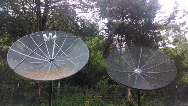

Get two buds so they don't get lonely:
Winegard Quadstar on the left.
Reminds me to take some recent photos.

You won't need a ladder or bucket truck to take it down. :thumbup
I'd get it as long as it passes the string test...heck,for free I'd get it anyway.
If the rest of the dish is in good shape, don't think one missing panel is going to 'kill' performance, Only inflict a slight limp.
Put it up fixed on 99(?) while awaiting another actuator.

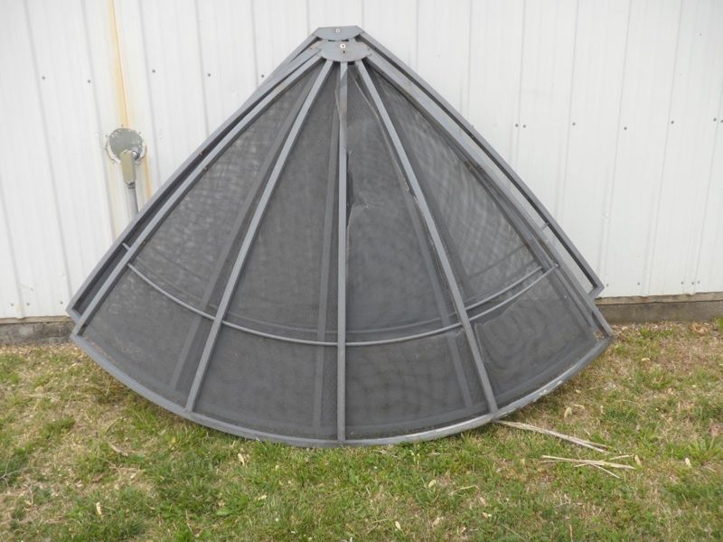

Finally got the Winegard rescued...
The landowner and his father helped me and had a skid steer waiting. With all the help everything was down, disassembled and in the trailer in about an hour.
I got the pole, but not the base. The pole was clamped into a tripod base that had been buried over time. As the donors had other things going on, I didn't pursue the rest of the base. I can weld a mounting plate or tripod mount to the pole whenever that time comes.

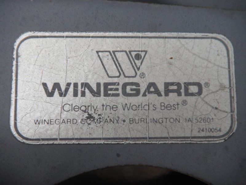

So here are the photos of the disassembled, rescued Winegard at its' new home:
The four segments of the dish:

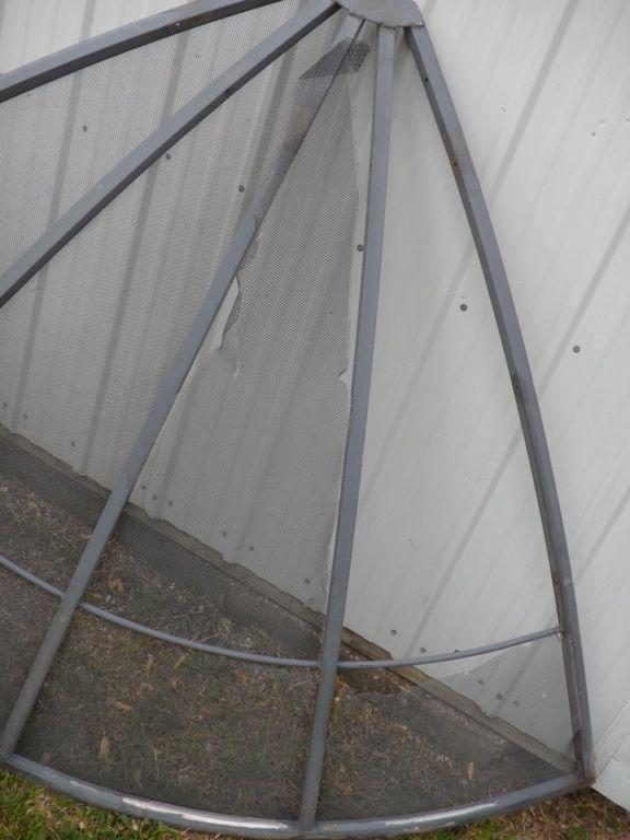

The worst of the four segments:

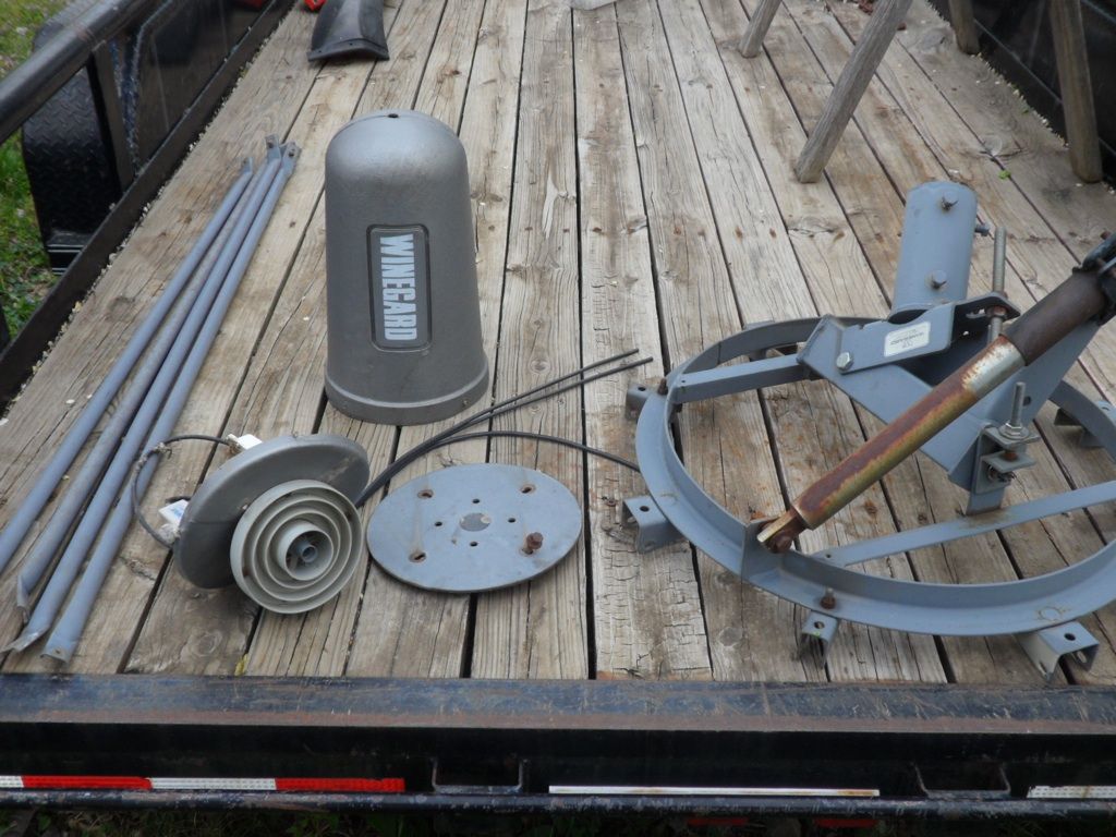

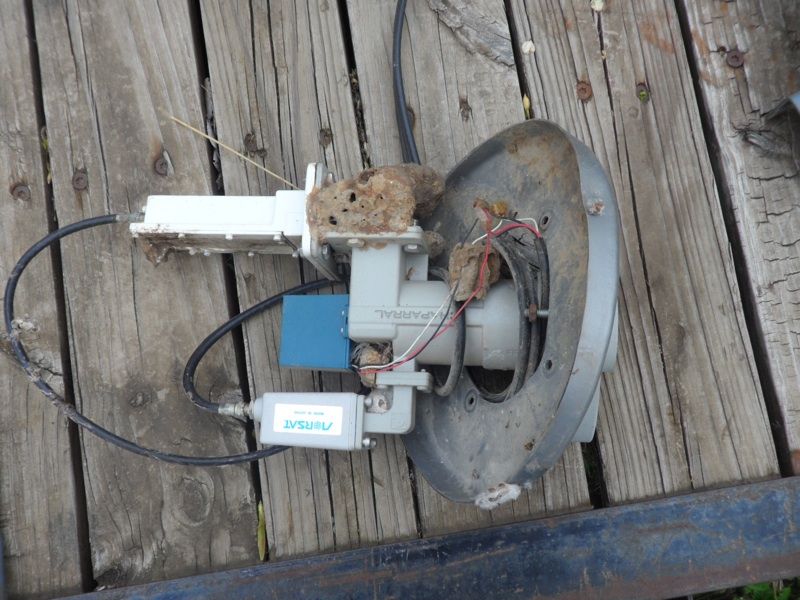

Arms, polar mount and feedhorn & scalar and cover:
Feedhorn and scalar:

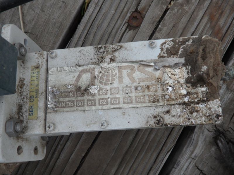

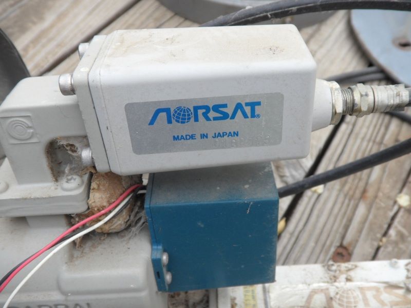

LNB's:

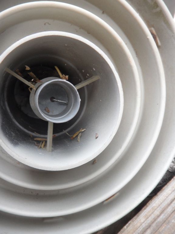

Feedhorn throat:

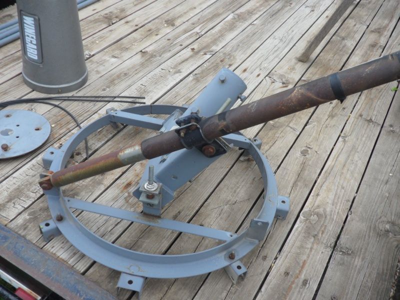

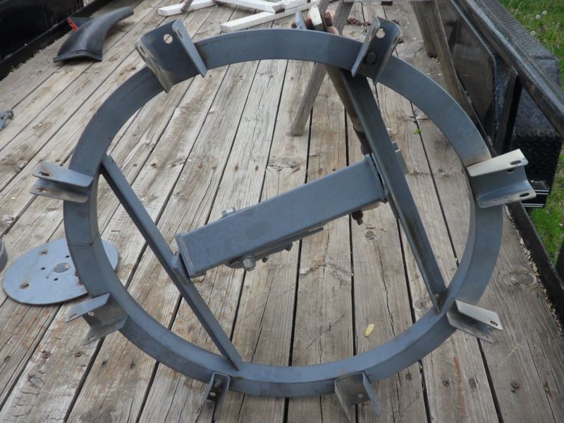

Polar mount and ring:

Very much appreciate the offer. I'm not sure how long before I get to rebuilding this dish, so photos may come in handy. I took a camera, but got too involved with the tear down to take photos.
I must say that thus far, there is so much about this dish that is very well thought out. For example, the ring on the polar mount is above and beyond what is on either my KTI/Echostar or SAMI.
