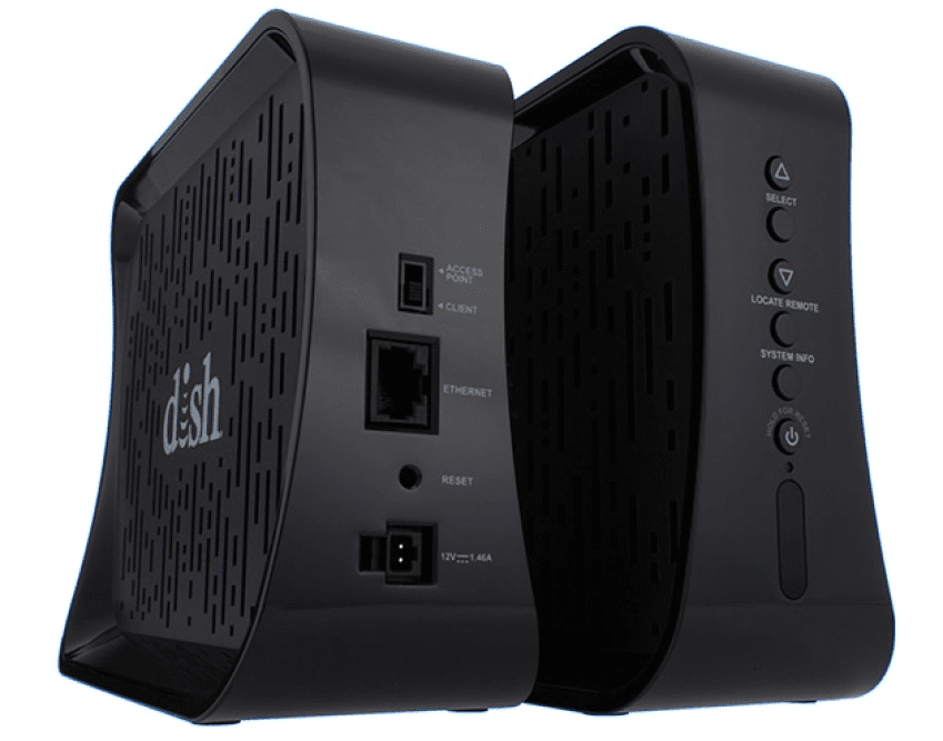

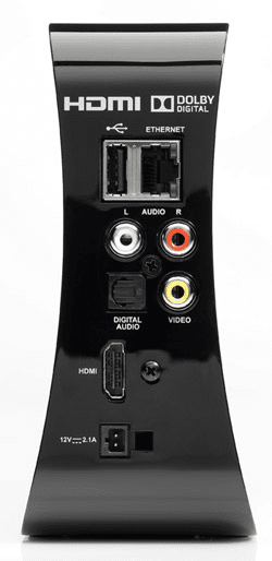

Wireless Joeys work with a separate Wireless Joey Access Point that plugs directly to your Hopper to feed the WJs via its own wireless network...so it's not robbing bandwidth from your existing wireless home network. Not sure which flavor of wired Joeys you have now, but performance-wise, the Wireless Joey is on par with the wired Joey 2. It's usable, but slower than a Hopper 3 or a wired Joey 3.
Something else that may be pertinent to your wall-mounting situation...the Wireless Joey is a completely different shape and is made to sit upright on a table or shelf. It does not come with a wall mount, nor does its concave shape lend itself to being wall mounted easily.

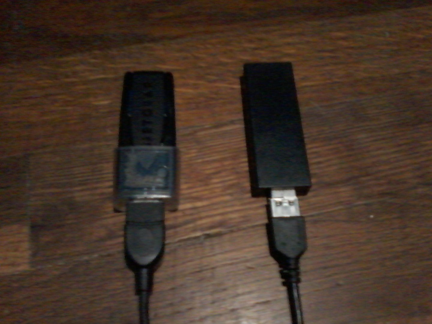

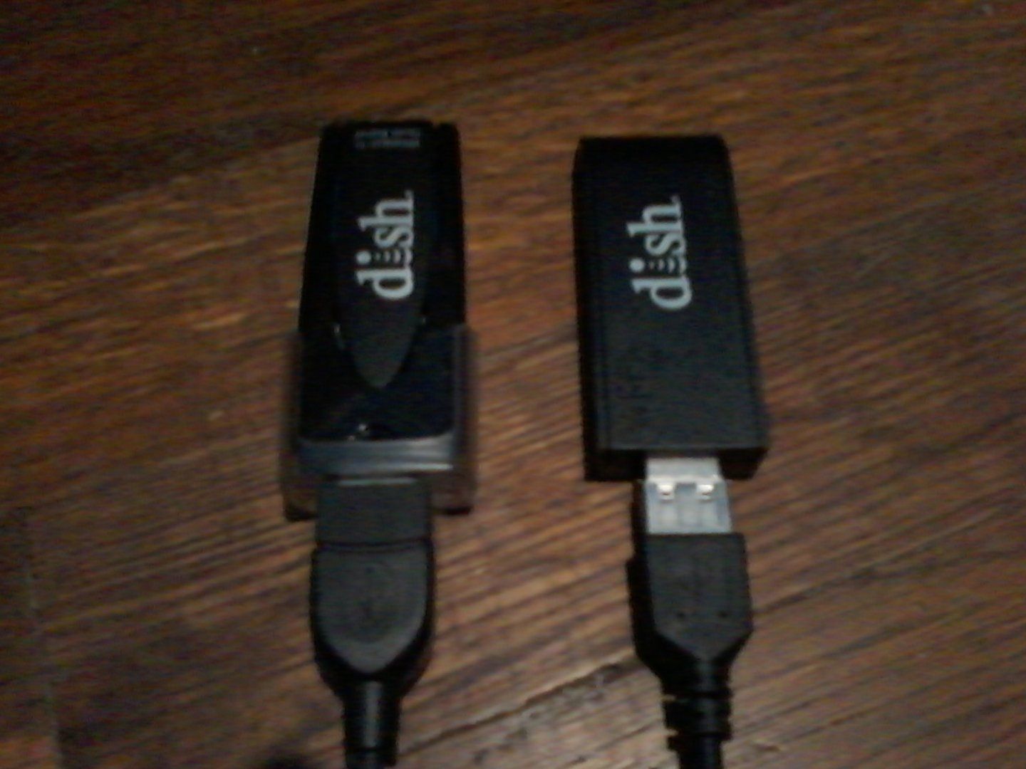

If anyone wants one of those wireless USB adapters, I still have several of them, that I listed in the Classifieds section here. I cut way back on the number of Dish receivers that I have, so I have no real use for them. I am willing to let them go, cheap! Basically, just pay for the shipping, and I'll send you one, while supplies last, first come first served.

Pictures of the wireless adapters:

Can the adapter turn a wired Joey into a wireless Joey?
I have never done that myself. (I only used the wireless adapters for Wally.) It was posted earlier in the thread that it would work to make the Joey wireless, though.
Just get the Dish wireless usb adapter and you can use it on any Joey. We bought the adapter back when the Hopper and Joeys came out and wanted to move a Joey to the basement which didn't have a coax outlet. It works great!
I was curious to find out if that would work, which is why I made the offer to give away some of my wireless adapters. I was hoping that someone would try that, and report back here with the results. (Not that I have any reason to doubt Crickee, but it is always a good idea to get confirmation from more than one person.)

I have tested...
50ft one end of house to other end of house through walls,
Joey2 connected wifi adapter,
Disconnected coax,
Reboot joey2 and hopper3,
Hopper3 found joey2 on home router network.
Joey2 worked connected via wifi adapter.
This was done for testing/curiosity.
The joey2 was a bit slower responding to remote/commands.
I did not test over an extended time.
This method is not supported by Dish.

Thanks crodrules! I received the wireless adapter and plugged it into a WIRED Joey. Setup was thankfully super simple - literally plugged in and it did the rest. Speed seems slower than the native wireless Joey, but this unit is further from the Hopper and router. Most importantly I have TV in the bedroom again!
