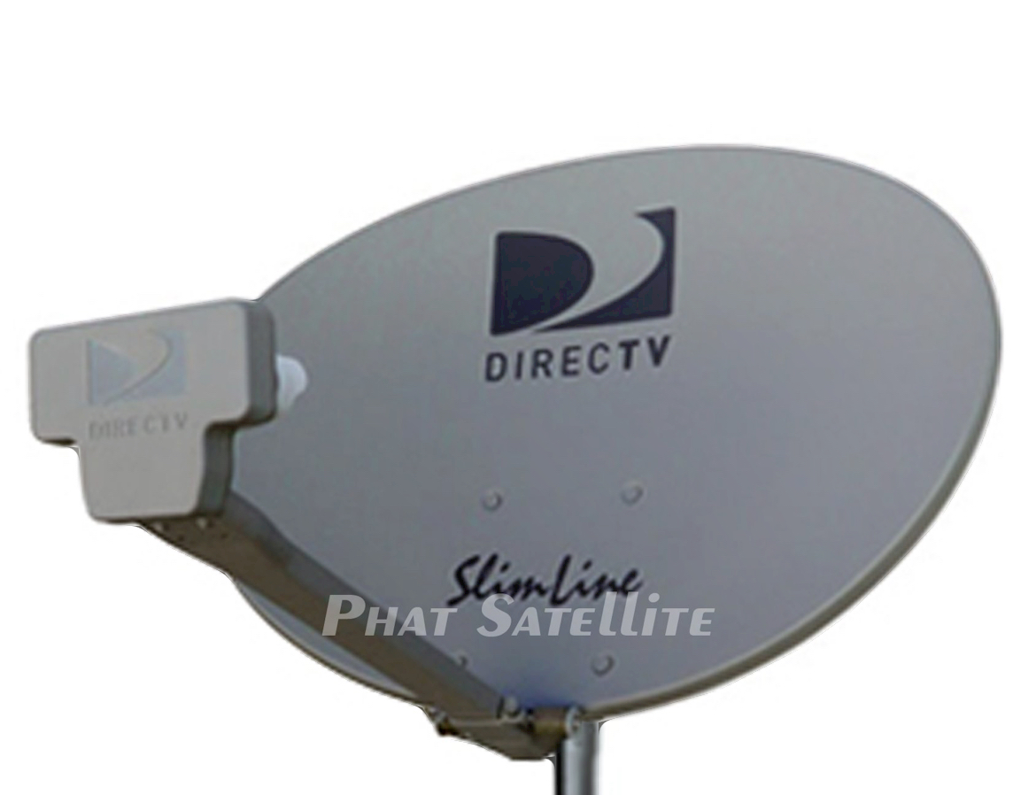

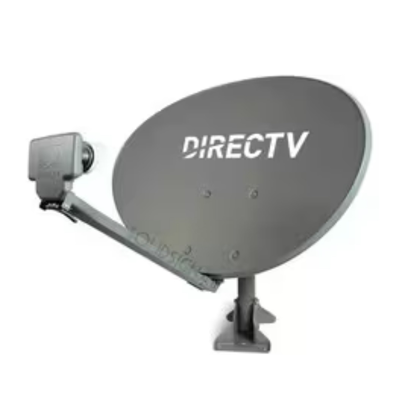

I want to get some FTA channels out at my camp because I stopped using Directv a little while back. I currently just have like 10 OTA antenna channels but I see there are lots of FTA satellite channels out there. I have a very old sat dish from like 2007 or something and a newer oval one from around 2018. I also have a old DIRECTV R15 Receiver and a Directv Gemini receiver that I'd prefer not to use because I lost the remote. I'd honestly be happy with even 1 new channel off Galaxy 19 or a different one. According to my research I should be able to use the new satellite dish with the R15 and still get some of the MPEG-2 channels. Should I spend my time setting this up or no?

You may need a new LNB to mount at the focal point of your dish. Can you post photos of the dishes you have?
Re: I know I'll need new lnbs for all of them, I'm wondering how many channels I'll get now. I also have a few old small circular dishes but they're pretty rusty and I think they're to small for anything.

If your dish antenna looks like the ones in the photos above (DirecTV Slimline or the 5LNB cluster), I have had good luck with those. I currently have one of each pointed at 87W and 129W. Replaced the stock LNBF assembly with a linear by drilling a hole in the appropriate spot and adding one of Hyper Casey 's LNB holders with a linear LNBF. I did have another of them for a couple of days in the front yard* on a temp mount pointed at 67W, with a DishPro tacked to the side for 77W.
If you can find locally an old SuperDish, or even better HughesNet, those work great too. I have one of the Hughes dishes pointed at 97W, with additional LNBs for 101W and 105W.
For multiple dishes, you'll want to look into DiSEqC 4x1 or 8x1 switches, and there are more complicated ways if you want multiple dishes and multiple receivers. But sounds like you'll be happy with one dish into one receiver at least until the bug bites you.
* until Mrs Pepper said no dish antennas in the front yard!
Those dishes should be ok for most Ku signals as long as you don't mind losing them during heavy rain/snow. They might be a tad too small for weaker signals like Montana PBS on 99W or LPB on 87W, depending on your location. But once you get a new LNBF mounted, they are definitely worth a try. They would probably work fine for the NHK multiplex on 101W, maybe for the PBS multiplex on 99W, and 97W
Have fun!
