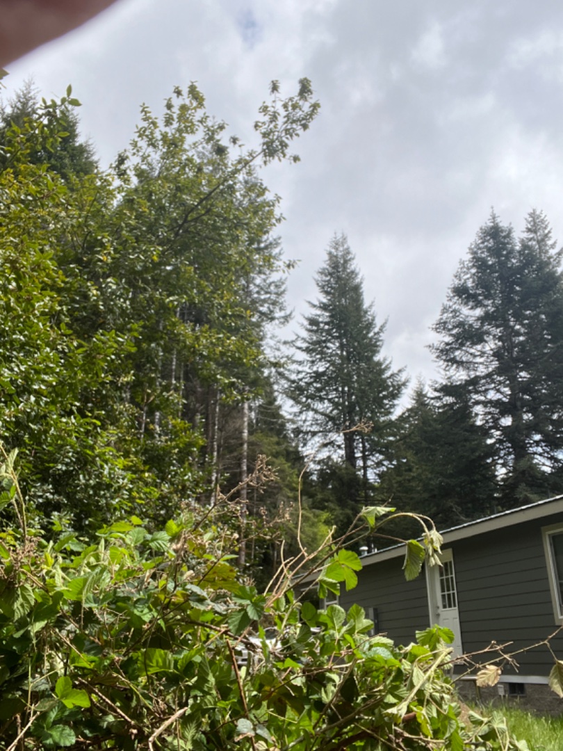

I'll have to measure the stroke length I'd want. I can measure the range between the extremes but I don't think there's much chance of getting signal at the extremes. I'm on the west side of a hill so my view to the east is limited and there's forest to the west.
When I get set up to actually receive signals I can decide what stroke length would be appropriate.

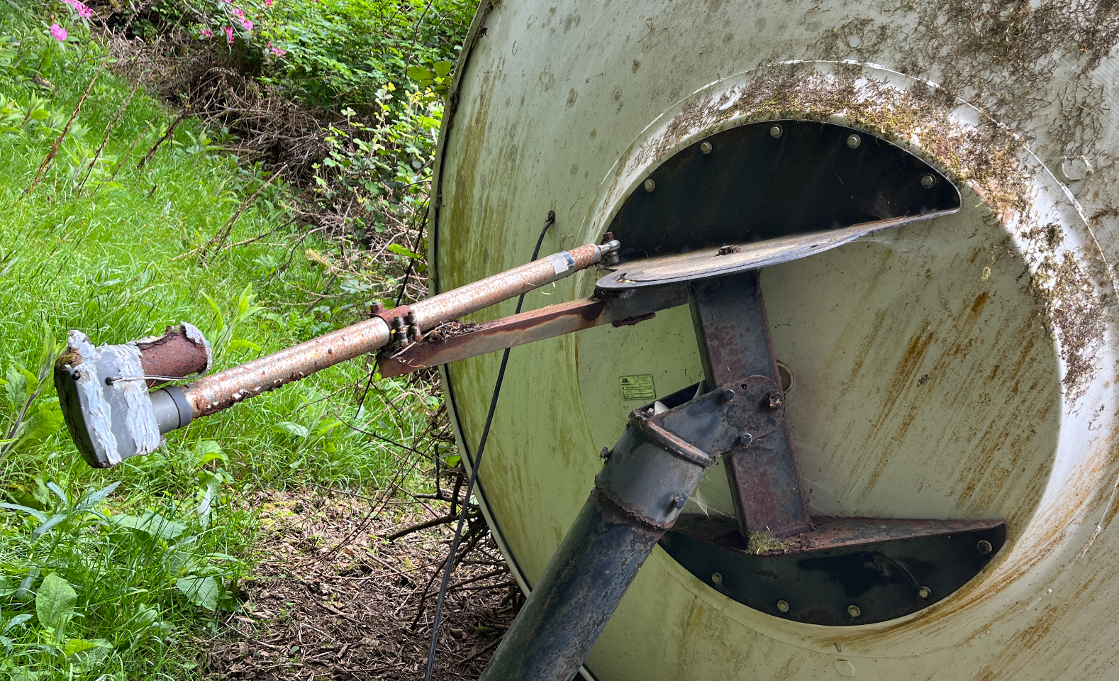

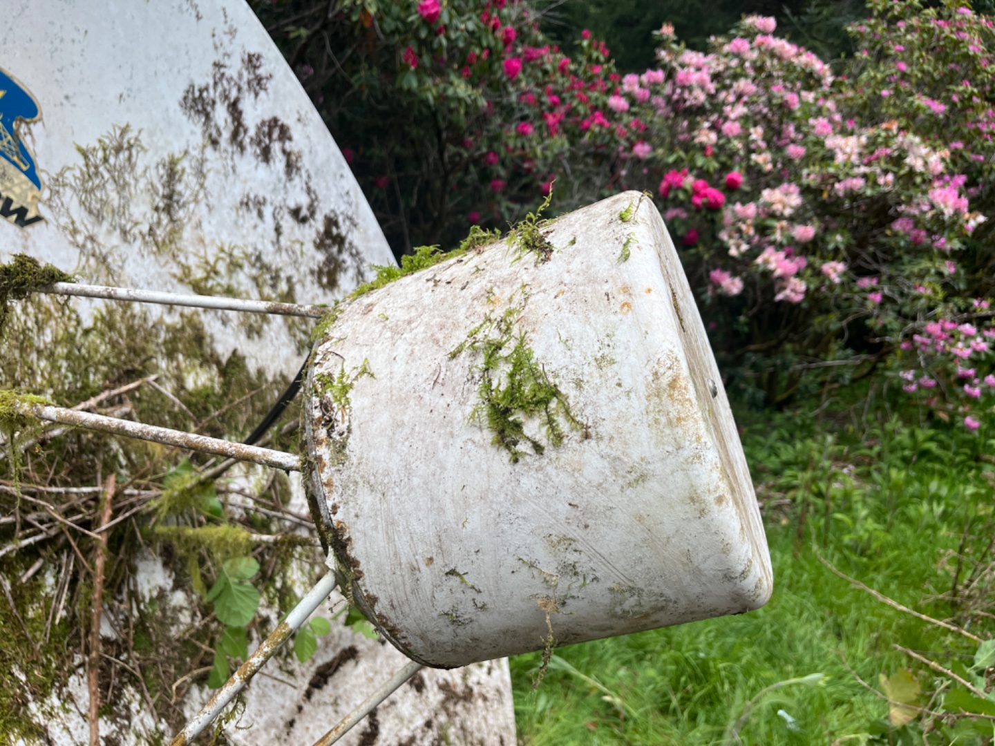

Arlo, I'll take what you've said under advisement but, unless I can get the original actuator arm to move, the gear box and motor aren't going to be usable anyway. I don't see any possibility of getting the arm disassembled without getting it to work first. The coupler that the motor drove is a rod with a slotted end. I can get the claw of a claw hammer into the slot which gives me leverage to try to turn it. It turns about 15 degrees but there's no change in the extension of the telescoping tubes.
Whatever the mechanical arrangement is within the two telescoping tubes it seems to be permanently hidden away unless the penetrating oil frees it up enough to let the slotted rod turn. I've used up the two old spray cans I had on hand and just bought another (B'laster) but I'm afraid it's going to be a waste of money.

I'm officially giving up on the old actuator arm. I can now turn the coupler almost 180 degrees with no change in the extension of the arm. If it did move it seems like it would now have so much gear lash that it couldn't be numerically controlled -- plus, the lubricant sprays smell bad and I'm tired of that.

yeah that does sound like the arm itself is badly damaged (probably stripped screw). Not something that can be easily fixed.
might be worth keeping an eye on Facebook marketplace and Craigslist for anyone getting rid of an old C-band dish in your area, with some luck you'll find one with an old VonWeise or similar good quality actuator that is still in useable shape.

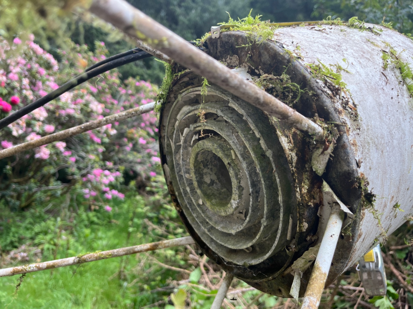

It's been a while but I'm finally getting around to my old birdview again. I'm going ahead with 3d printing an adaptor to bolt to the old scalar. It'll be a hollow cylinder with a holed flange.
I have a Titanium C140 feed horn. How tall should I make the cylinder so I have appropriate room for adjustment?
Well, I've left my Birdview resurrection project aside for a few months but now I've decided to go ahead with 3d printing an adaptor to connect my Titanium C140 feedhorn to the old scalar.
It will look something like a top hat with four bolt holes in the brim and no top, i.e., a cylinder with a holed flange.
Can anyone please advise me as to how tall the cylinder should be to allow enough adjustment?
