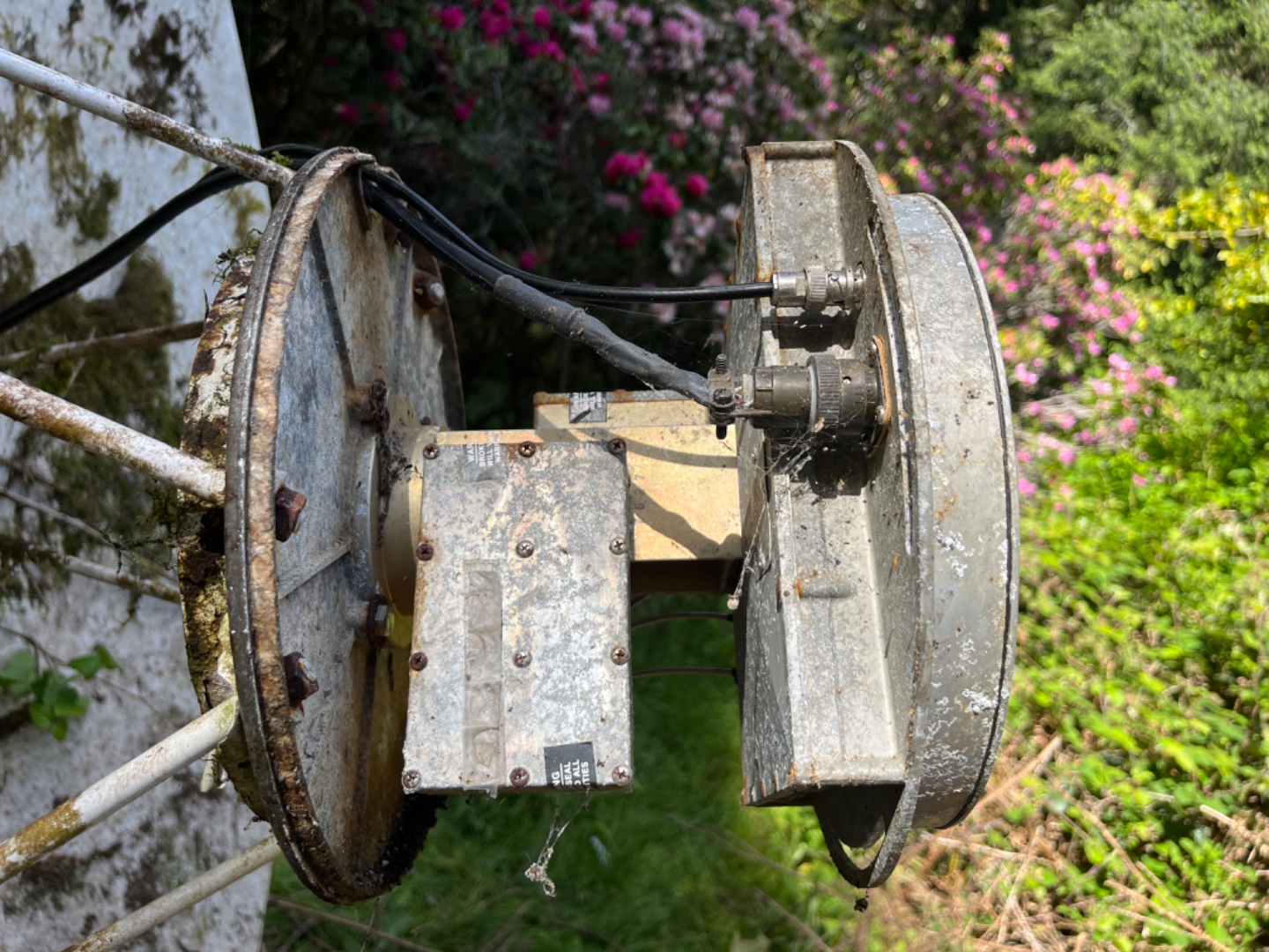

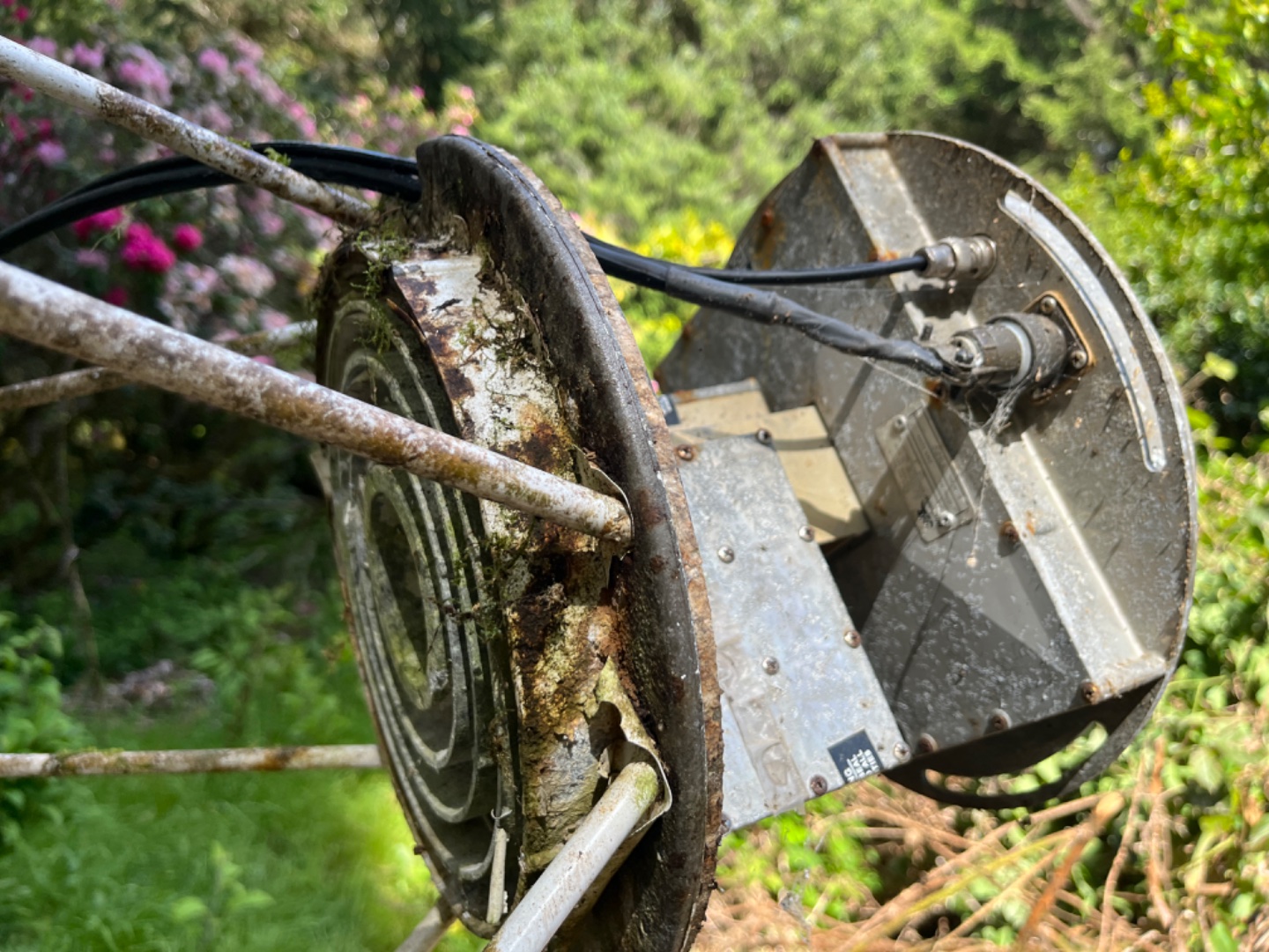

Removing the feed horn cover is very simple. Merely remove the center screw and pull it off…. Not. 45 years of entropy has left it very comfortable where it is. Should I spray it with something?
This is a lot more fun than the stuff I should be doing,
In the apparently unlikely case someone finds this when googling how to remove the cover - I sprayed it with wd-40, let it sit for a few hours and then hammered the tip of a thin flat screwdriver into the gap and twisted. The gap opened up a little so I went around the circumference inserting and twisting the screwdriver until the gap was about an eighth inch all around. Then I could pull the cover off by hand.
I had previously tried hitting it with a rubber hammer; this was ineffective and dented the cover. IMG_0370.jpegIMG_0369.jpeg
Your dish has great potential, but will require some modifications to accomodate changes in technology and usage since it was manufactured 40+ years ago.
As I suspected, this is an original Birdview LNA type feed. This type of feed is no longer in use and unsupported by receivers in use today. I would remove the feed hardware and only reuse the scalar. Clean and renew the scalar then hone the opening to accept a new larger LNBF throat diameter.

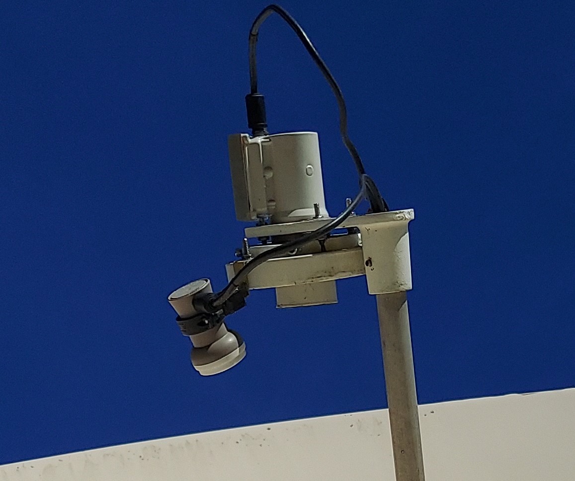

I have a motorized 8.5' BirdView. It's my second one.
Am currently using it for KU band. I made a circular holder for a KU LNBF out of 1/2" expanded PVC (See photo). I also made a circular LNBF plate with two holes for dual KU / C-Band operation, but am not currently using it.
Mine came without feed support rods, so I had to make those out of threaded rods from the hardware store.
I would be happy to provide any construction details if you would like.
Brett
I had previously tried hitting it with a rubber hammer; this was ineffective and dented the cover.View attachment 181615View attachment 181617
Haven't seen one like that. That's a whole can of worms going on there.
The scalar is the plate with concentric rings (aka "scalar rings"). I remember way back an explanation for how they work, like they're bouncing signal back into the dish to be better focused on the center/waveguide. The waveguide is the round tube at center of scalar rings. The rectangular fittings for LNBs can also be referred to as waveguides. Basically it's anything that conducts the signal in air.
Brett
Brett,
Do you not have a scalar?
The pic may look like no scalar rings, but Ku-only feeds (and waveguides) are much smaller than C-band or C-Ku feeds. So there's likely a mini scalar there.
