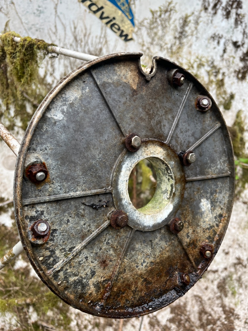

Here's a photo of the scalar without the feed horn, etc.
We can see that the six legs of the support arms pass through and are fastened with nuts. The unthreaded rods on the back of the scalar are a bit bigger so there's only the nuts in front.
The four bolts in the center just clamped the old feed horn in place. IMG_0372.jpeg
https://www.satelliteguys.us/xen/attachments/04-scalar-adapter-jpg.69400/ Shows how Pendragon proceeded (in the thread that I was directed to earlier)
He ground off the ridges in the scalar and attached a cannibalised part from a modern assembly (after reaming the old scalar and extending the mounting arms) which allowed him to mount the modern LNBF in the conventional manner.

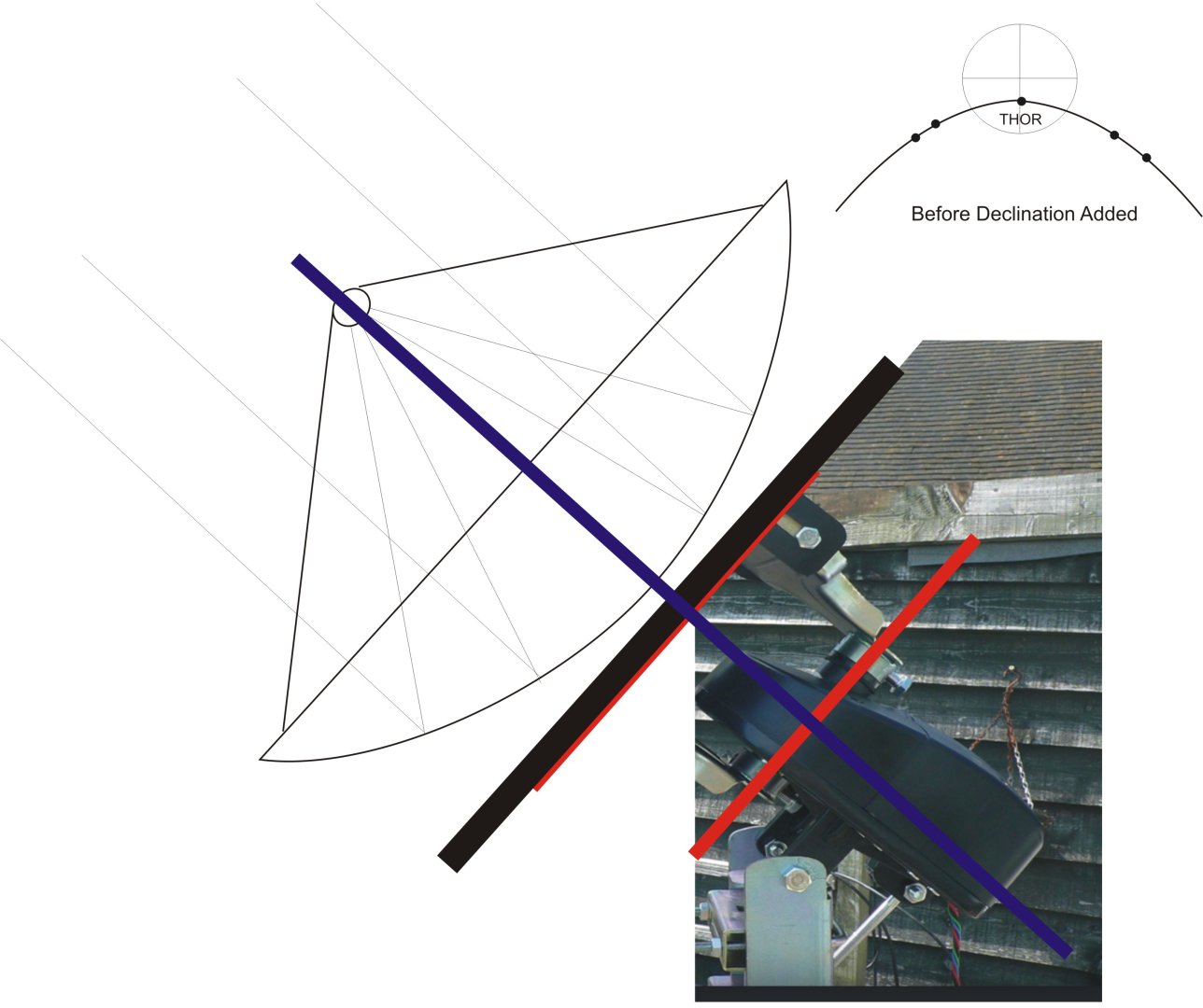

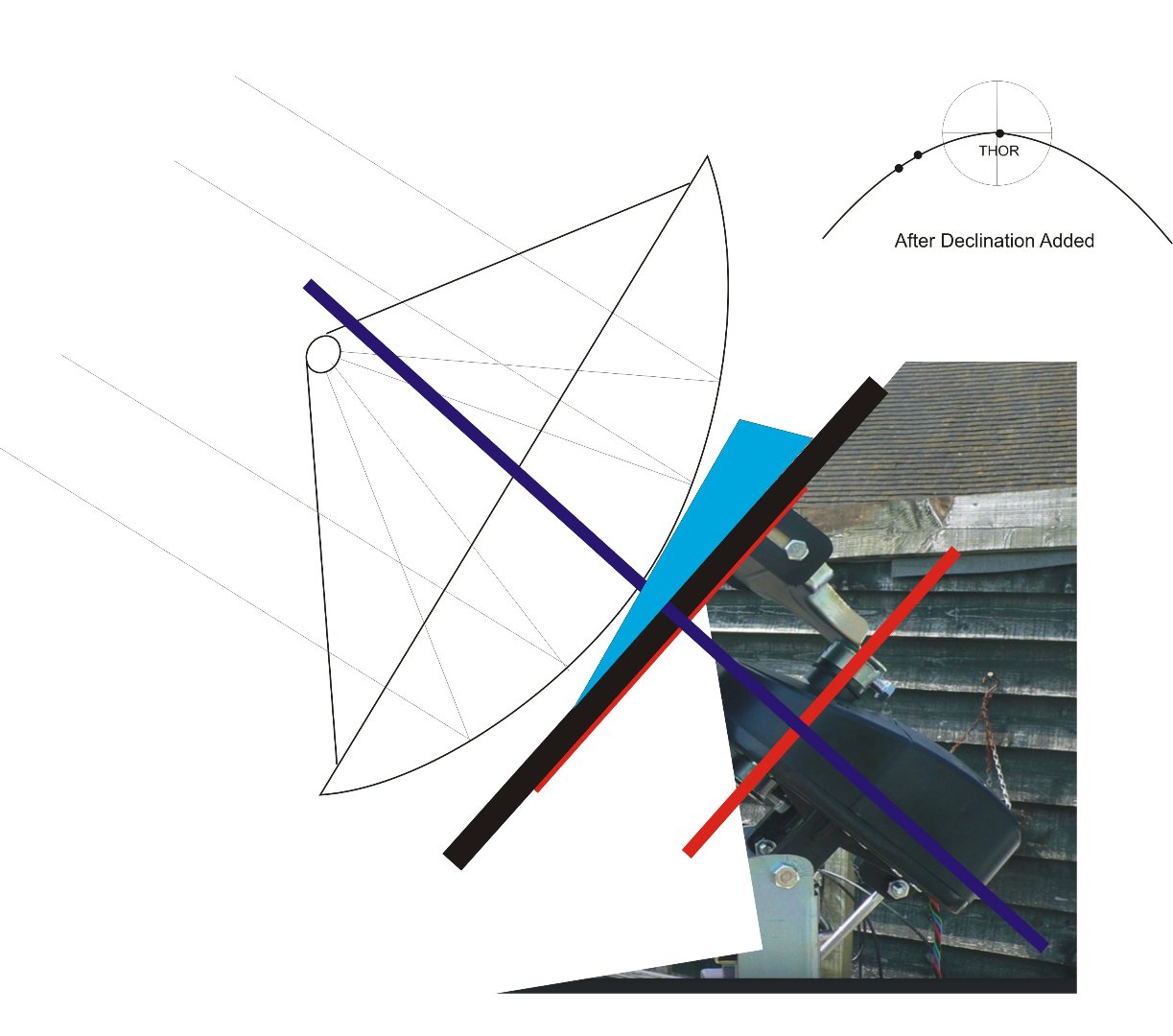

W/O going on a tangent. Declination is simply tilting the dish only after the polar angle is set properly and accurately. With the face of the dish parallel vertically with the polar angle. The pivots of the dish. If left that way. The dish will be shooting out in space over the equator.
Satellites are over the equator. So, you lower just the dish several degrees from tables, online setup aids.

I wouldn't drill a ku scalar to fit the O.D. of a c band lnbf. Scalars are not expensive for ones that will work. Besides microwaves not liking things not dimensionally correct. Your pics lead me to believe that the lnbf is not movable in and out/CW & CCW separate from the scalar.
For c band you will definitely need that. A c band scalar will have 3 bolts to fix the lnbf where it peaks signal the best.

Declination setting is only required if the dish will be motorized to move more than 20 degrees between adjacent satellites. Without declination setting the mount will not accurately track the arc.
Also, no need to change the leg length or scalar position for optimal FD/FL if you only wish to experiment to see if you can receive some programming from a satellite. Simply enlarge the feedhorn opening in the existing scalar to accept a standard feed diameter and fabricate a way to secure the new LNBF in the scalar opening.
In the future, if you wish to motorize the dish to move between more than a few adjacent satellites and optimize reception, then add declination setting to the mount and optimize the FD and FL by lenthening the support arms.

Declination may indeed not be an issue for a small sweep. I'm thinking for the maximum receivable signal if the dish is not going to be stationary, a well thought out method to to do it right at the get go would be appropriate.
Anyhow:

I seem to remember filing this opening larger to switch to a Chapparal C-band feed.
Here's how I enlarged the opening in a BV scalar with stuff I had in my shop.
Reactions: osu1991
Simply a large round file, worked all around the opening, should take that material down pretty quickly

I measured the hole in my scalar to be just shy of 64mm.
The C140 feed OD is approx. 66mm. Scalar ID openings are typically 68mm. The original BV Scalar opening was specific to their custom feed assembly and had to be enlarged to accept any other manufacturers feed. Common retrofit in the 80's and 90's.
I recall many "innovative" methods to secure the feed into the scalar, ranging from electrical tape, hose clamps and even JB Weld! :oops: NOOOOOO!
I'm going to look around for a more reliable method of enlarging the hole in the scalar. I'd rather not take a chance on doing a bad job that would bother me to look at in the future, so no filing, etc. I'll wait til I have the new LNBF before I proceed. I have my own antique CNC milling machine. Maybe I should wait til I get it moved and set up.
