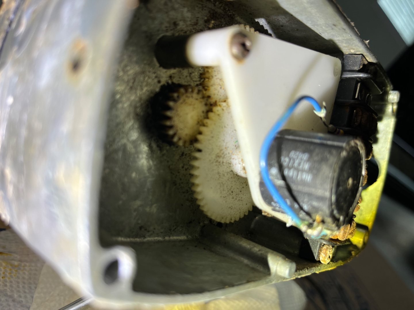

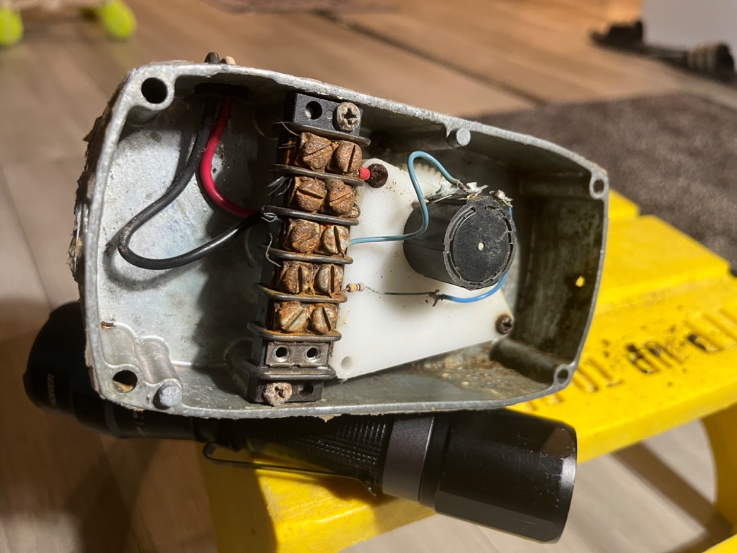

I'm back sooner than I had anticipated. Here's a picture of the gear box. It has a helipot precision potentiometer and plastic (nylon?) gears. I expected metal.
I
There's still the other half of the box yet to be opened.View attachment 181943
Like the rest of the hardware on the Birdview, welcome to "old school", original install, components from the 1980's.
Do you still have the original positioner controller to power and move the motor? You could upgrade the multi-turn potentiometer to either an optical sensor or reed switch, but really the 1st question is how you plan on controlling the dish position?
Reactions: phlatwound
That's normal, those used nylon gears. Probably a 10k 10-turn pot. Not worth trying to convert to reed switch.

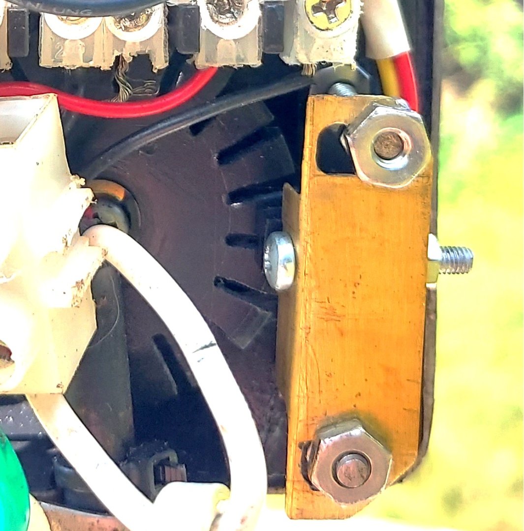

That looks nice. What is that sensor, exactly?

Whereas a pulse generator like a reed switch with sector magnet triggers, hall devices with magnet wheel. Or like I'm using, an optical interrupter with slotted wheel. I believe the successor to potentiometer type feedback.

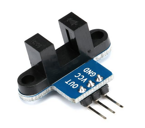

The Amazon Arduino kits can even be found with interrupter wheels. For a few bucks. All you would need to do it pull the potentiometer from your gearbox. Fashion up a way to mount the optical wheel. Build a bracket to mount an optical switch. And providing you have a 3 wire cable for the sensor at the motor and inside. The rest is easy. Maybe dig up an old wall wart charger to give the optical sensor juice.

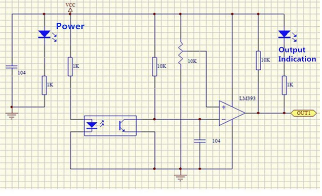

And looking at the schematic from one of the Amazon kits. Know anything about electronics? Well, take a peek.
In it's current configuration, OUT and ground provide a voltage that comes from Vcc when the sensor is (thinking) unblocked.

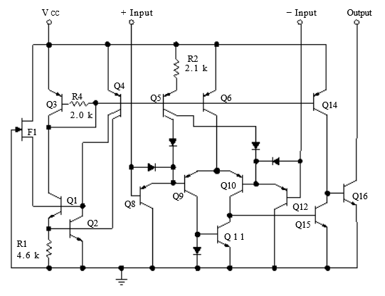

Kind of cool. But pay attention to the LM393 comparator on the optical module. Next image.
On the sensor module is the LM393 comparator IC. And it's configured as a current source. Beam is unblocked, the LED lights and voltage appears between the Out and ground (pretty sure....need more coffee. Anyway).
Below, look at Q16. Internal to the IC. Q16 is your switch. Reed switch contacts if you had one in the gearcase.
Optical wheel spinning turns the switch on and off.
Now. There are several ways to make this work. Easily. My configuration is a bit different. Uses an external solid state relay.
In the simplest form. You get the thing working in your gearcase. And snip the 10k and possibly the 1k resistors by the LED indicator.
And test with a multimeter.
No new actuator. No hunting for the right magnet. No playing around with finding a sweet spot to put a reed sensor that may or may not play nice.
You slice that light beam. You get switching action. Every single time.
And it opens the possibility at a later time to add a vbox dish mover that interfaces with a receiver to move the dish when you change satellites on the receiver.

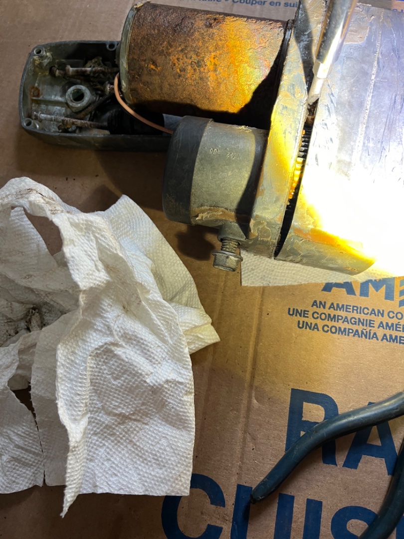

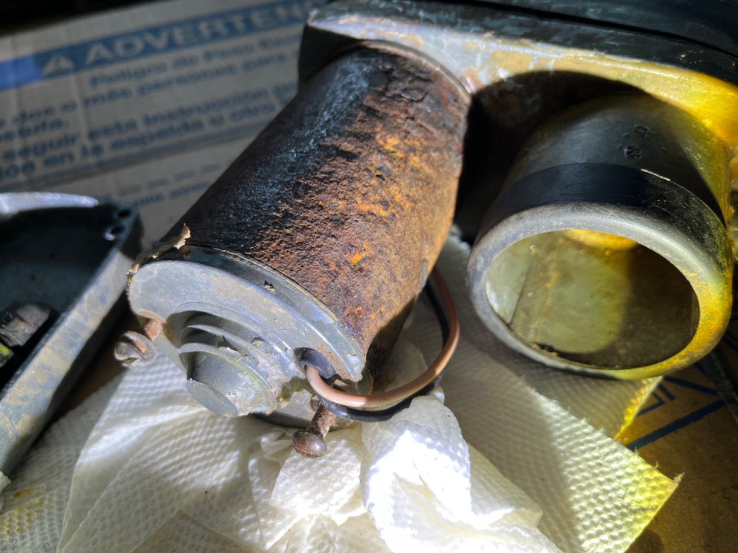

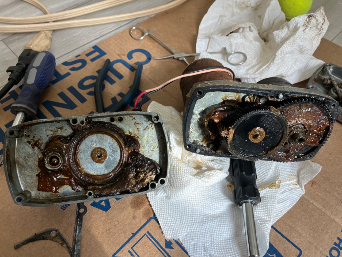

IMG_0407.jpegI removed two screws from inside the gearbox which allowed me to open the other half of the box just a little. Water poured out.
I don't know what is still holding it together. Am I going to have to remove the nylon gears? I removed the two long screws from the motor. Should the motor be free then? It's so rusty it's likely stuck but I don't want to try to force it if there's still something else to remove first.
I realize nobody is likely to have experience with this exact part but I would appreciate any feedback.IMG_0408.jpegIMG_0406.jpeg
I believe that is an Optical Interrupt sensor. Counts position by breaking light beam. Like the pot sensors, and also Hall-Effect sensors, a long-ago obsoleted use.

This arm is good for one thing only, maybe- if it doesn't have any free play it could serve to fix the dish on a desired position by extending/retracting the body of it through its mount bracket if the bolts can be loosened/tightened or replaced.
Whoa, Nelly! For satellite usage, the vbox variants are the only kid in town. Reed switch sensors might be used because it's cheap and simple. If water poured out of the gearbox. Sorry. Nothing short of a complete teardown would be my next step. Motor, gears.
Now. If that seems over your level of confidence. Looking for things like worn motor brushes, rust jacked magnets....the whole nine-yards.

Can the old actuator even be revived? Is the eons of water soaked potentiometer even good at all? An Ohms sweep measurement would be the first step. Would a person with a car that was in a flood hit the starter? I'd be zero without opening up the motor of that gearcase.
I'm thinking common sense here without tossing a coin and hooking it up to a battery with magic smoke as a result.
Know what I think? Because I did a similar thing. Get the thing working. Find out how fast the pot gear turns.
Use the gear teeth as the optical trigger. Paint the gear black. Try it. Bet you a buck it works.

Actuators aren't exactly cheap but a new or good used replacement is the only answer here (along with matching modern positioner) if wanting to motor. Not even just the most reasonable answer- virtually the only one.
Well, I got it free! That is, I can point the dish where I want. I disconnected the arm but it was still not clear that I'd get the dish moving since it was rusted in place but once it broke free I can move it pretty easily. The actuator arm can slide in its bracket too so I'll be able to use it to lock the dish down once aimed at a satellite.
I'm not giving up yet on getting the jack functional. I've got it upside down so I can put lots of lubricants in it to soak.
Reconditioning the gear box seems pretty trivial, if I could get it apart. I'm still hoping for some advice on how to do that. Replacing the motor doesn't seem like a problem; motors are pretty standardised.

The motor doesn't turn with 12 volts. I would have been much more surprised if it had. The rest of the gear box looks fine; the gears all turn and drive the coupler for the actuator arm.
However, as telstar suggested, the chances of getting the actuator arm moving seem pretty slim. That's ok, though. I'll be fine for now with one satellite at a time moving it by hand. There are actuator arms around for under a couple hundred bucks with the motor and feedback device. I don't know if what I'll need will be that cheap but I don't need to worry about yet.

I kind of told you not to even try to apply voltage to the motor without taking it apart.
You might be surprised that a little elbow grease and thought will make it work.
It's been in the weather for a billion years.
If you can't turn the bronze gear attached to the armature on the motor. Everything else is useless until you open it up.
