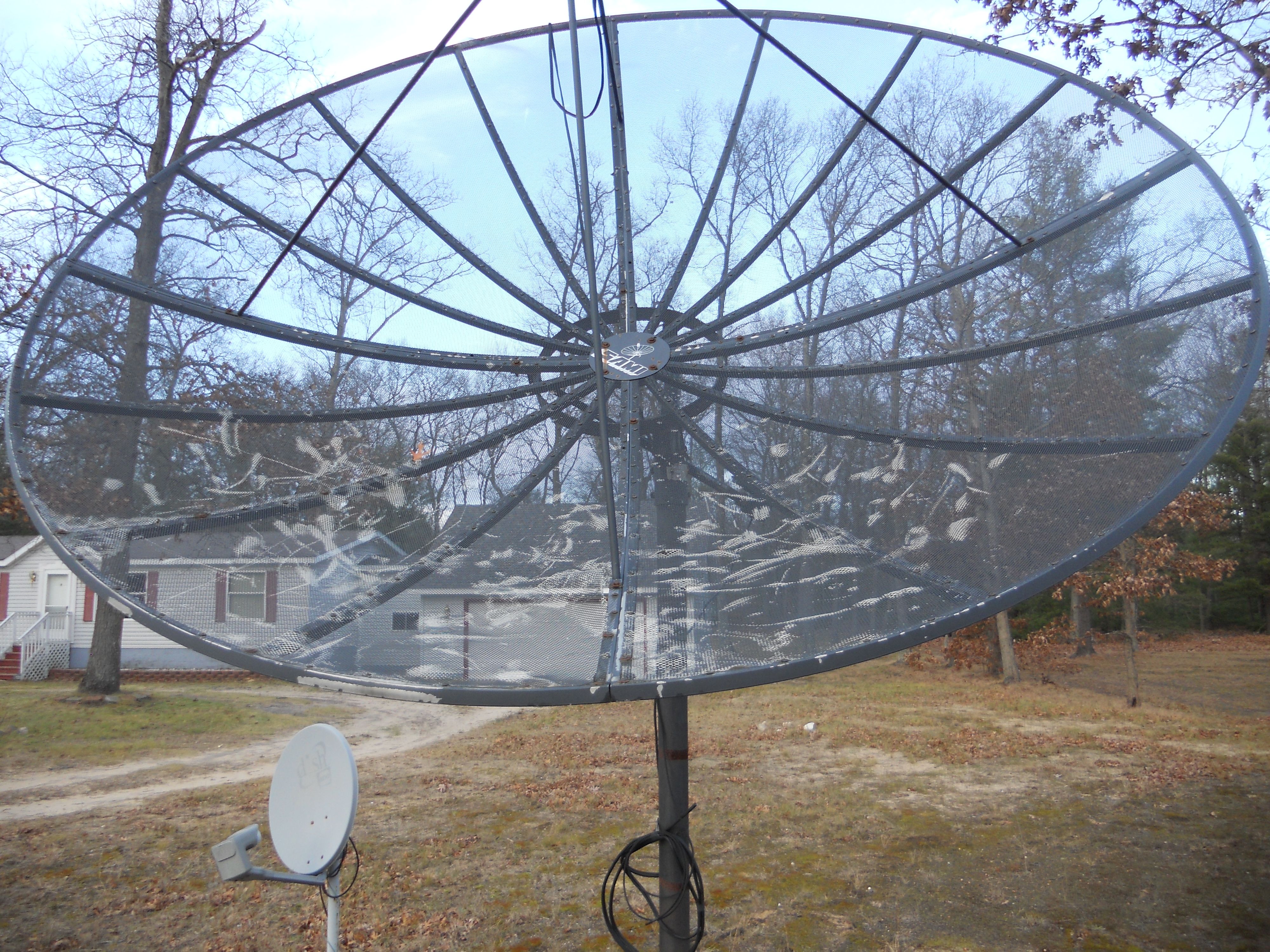

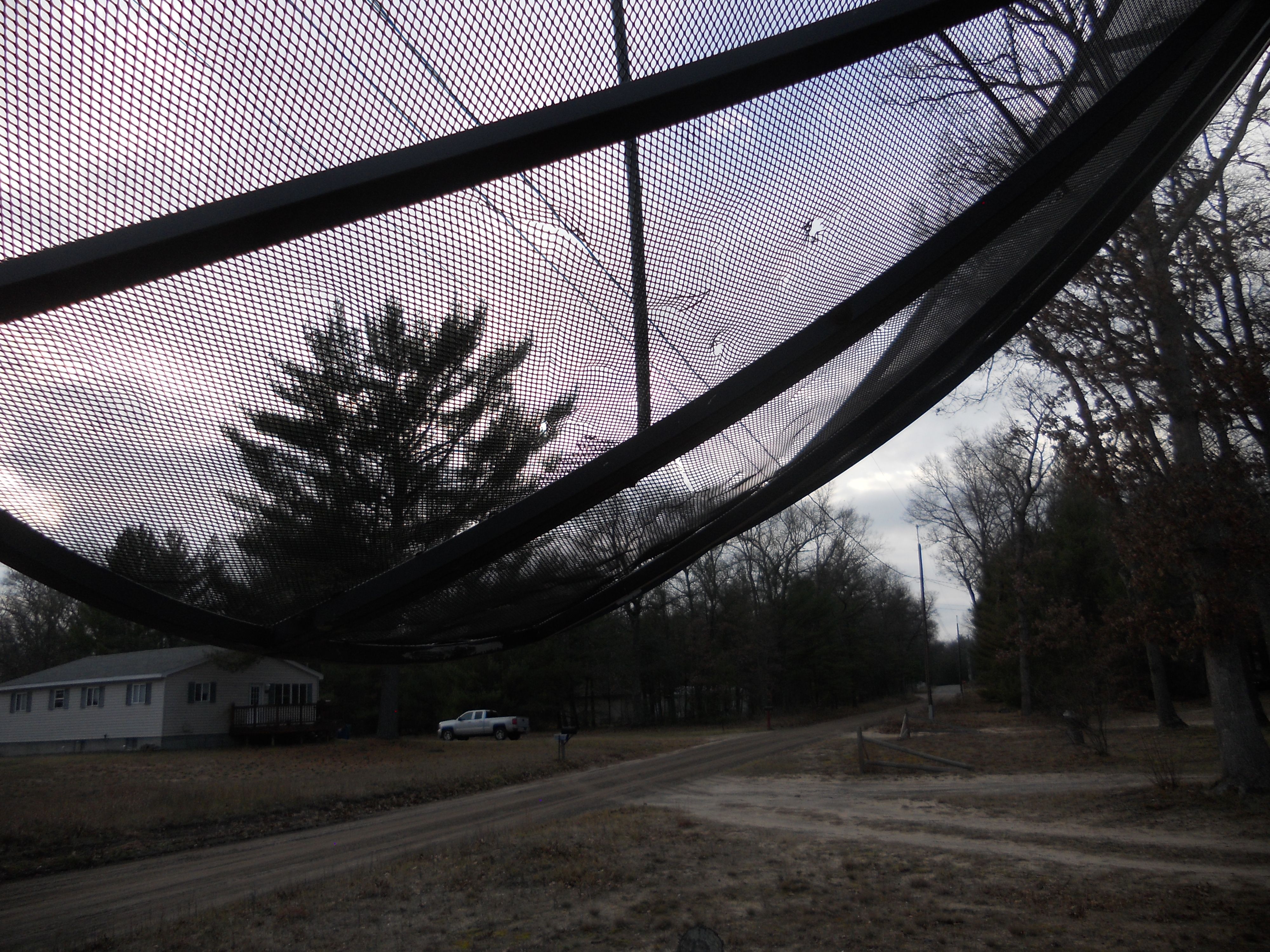

Today as I was driving home I glanced down a side street and just happened to see this dish right out in the front yard. As you can see, the lowermost five panels are badly damaged and what is worse, it looks like the damage was deliberate. It's not being used because the wires are going nowhere, so I'm tempted to walk up to the house and ask if they would like to have it removed from their front yard, but with all the damage I wonder if it would even be usable, or if there is some way to repair the damaged panels. I would not pay anything for a dish in this bad shape but if they were willing to give it to me, do you guys think it would even be worth taking, or would it be pretty useless with all that damage?

Unless the parabolic frame is out of whack that dish could be very functional, especially if it is a 10 footer.
My most-used BUD is not in a lot better shape than that one appears to be, and it works well.
I would grab it just for the pole, polar mount and actuator, if nothing else.
GO FOR IT BUBBA!
Those SAMI panels are screwed on and are very easy to remove. Take the damaged ones off one at a time and lay them down on a flat concrete garage floor then use a large rubber mallet to flatten them out again. I did that with that 7.5ft SAMI I had and it worked great. Worst case is you might have to replace a couple of them but I'd try to straighten them before I did that.
Yep, try to get it... Better for it to go to you than the metal scrapman.
Straighten the panels as Lone Gunman described; with the mesh flat on concrete, I've also used a piece of steel pipe as a rolling pin to get wrinkles and hail dents smoothed out.
As everyone else above has said, GET IT!
It looks very repairable. In fact, you would be surprised just how well it would work as is.
