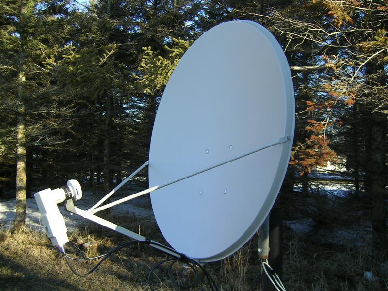

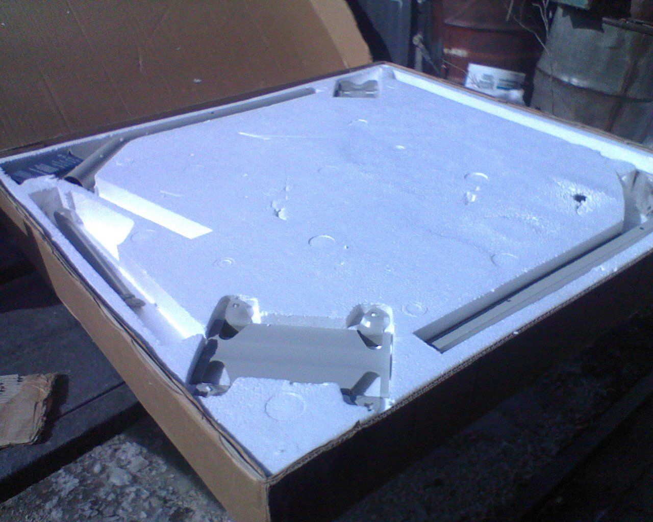

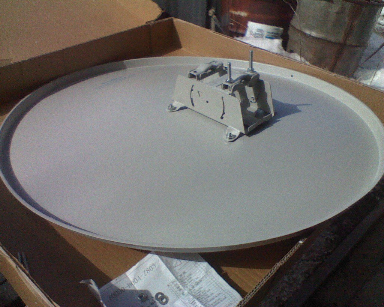

Just picked up a new WSI WS9036 and LNB from Galaxy Marketing and hoping to install it soon but I unpacked and assembled it right away. Good packaging seemed to hold up as the cardboard had seen quite a bit of abuse during shipping. There was one small scratch on the reflector edge that may have been from a packaging staple but otherwise the components were all there and look good. I should mention the order took about 5 days to arrive at the destination and ordering was very simple through the Galaxy Marketing website.
Assembly was easy and the assortment of bolts and nuts were well counted... no spare bolts, nuts, or washers. Nice cement anchor bolts provided however I do not require these. Instructions included is basically an exploded view showing the parts and a list of the various hardware fasteners, all numbered on the picture to correspond with the a chart. I have assembled many different dishes in the past and this one was not difficult at all. The size makes it a bit cumbersome to work with which is always an issue with larger dishes (comparing to DBS pizza plates etc). I am including a few pictures showing the package in various stages of assembly.

OK. Had a bit of spare time this afternoon and managed to change out the dish. Weather acceptable with even overcast and light north breeze, temp around 33F. Took about half an hour to switch things around... had trouble finding my special metric crescent wrench, guess I didn't put it back in the right place after last job.
I lined it up on G19 at 97W which is very close to due south for me. Used quality % readings only. I used the same LNB (QPH-031) with both so we are looking at apples to apples.. I did peak the 33" signals before switching. Installed on the SG2100 motor.
TPs used, digiwave 33", WS9036 Q readings (AzBox Ultra)
12153 H 20000, 71, 93
11929 V 21998, 76, 89
11842 H 21998, 74, 87
11836 V 20765, 66, 70
Over all a really nice improvement without a drastically larger dish. 125W HD channels are at least 10% stronger than before. I did not take readings on 125W before switching but I usually got 40-50% on one of the TPs, now it is in the 60% range.
One small omission I did notice was the lack of an elevation scale on the mounting bracket. I didn't notice this when I assembled the dish last week. Not a problem when one is used to installing satellite equipment but might be troublesome for someone who isn't experienced in the hobby.
Over all was easy to assemble and set up. Unit appears to function as advertised and is built reasonably well for it's price, and I am sure it was a worthwhile purchase.

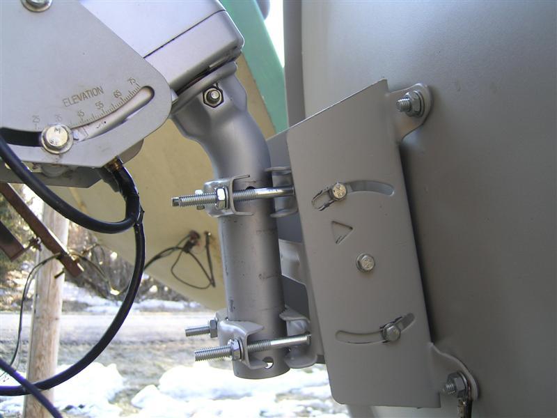

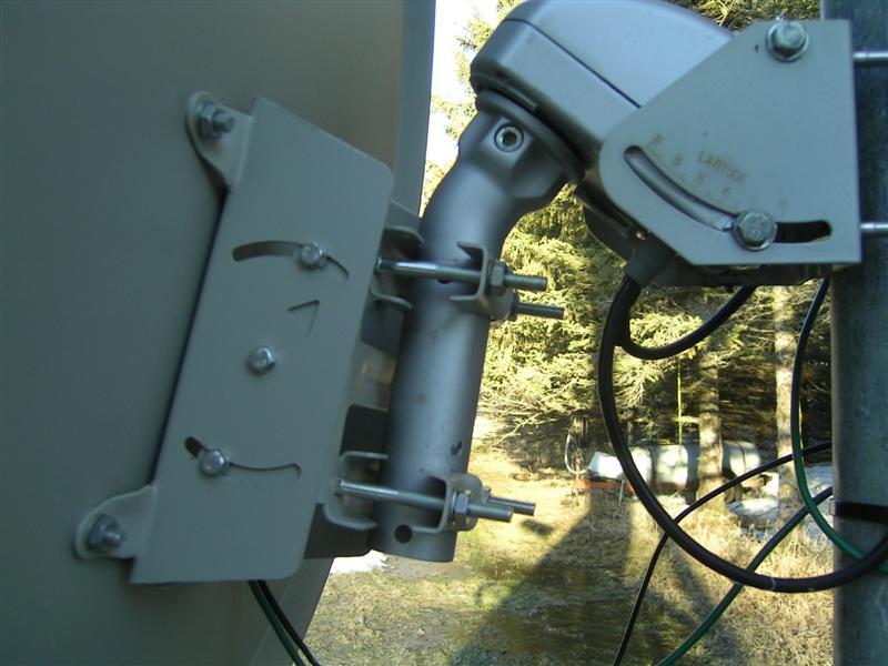

Would you please supply a closeup picture of the elevation adjustment on the bracket with the dish adjusted onto a given satellite? My friend who has no experience with FTA received this dish about 3 weeks ago and still hasn't found 1 satellite. A picture would give him a rough estimate as to how to adjust the elevation.
Popcorn, My dish is on a motor so the elevation will be off by what ever the declination angle (7 degrees I think) is. Will take a picture for you once the weather streightens up. Should have taken pictures when I installed it, was in a hurry and forgot to bring the camera.
The dish "appears" to have less offset than many I have installed in the past, so your friend might have to increase the elevation just a bit more than what might seem proper.
-C.
edit:
check this posting, the mount is very close except for the elevation adjustment screw:
http://www.satelliteguys.us/free-ai...eguys-special-satellite-av-geosatpro-1-a.html
This one might be set up closer to your latitude as well..

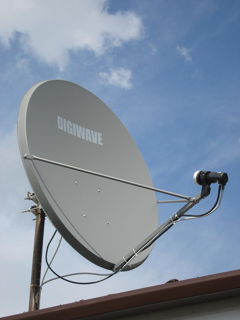

Mount & dish pictures
Think I did something wrong attaching these... doesn't look right but are visible. Hope they help.
-C.
Will the WS9036 fit on a 2 3/8" dia Pole? I am looking to replace my formal Starband dish which oval 36" but much smaller than the WS9036 which I am sure it will outperform.

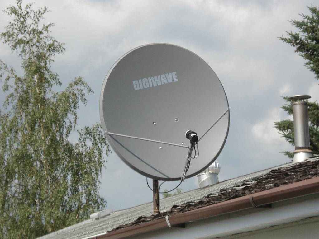

your dish looks just like mine... but mine is stamped "digiwave"...
Wonder who is copying who? Likely many different names printed on the same product. Likely works well too.
