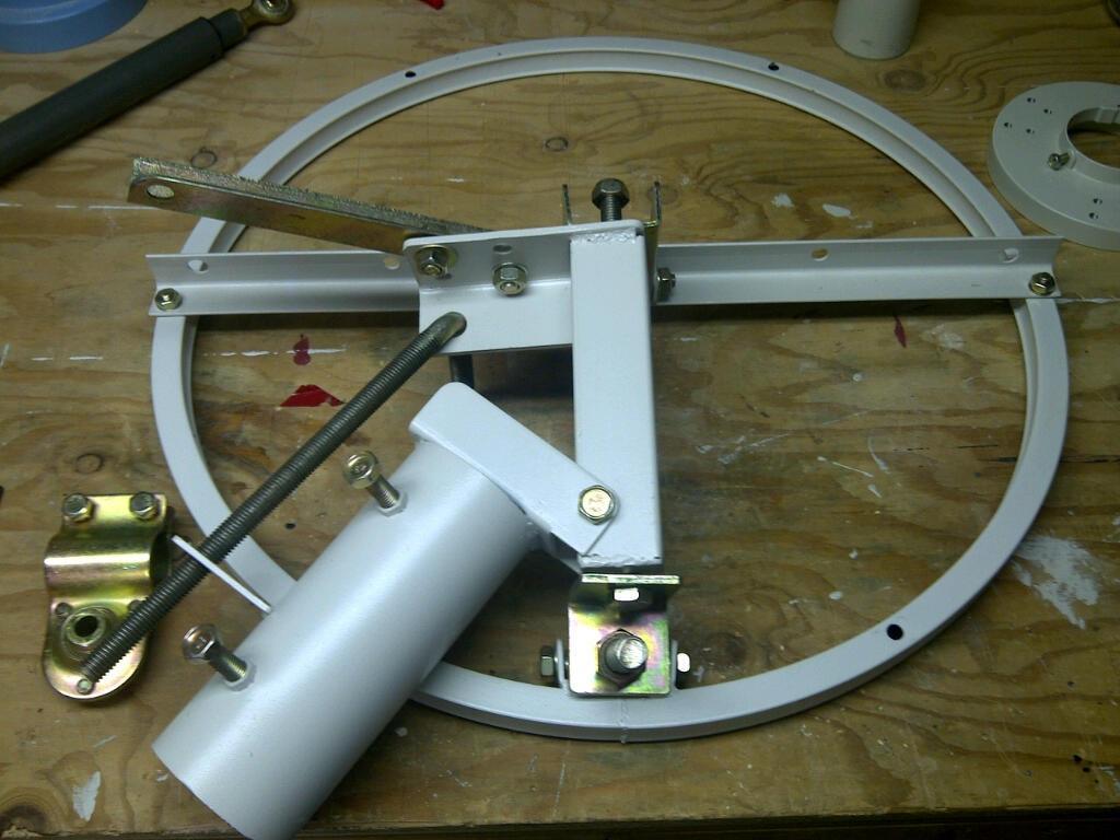

The temporary mount worked (signaled acquired from 99W). Now am putting this WSI polar mount together...Anyone w/ experience, how does the picture look? Needless to say the "instructions" were a real mind bender.
Cheers, K
Need to put a nut on that J bolt that adjusts and holds your elevation. One above and another below the plate it goes thru. Setting the declination angle now will/may be easier than when the dish is attached.
The 2 nuts that came w/ the kit are too big for the J bolt and Ive been to three hardware stores without success.
Cheers, K
Dunno. When I have time, I'll bring the J bolt to a few more stores and see if I can find something that fits. Other than this, how does the mount look?
Cheers, K
That's all I see that needs attention at this time.
