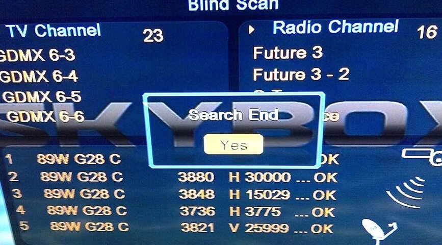

Success! Locked on to 99W. Lifted the dish by another 2 feet and voila! The allignment is still way off but now I have comfirmation it works so the next step it is a permanent install. Thanks all for your help! Now the fun begins by putting together this WSI polar mount without losing my mind.
Cheers, K
PS- When running a blind scan, i didnt know where I was so I selected 89w for the heck of it.
