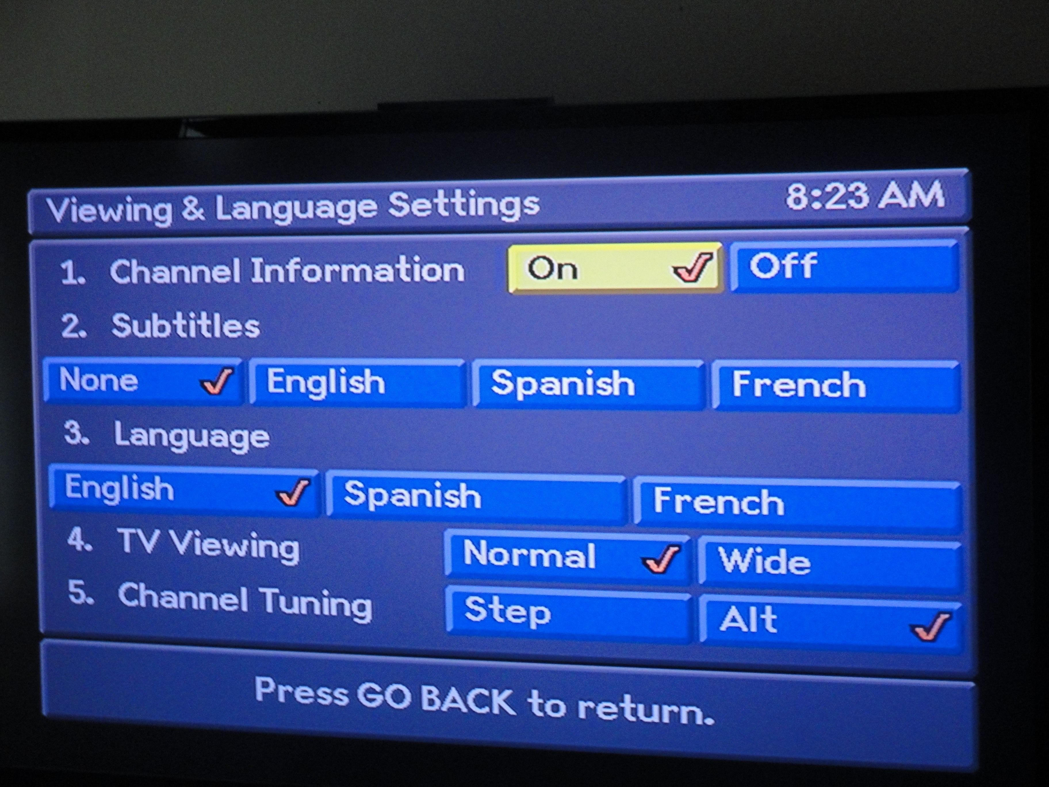

If you look in the first picture and at the bottom of the screen that was where the problem lied... alt channel tuning is the one that is easy on servo motors!
I don't remember doing that???? OPPPS!!!
I knew that was in there somewhere! :)
