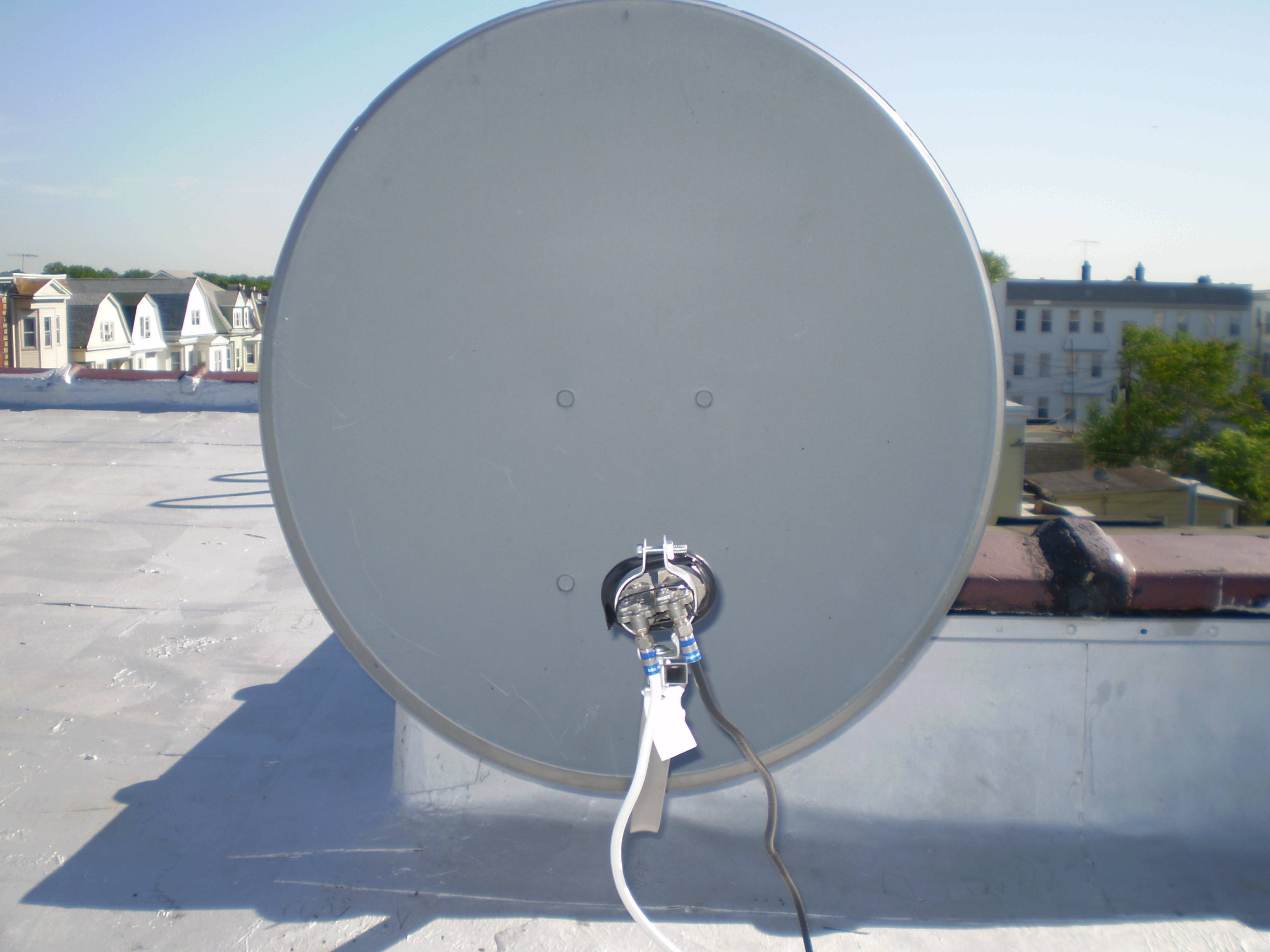

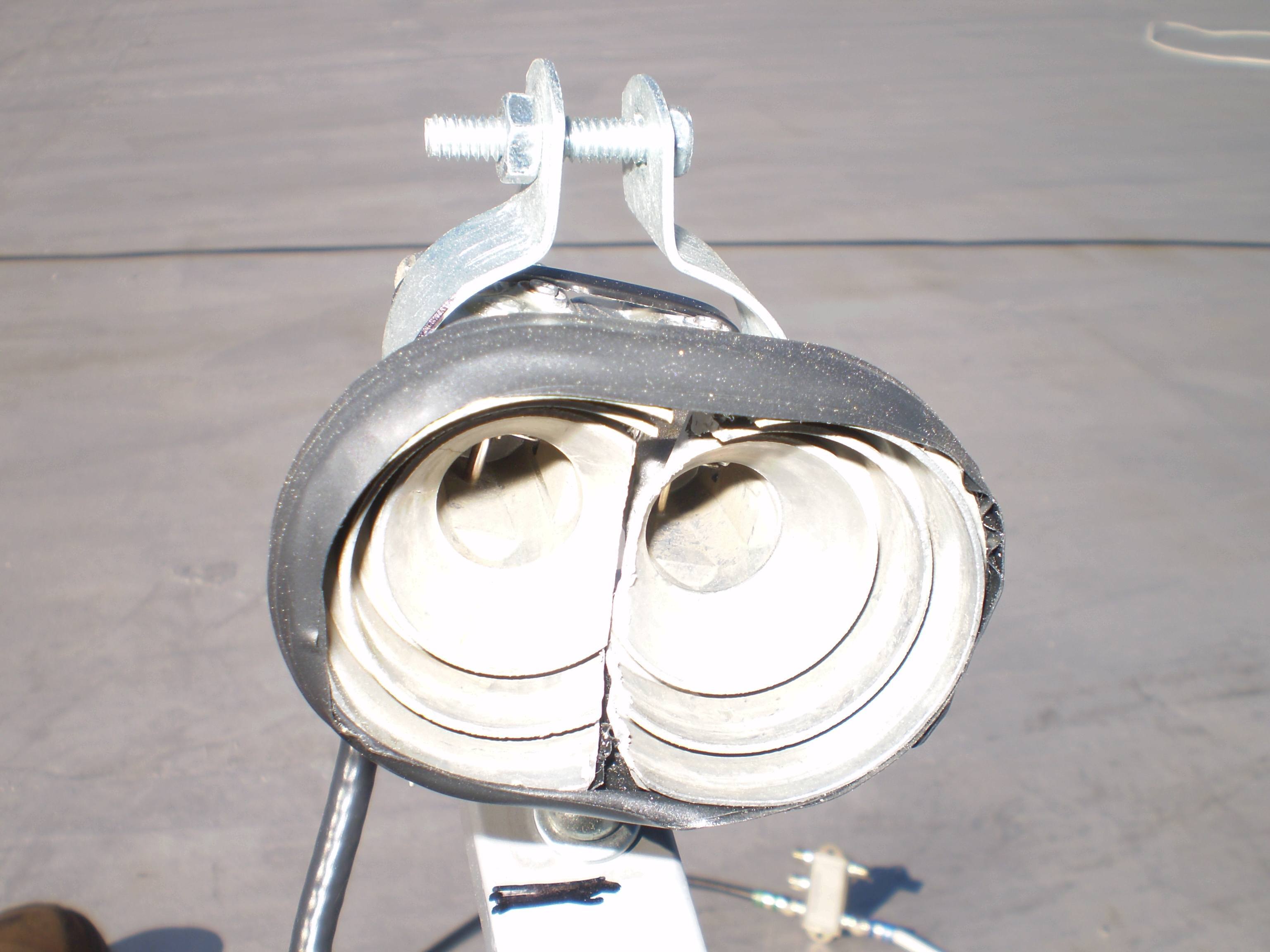

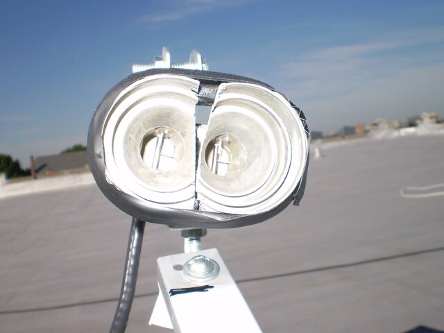

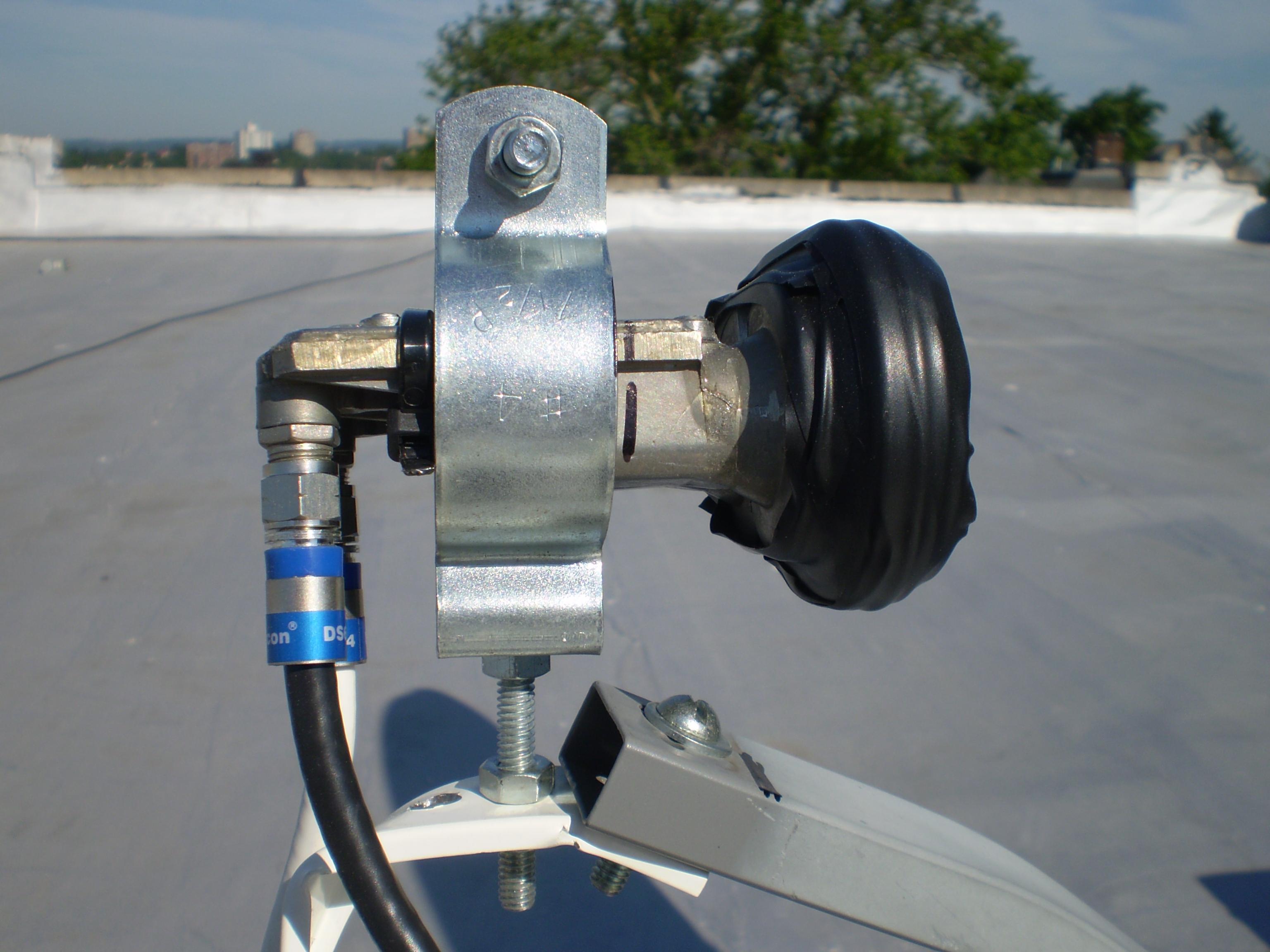

Guy here is the 2 degree lnb
hello ,
like i promise and really works. let me know guys if u like it.
well those lnb are standard but i used a table grinder to cut both lnb side to get close together to get the 2 degree. :):)

good job -
Probably should put some Saran Wrap over the front, to keep the bugs out. :D
So, which two birds? 123º/125º?
What dish is that?
I don't recognize the LNBs.
Where ya located? Makes a difference for LNB spacing.

Nice pictures finally, one thought tho. Electric tape with heat and rain will come lose and give you problems later on.

well the dish is Winegard 33x30,
lnb are standard dms international $ 15.00
the bracket i use u can buy in home depot # 4 (1 1/2)
the satellites the i got were ( 95,97) (97,99) those are the only ones.:):)
this was just a experiment, but works.
