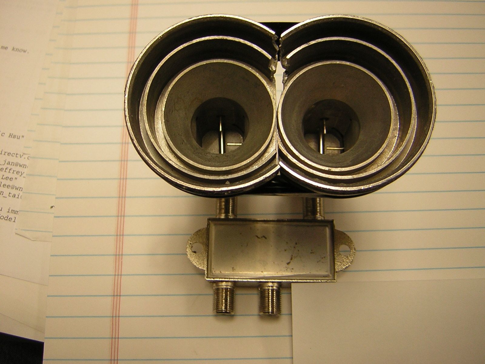

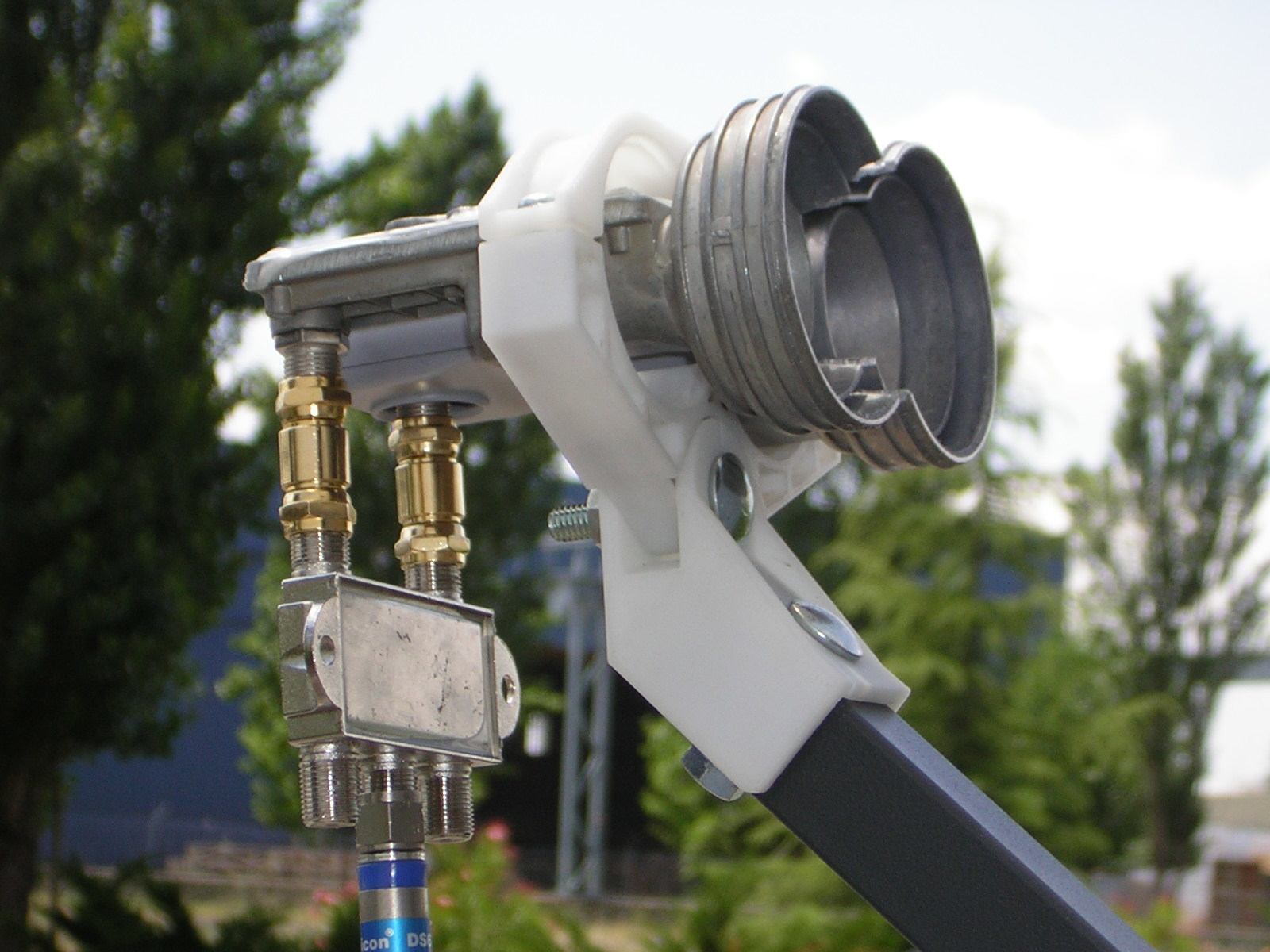

SatelliteAV SatelliteGuys Master Lifetime Supporter Sep 3, 2004 6,486 186 Roseville, CA May 28, 2009 #21 Reminds me of 4 degree experiments a few years ago developing a monoblock. Snipped / shaved the scalers and attached directly to a 4x1 DiSEqC. See pix below..... Attachments DSCN0747.JPG 212.4 KB · Views: 163 DSCN0771.JPG 172.4 KB · Views: 171
manuelpaz SatelliteGuys Pro Original poster Dec 31, 2008 198 0 usa May 29, 2009 #22 Brian. I like the pictures really nice, it was an experiment but really works, i'm happy
Cadsulfide SatelliteGuys Pro Sep 8, 2008 1,305 0 Cavalier, North Dakota May 29, 2009 #23 Manualpaz; Way cool setup! Brian; The 4 degree monoblock lnb never got developed I take it?

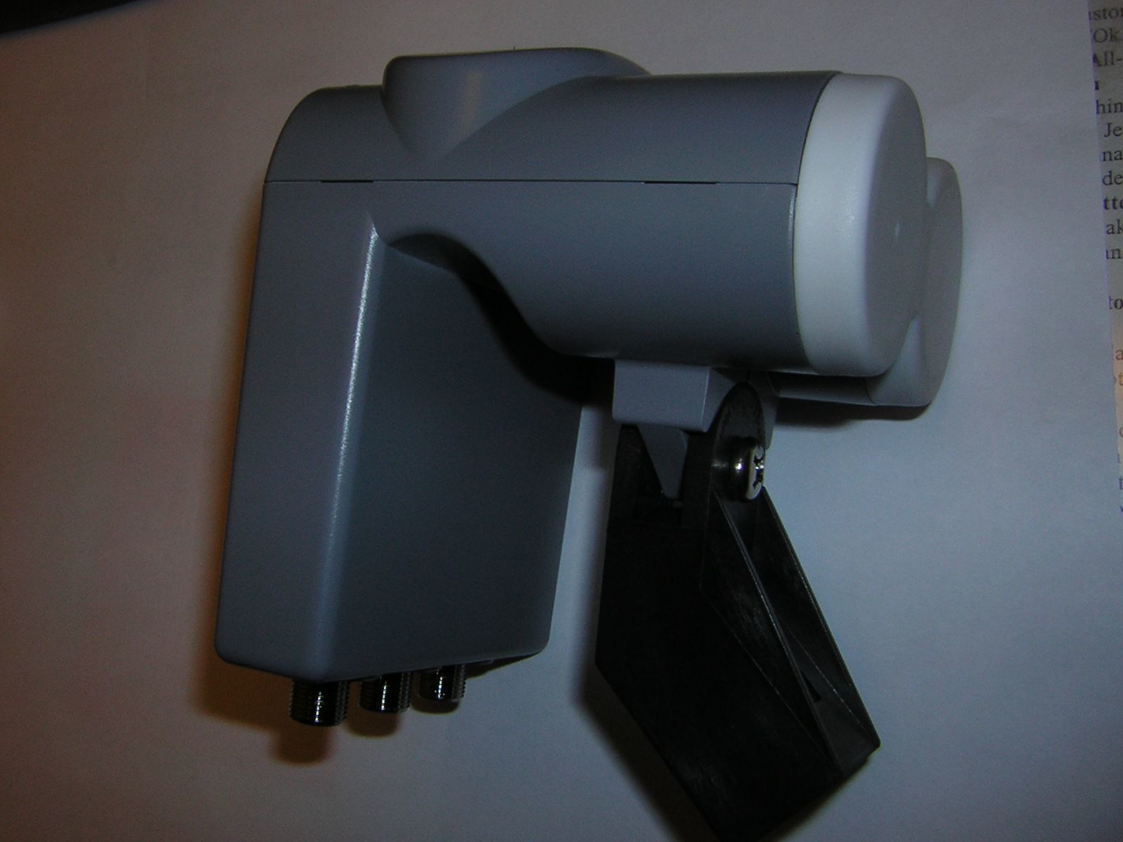

SatelliteAV SatelliteGuys Master Lifetime Supporter Sep 3, 2004 6,486 186 Roseville, CA May 29, 2009 #24 Cadsulfide said: Manualpaz; Way cool setup! Brian; The 4 degree monoblock lnb never got developed I take it? Click to expand... The monoblock was tooled but never ordered. Have attached a few photos of the production model that was never produced. The unique feature that we were introducing was an internal 4x1 switch to allow connection of additional LNBFs. Attachments 4DegTwin.jpg 11.9 KB · Views: 159 DSCN1181.JPG 128 KB · Views: 138
Cadsulfide SatelliteGuys Pro Sep 8, 2008 1,305 0 Cavalier, North Dakota May 29, 2009 #25 It looks like a cool product, I like the cascadable abilities.
