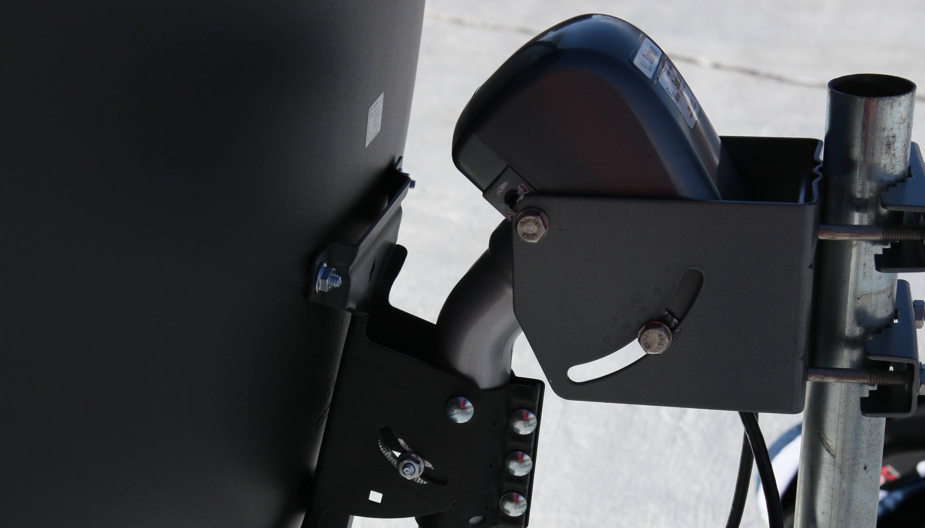

Hi there - first of all I just want to say I'm a big fan of SatelliteAV and GEOSATpro. I'm new to this hobby and pretty amazed by the excellent support of your products and the frequent microHD firmware updates. I love the 90cm dish and microHD I bought and am looking forward to purchasing the new GEOSATpro receiver when it's released.
In regards to the the dish assembly diagram and the DG 380 manual. We were actually a bit uncertain about assembling to the A configuration. If I recall correctly (it's been a couple of weeks), the A on the mast clamp ended up being upside down in order for it to fit into the elevation bracket. Everything went together fine though with the long bolt running through the hole in the motor arm as it should.
Also, the manual that came with the motor looked to be for the DG 380. We used the table in the printed manual. I bought the motor from Sadoun Satellite Sales and one thing I noticed is the PDF downloads with the title SADOUN_DG240... Both the printed and downloadable manual say 35 degrees minus declination.
At my location 40 degrees north the motor elevation bracket was set to 50 degrees with the adjacent cells showing 35 minus 6.3 declination equaling a dish bracket angle of 28.7. The motor's elevation bracket was left at 50 degrees per the manual.
Anyhow, we figured it out. Everything works great and I'm a happy camper exploring FTA satellite TV!
Here's a picture of the elevation brackets taken shortly after the install if it's helpful.
Thank you for the kind words! We simply try to provide the best customer support possible. Period!
Thank you for the photo. I can tell that you assembled it correctly. Glad that you were successful in installing the motorized system.
Now it is time to enjoy your new toys!
