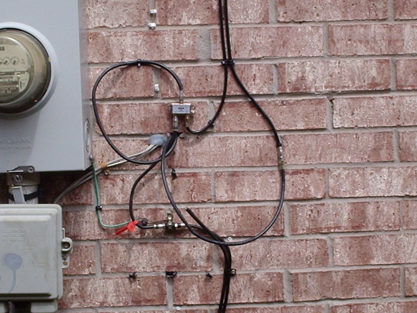

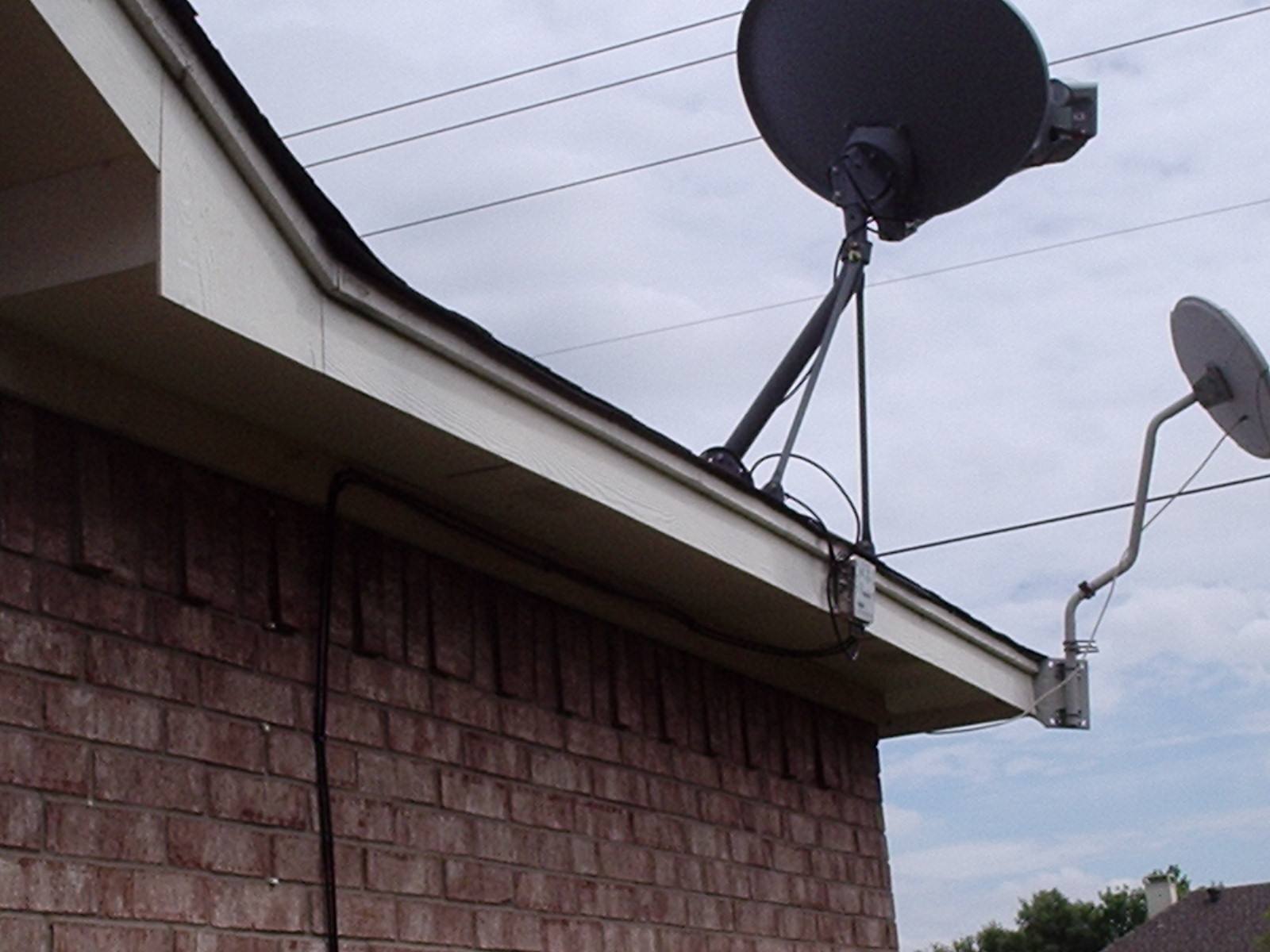

Here is a crappy installation done by a so call dealer.

DAMN!!
Now reckon, I didn't do the best install jobs on my 5 dishes, but they are a heckuva lot better than that...you cant see most of the cabling :)

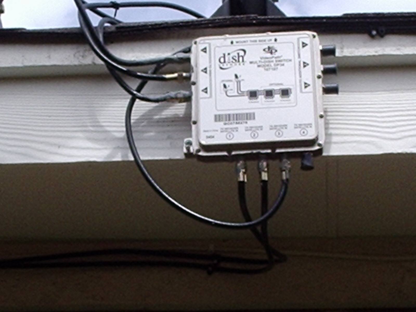

The switch should not even be on the dish. You are just asking for failure from bad weather. I always installed them on the inside of the home or on the outside of the house under an eve. There is a reason DISH didn't put a nice place to put the switch on the dish! PEOPLE are zip tieing them for god sakes!

Look by pass the grounding point, how much time needed to do the grounding ?? It is just his hobby or just trying to save a few cent. Look at the connectors, all indoor quality.
