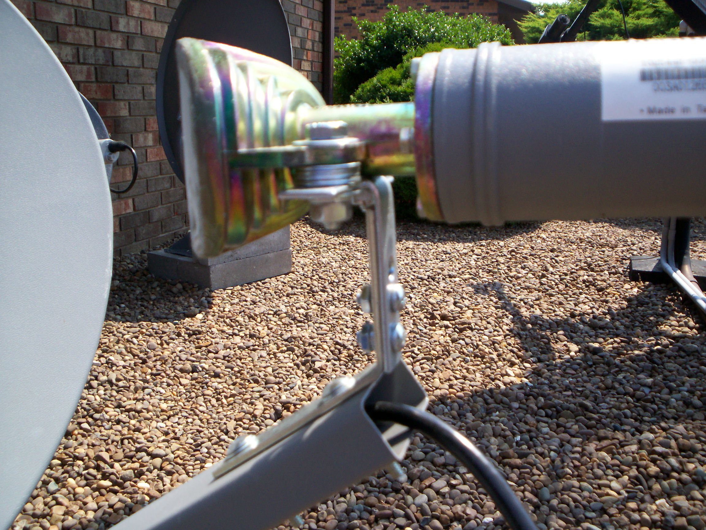

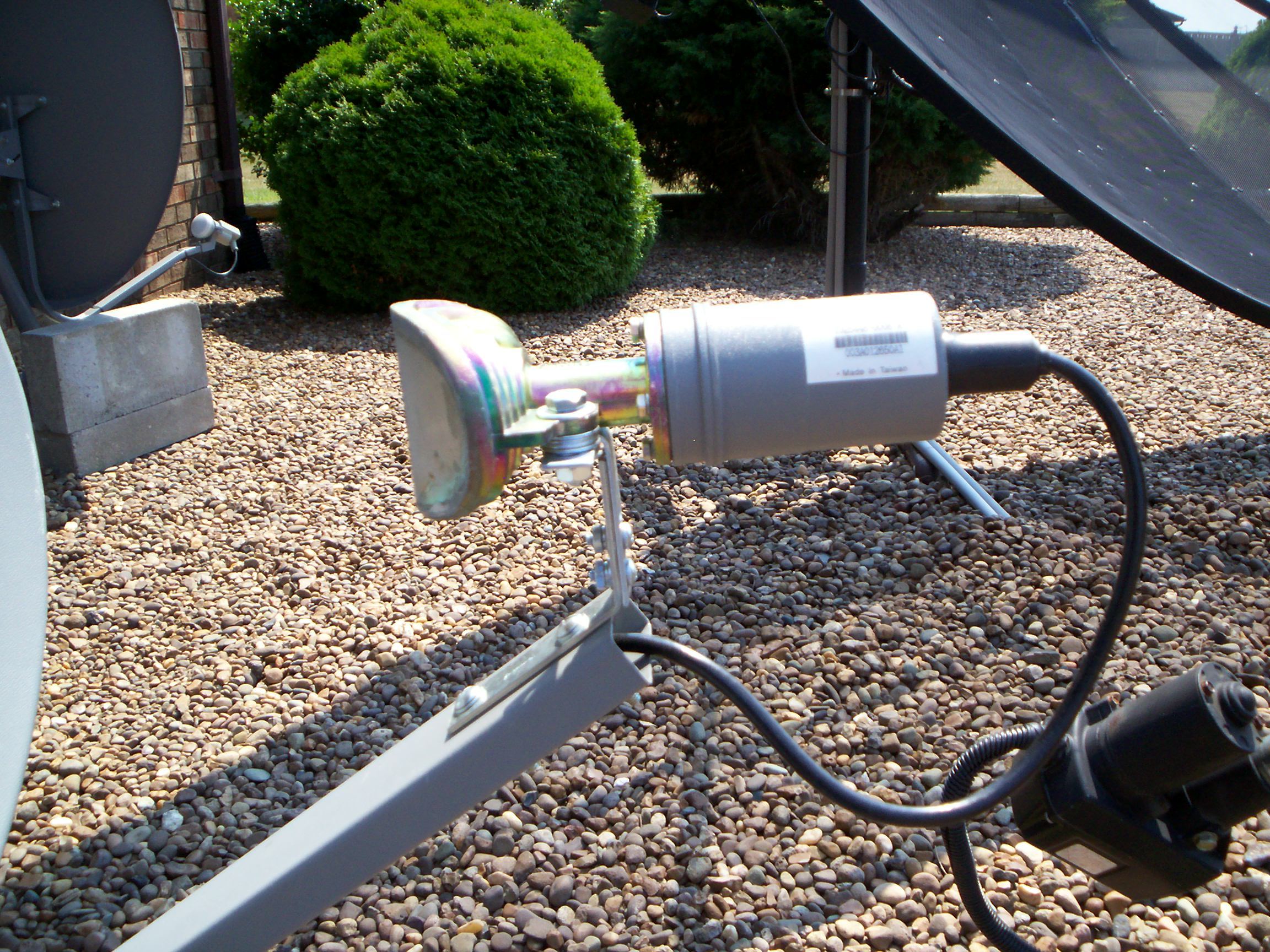

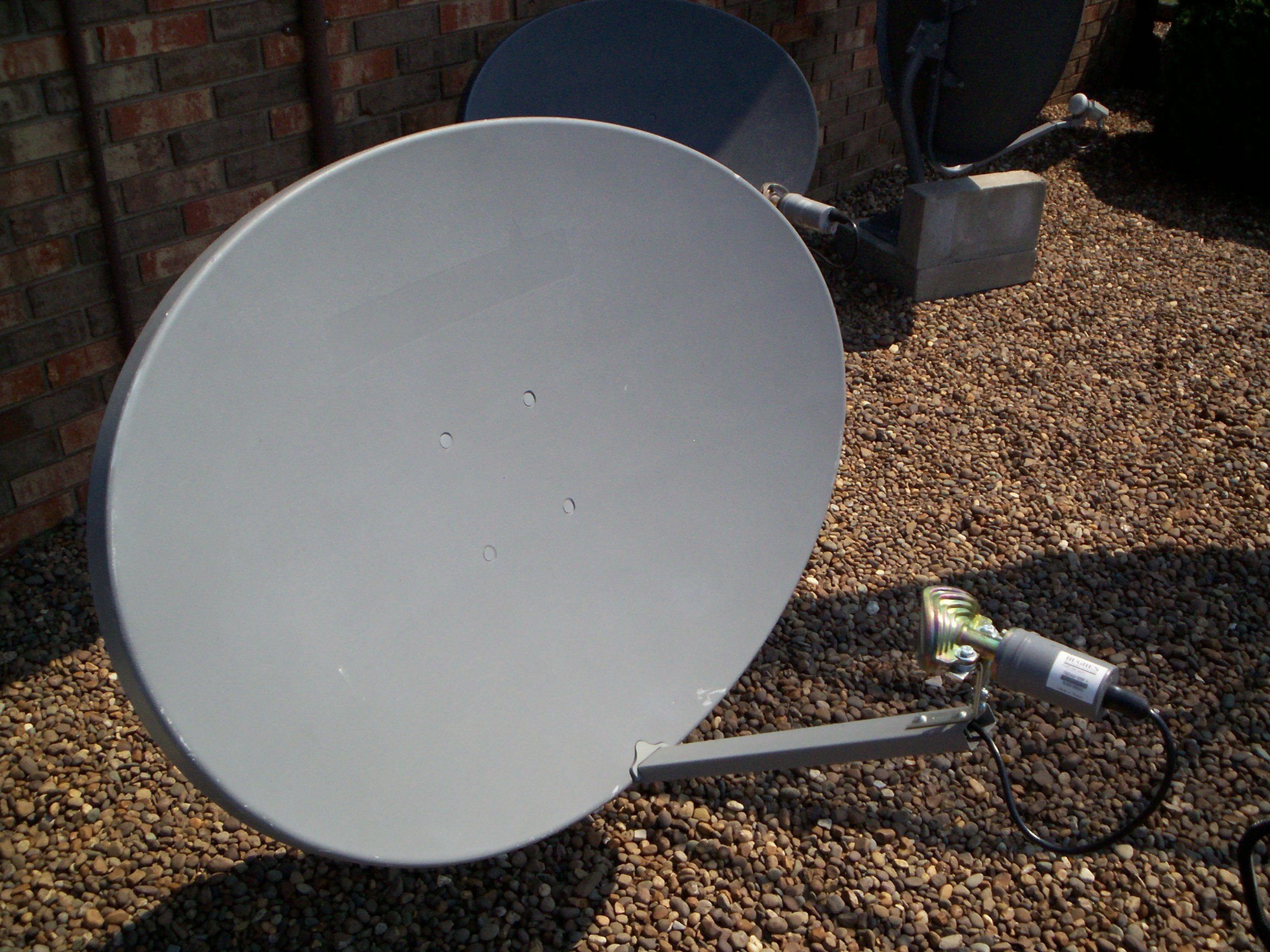

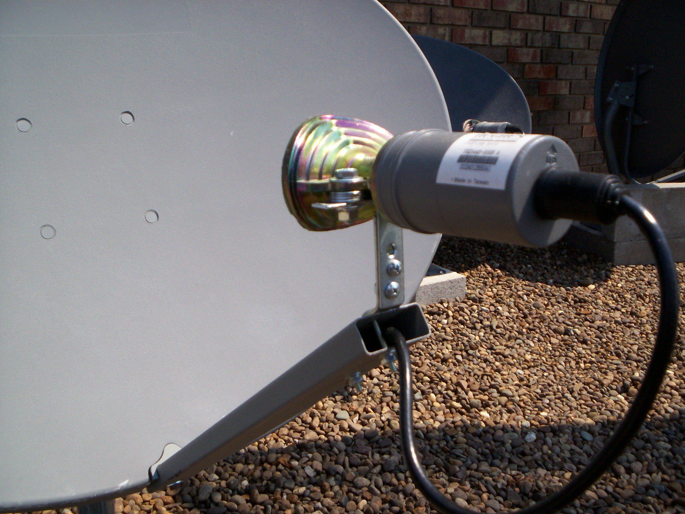

Thought I'd share another LNBF bracket I made recently.
Just acquired another Channelmaster dish in pretty good shape, except the (weak) plastic dual lnb bracket broke off. So I had to fabricate a new one. I only needed a single lnb on this dish anyway so I wanted to center it on the arm also.
Only took a straight "mending plate" which I bent at the correct angle (copying off the old plastic one)
and a "T" bracket, some bolts and some washers to raise the feedhorn to clear the throat.
It has a little play in the holes so I can fine tune the positioning of the height and the focal distance.
Seems to work great, using it for 87w and getting real strong quality. So now I have a dedicated dish for AMC3.
