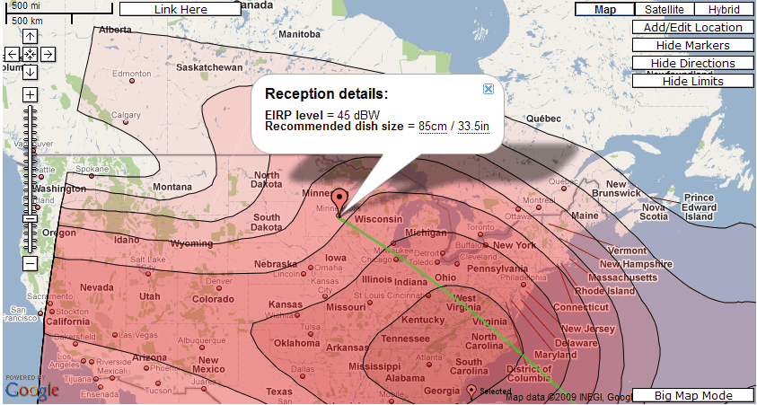

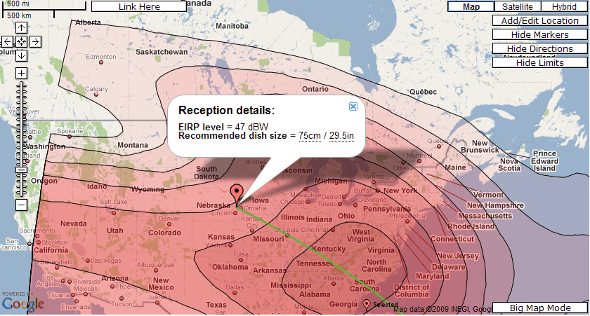

have never been able to get 43W on a 76cm here in MN.....guess dish is too small :(
Ice,
With the footprint images below, you can see how borderline we would be with a 76cm dish either near your location or mine.
A few years back, I had my DS-2076 dish set up with my Coolsat 5K and pulled in a Ku band feed channel from 43W that showed somewhere around 87-93% quality. I think that they must have been transmitting with very high power on that particular channel.
What I would really like to do now that I have a GEOSAT pro 1.2 M dish set up and dialed in quite well, would be to set up my 76 cm dish again, with an identical motor and LNBF and receiver and compare the results side by side.
This would provide some very useful information, I think. Personally, I believe that the Winegard DS-2076 dish design is a lot better that anyone gives it credit for. I think that many may scoff at its size when it is actually a pretty amazing antenna by design.
