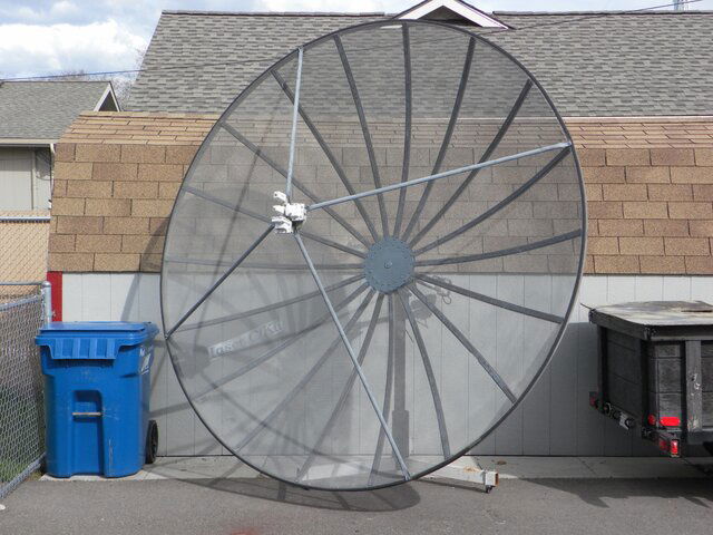

I've assembled and older 10' mesh dish. It's supposedly good with KU band as well as C-Band. Not having fun with Ku right now. I'm wondering if anyone is familiar with this dish? I'm looking for specifications like focal length and FD ratio. I'm not finding much info at all on the net. The company quit making these in 1987 and I don't think they sold very many.

I finally went and measured the dish. the parabolic shape is 115" in diameter and 18.5" deep. So..
115 x 115 = 13225
18.5 x 16 = 296
13225 ÷ 296 = 44.679 (focal length inches)
44.679 ÷ 115 = .388 (.39 F/D ratio)
Which makes the quad legs a little too long and I have to bring the scalar closer to the dish.
That made an improvement :)
Also moved the actuator to the east side as recommended by Satellite AV. The actuator now has no problem handling this dish from 50.0°W ~ 139.0°W
