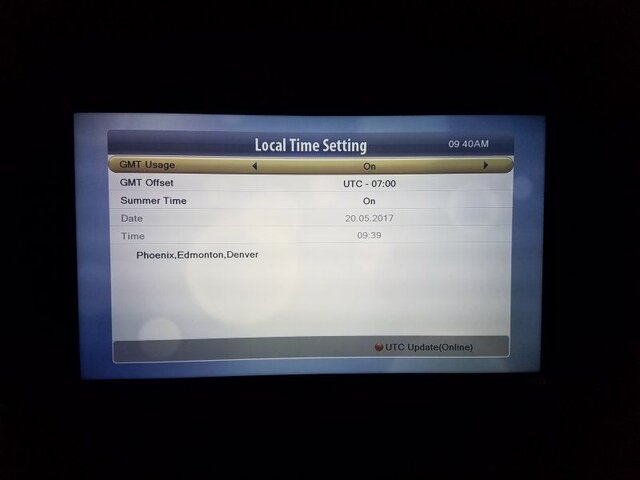

Don't have a 9000i in front of me, but here is what I recall.
Set Internet time: (receiver must be set-up to your router fixed or DHCP)
Menu/System/Local time setting
GMT Usage: On
GMT Offset: Your Time Zone (UTC time offset)
Summer Time: On or Off (Daylight Savings)
Press the red button to sync the time to IP. STB stays in sync in standby mode.
Did this. The time still changes.
Bummer! Worked on my test unit and I know it works for others. Don't have one to compare right now. Maybe someone else could help trouble shoot. Latest firmware installed?

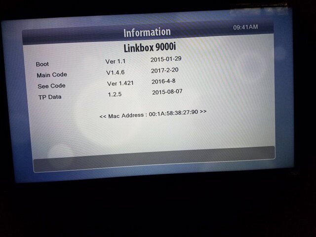

That's another thing I was wondering. Hypermegasat says that they loaded the latest firmware before shipping it but when I check with the "Update by Internet" the screen is saying that version 1.4.0 is newer than 1.4.6.

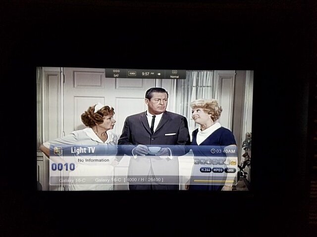

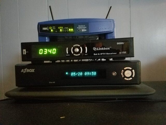

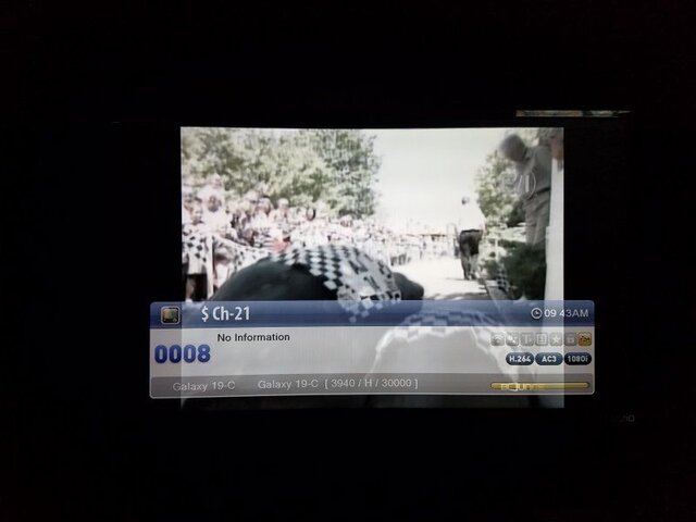

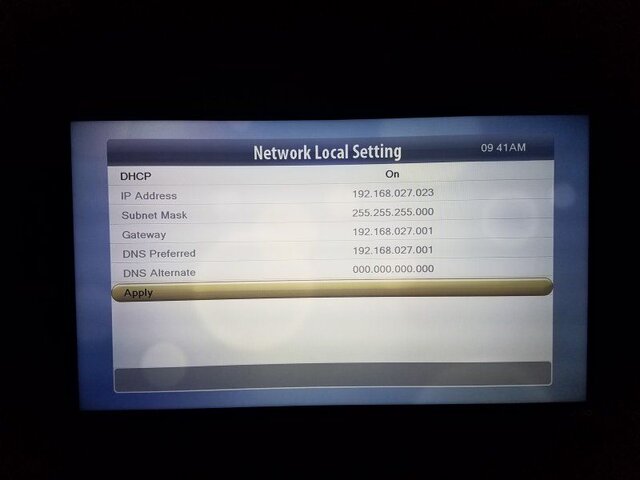

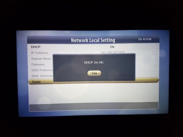

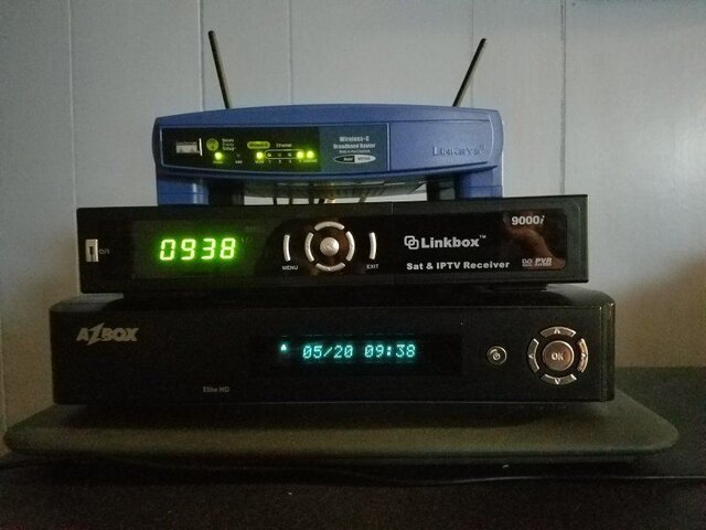

Here's some screen shots illustrating my time issues.
1. Current time - note that the Linkbox 9000i and Azbox Elite shows the correct time
2. 9000i time settings
3a. 9000i network settings
3b. 9000i network settings
4. G19 display info - note that the time is correct
5. G16 display info - note that the time is INcorrect
6. Elite and 9000i times are different (Elite display shows the correct time)
7. System info
20170520_093902.jpg 20170520_094040.jpg 20170520_094132.jpg 20170520_094140.jpg 20170520_094356.jpg 20170520_095741.jpg 20170520_095814.jpg 20170520_094216.jpg
If you did what Brian said above your time should be correct. The time problem you are describing was fixed with firmware version 1.1.9 back in January of 2016.
Only thing I can think of and I am no expert here on this, but do you have your router locked down heavily?
Go in your router or receiver and see what IP is being assigned to your 9000 and then go under DMZ in your router and put that address in, and save.
This will ensure all ports are open to the receiver and and the internet, just as if no router were present. I don't know what port or ports they are using to connect to the time server.
Yes, this opens the receiver to the world, but I don't think you are worried about someone hacking your receiver. :)
Why would I do that? The 9000i is a client requesting a time update from a NTP server somewhere on the internet - not the other way around. I tried the DMZ "thing", anyway, even though it made no sense from a networking perspective - as expected, it didn't fix the issue. I've attached the results of a TCP scan on the 9000i - only 1 port shows open with or without DMZ. I tried to do a UDP scan but it was taking forever.
