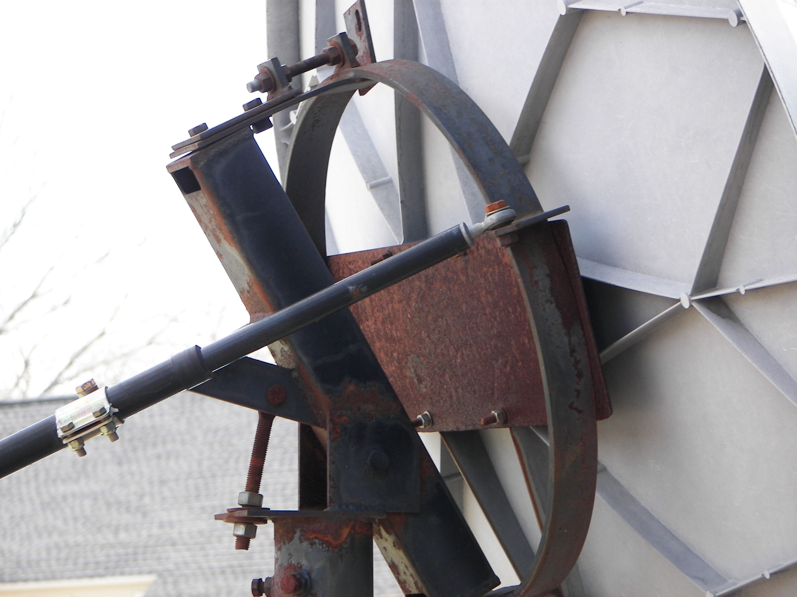

The only one I can guarantee will work and handle the weight and wind load for a composite 1.2m dish, is a polar mount with a linear actuator. It's not that hard to adapt an off-set dish to one. It basically consists of using some angle-iron the TILT the top of the dish down by the offset degrees. It'll look a little goofy to an average guy, but works well. A polar mount from an old 6 foot prime focus dish is perfect for this.
Find one, it's your best bet.
Reactions: danristheman
The only one I can guarantee will work and handle the weight and wind load for a composite 1.2m dish, is a polar mount with a linear actuator. It's not that hard to adapt an off-set dish to one. It basically consists of using some angle-iron to TILT the top of the dish down by the offset degrees. It'll look a little goofy to an average guy, but works well. A polar mount from an old 6 foot prime focus dish is perfect for this.
You want the dish so it looks like it points more towards the Horizon.
In other words, do not just bolt a polar mount flat to the back of an offset dish, because that won't allow it to actually point at satellites since the offset would have it looking 22~ degrees (whatever its offset angle is) or more "above" the satellite arc.

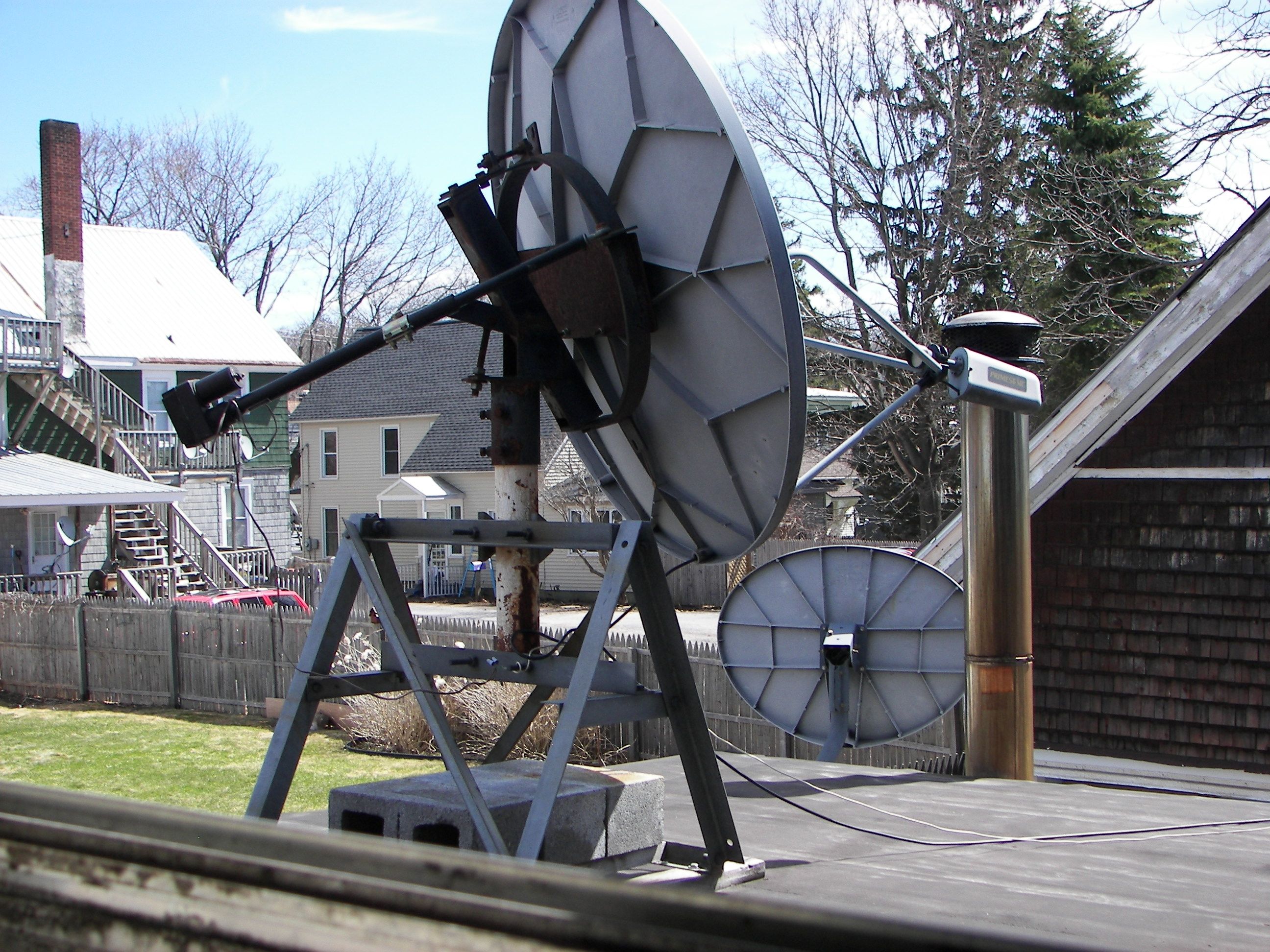

I sympathize with Lone Gunman and iBoston as a consumer of FTA equipment. There are good reliable vendors like Hypermegasat and Titanium. Never had a problem with Sadoun, and did order from Skyvision a few times with no problems. But when you have venture beyond those familiar names by necessity then a feeling of uneasiness sets in as to what product you are actually getting, is it truly made by the manufacturer they claim, has it been relabeled by the vendor or some middleman? With 1.2m offset dishes I found this to be the case, ended up confused and just decided to make one out of an existing dish, whether it works or not at least I know where it was made hi hi. And it can use my existing H-H motor. Hey I wanted to spend some money but the product was just not out there, or the folks selling the product (1.2m dish) didn't make it easy enough for the consumer to buy it.
1.2 Primestar on unknown polar,does 72w to about 105w(runs in to the stand).Originally put up for HITS channels when they were on 99w ku.Two weeks after I put it up Hits announced they were moving to "W5":mad:.
Also note 30w Pstar underneath.
