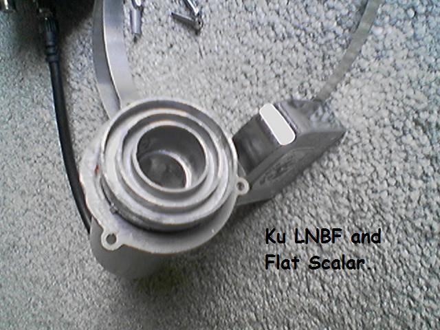

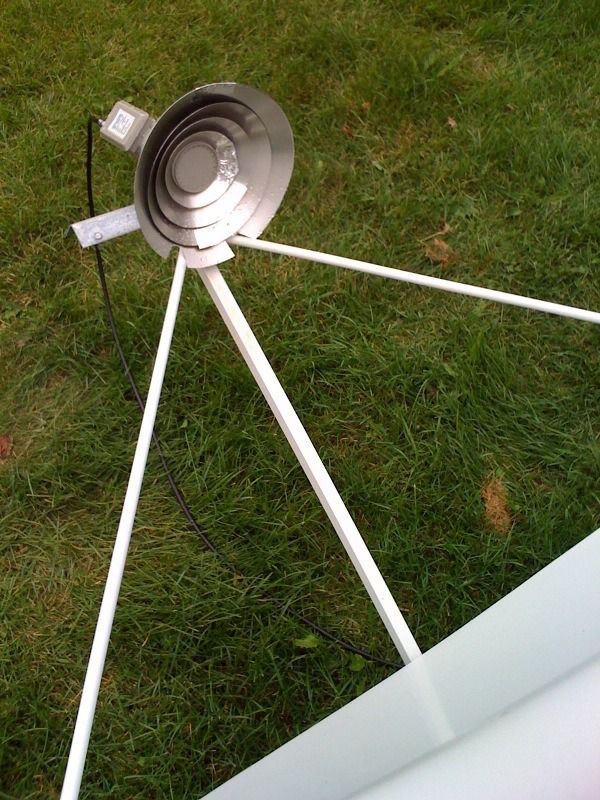

1.2M offset Flat Vs Stacked Cone Scalar

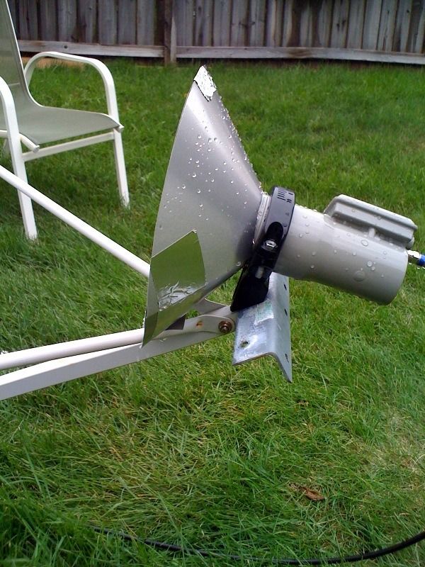

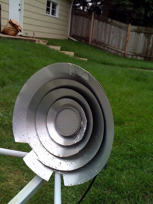

Here are some pics. I have since ordered the DMX-741u because I want to have C and Ku aligned at the same focal point. I plan to do the Ku conversion you showed me to get optimum Ku reception.
Stacked cone Scalar
Nice job on construction of the Scalar.
I used the same aluminum flashing and cut a strip 1/2" by 11" and wound that around the Ku section at the Scalar. It works really good and on the DMX741 puts the Ku/C at same focal distance. I'm very happy yet today with the Ku/C performance and hope you have the same success.
I just finished testing the BSC621 with the 1/2" spacer and find that it should be 5/8" on this LNBF for optimum f/d match. But the BSC621 just can't perform as well as the DMX741 on a small dish. For a bud it makes little diff.

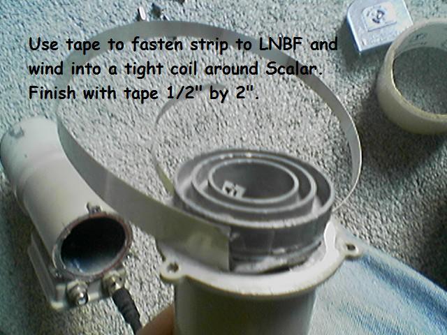

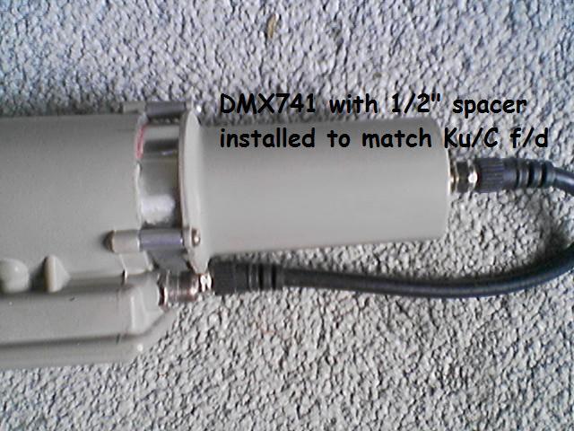

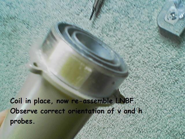

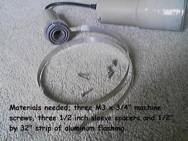

Here are pics with mod details to work from. I don't recall but the screws are either M2 or M3 by 3/4".
He gets credit for this improvement, I just confirmed his work on PF and Offset dishes.
