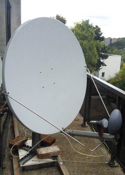

I hope, by now, this really is. I made drawing, bought material, friend of mine did TIG welding, I just put everything together and made more or less proper adjustments. Of course, it did cost some $, but, so what?

I need to show the pictures of this to my dad, I would like to try to make something like this. But I can't imagine it ever looking that nice.
If I can get one made it's gonna look a bit more hillbilly-tech than that one. I'm just amazed at how 'factory made" it looks.
Real first class, quality work there.
Thanks! I've got SUB from Philips 90cm Gregory-type dish, from time to time they appear on e-bay, second hand of course.

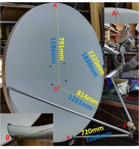

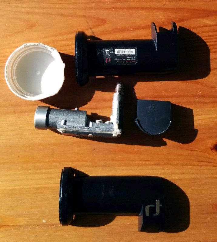

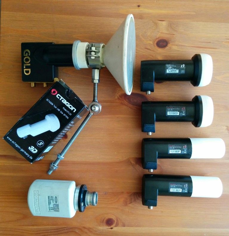

From the very beginning my goal was to get performance of offset antenna (in my case it was 1,8m Prodelin) better by making it work as a Gregory-type (with ellipsoidal sub-reflector). I've read that Gregory-type systems perform better than offset antennas as they use more effectively surface of main dish and also exclude X-pol. So, I got sub-reflector from factory made Gregory and made proper mechanical fittings. Of course, to make conclusions on which setup is working better we need to do some comparison-tests. For tests I took several LNBs:
- Inverto Black Ultra (white label, some people say that there is difference between performance of IBU with white and red label);
- IBU red label;
- IBU red label adopted by one company for antennas with 70* illumination angle;
- IBU red label 90* illumination;
- Gold LNB adopted to work with original Prodelin feedhorn;
- Invacom single attached to Gregory feedhorn;
- Octagon twin attached to Gregory feedhorn;
- IBU red attached to Gregory feedhorn;
I measured signal levels on all available in my area frequencies from Eutelsat @ 28,2*E (could be any) and put data in spreadsheet. I've got 58 transponders. Then I calculated average signal level.
So, after all this I can say that Gregory systems performing better than usual offset dish. And, secondly, by attaching sub-reflector to offset antenna is possible to get better performance of system. It is like you change 1,8m antenna to 2 meter.

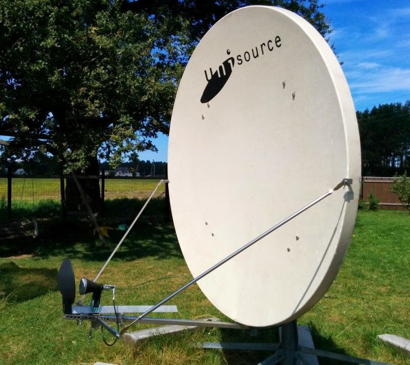

- IBU red label;

Firstly, I agree, Gregory type dish looks sexy!
I was really hoping to make subreflector but it turned not so easy task. On e of the options was to print it on 3D printer in metal. I even found one company which could do that, but price was cosmic! So, I've abandoned this idea. Easiest and cheapest was to find one of Gregory type dishes (they still available this side of the pond. Of course used and not very cheap even on second hand market), remove the sub from it and use on any bigger dish, for example on 1.2m Channel Master dish IMG_20150818_185103 (Large).jpg and it worked great. I bought several to have enough "meat" for experiments. Today I have installed 4 Gregory type dishes (1 PFA and 3 offsets). There is also one offset Cassegrain type dish (very rare, only one model made, not in the production anymore).
